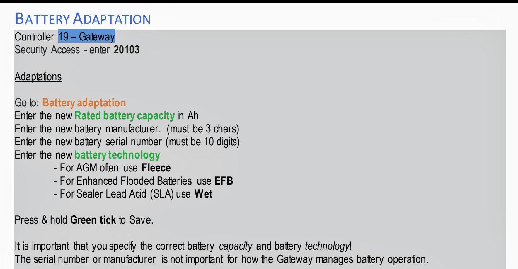

Varta come recommended on here often.  Don't forget to recode it.  A single digit change in serial number is enough.  All it does is tell the car there is a new battery and to charge it appropriately.  Some have reported the car killing a new battery if not recoded.  Not all though but not worth taking the risk IMO.
Varta A7 if AGM, as well as changing the BEM code you’ll need to change from 68ah to 70ah or whatever the new one is

It is an auto but I’ve had the same rear brakes for some time.  Changing the BEM code - I guess I’ll need some accessories to do that?
Yes, u'll need VCDS or OBDEleven.
