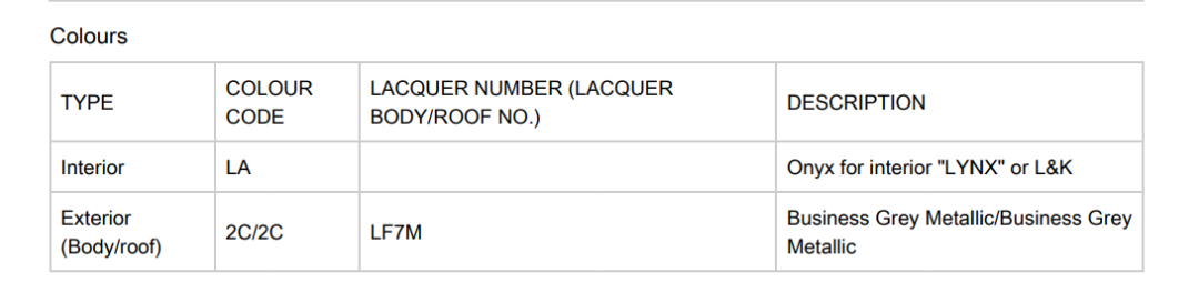

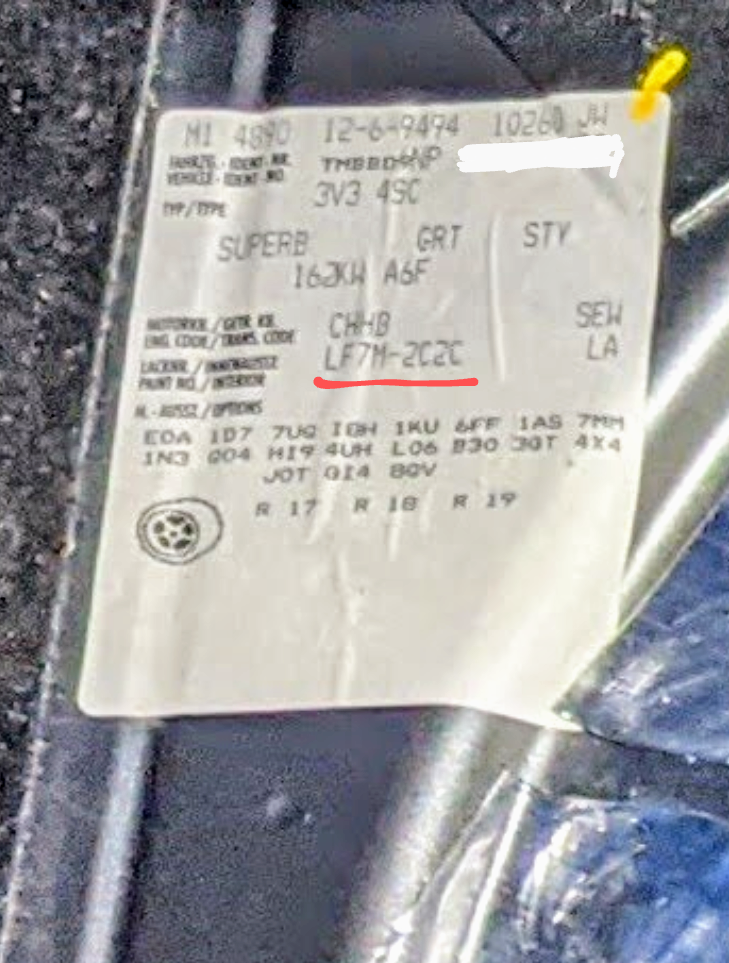

Paint code is made up of two parts:- Colour Code + Lacquer Number.
The colour code (exterior) has two parts in itself - body/roof.
In my case, Business Grey, is LF7M 2C2C.
There is a sticker in the boot with the paint details.
Alternatively, a report from eRwin will show u this too, based on ur VIN.
Boot sticker....
From Skoda eRwin....
