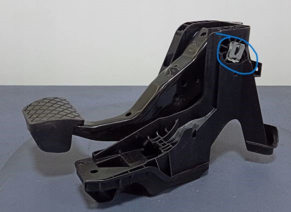

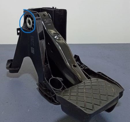

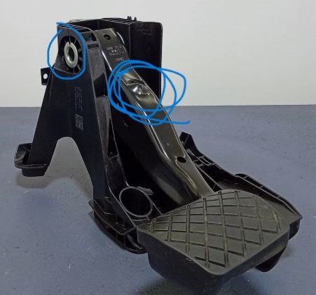

My brake pedal also made some noises.. I have sprayed some lube on this spots and its way better now 1.JPG2.JPG
You can also check if the pedal clonks back at this spot..
