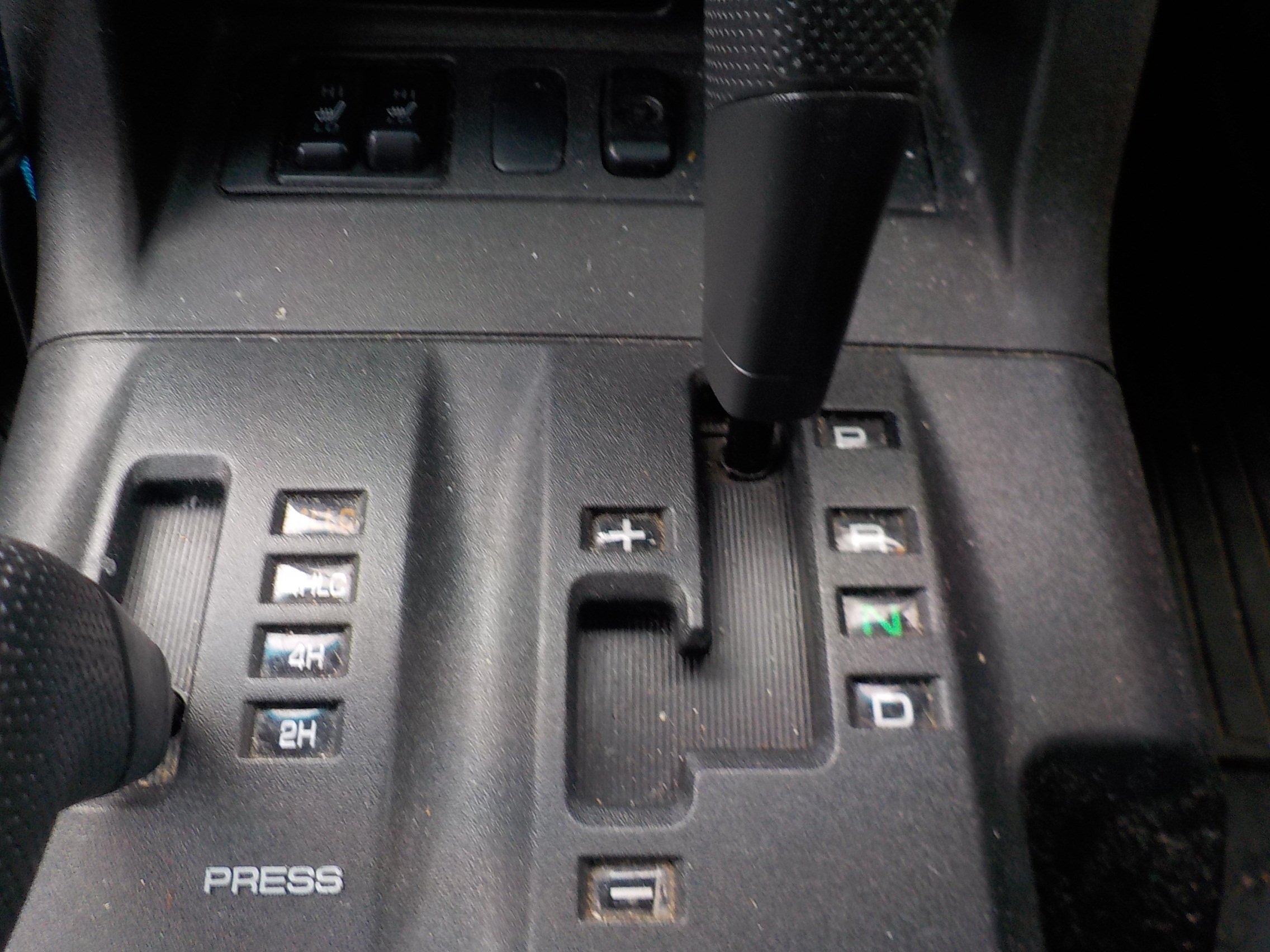

My Shogun Auto Box. This one did not have Locking Diffs,

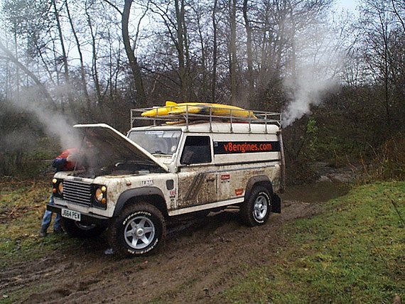

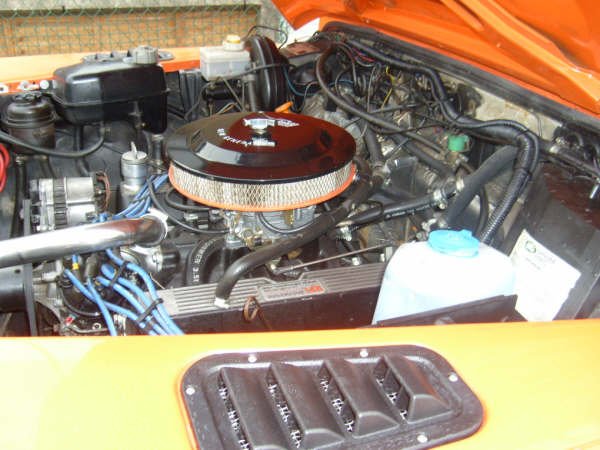

@Alasdair1 4.6 V8 Auto running on LPG only as it was in my 110.
It had been RPI Engineering,s demonstrator.
http://v8engines.com
It was great when LPG was 50 pence a litre. 200 & a 90 litre tank.
