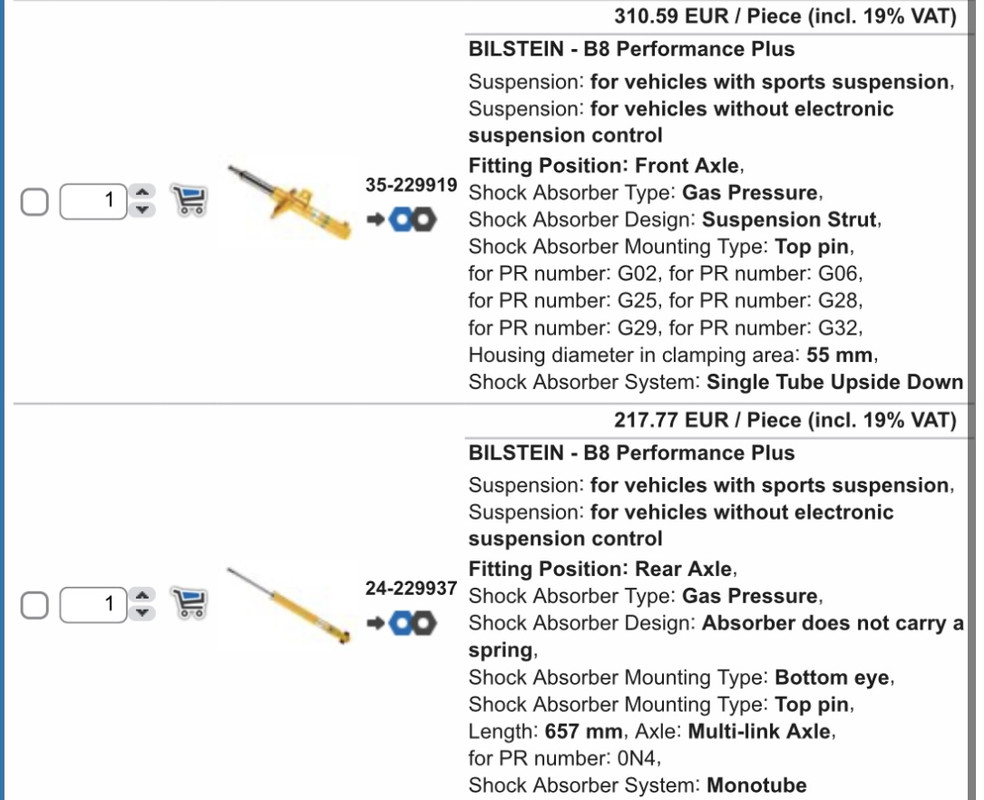

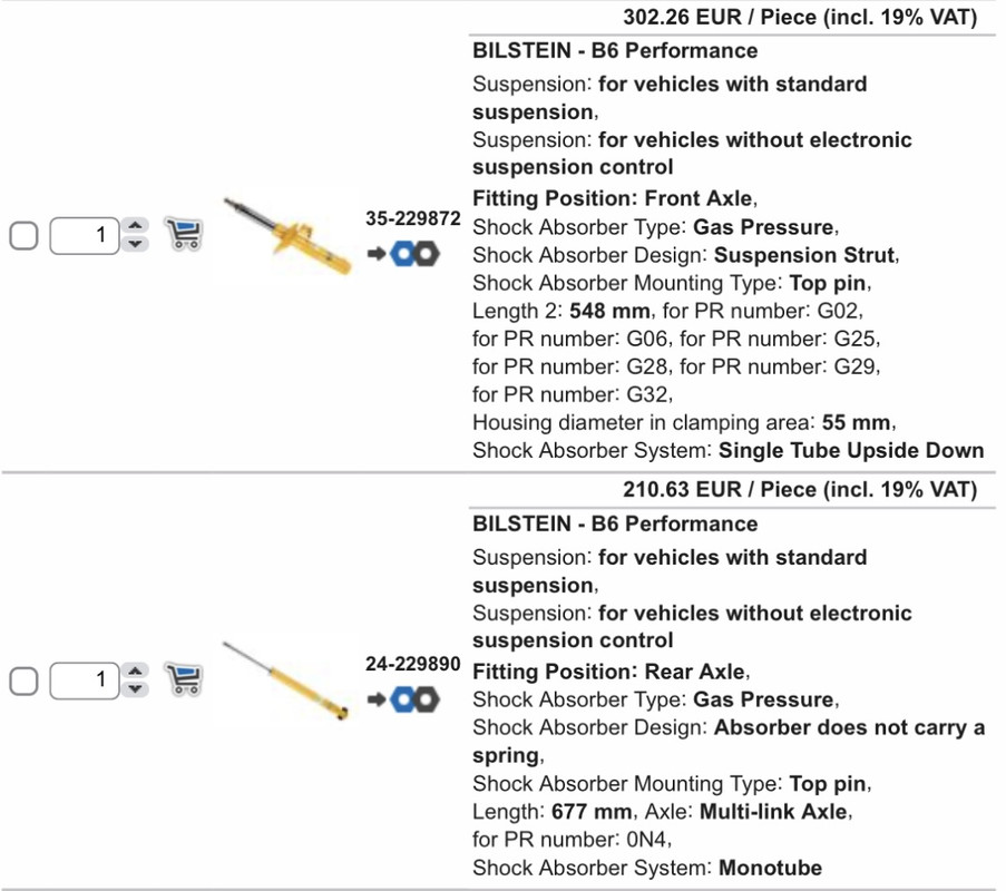

As far as i understand they are the same shock, just that b8 is 20mm shorter. On Bilstein website they say b6 is for oem suspension and b8 is for cars with lowering springs or oem sports suspension(which i have, but it is -15mm, while the b8 shock is 20mm shorter than b6 shock).
I found some website that had information about bilstein shocks for superb mk3 and b6 and b8 had same PR codes listed… My car has a G02 code on that little list under VIN in the service manual.

But shouldn’t the b8 be clearly better choice if paired with eibach pro kit, or any -20mm or more spring?
I ask because as far as i understand the b8 is the exactly the same shock as the b6, just with 20mm shorter “rod”.
If we asume that b6 has the lenght that matches the suspension travel of the stock spring, doesnt that mean that if we fit for example 30mm shorter spring the b6 shock has 30mm shorter travel than before, because the rod will hit internal bump stop earlier.
If we fit b8 with the same spring 30mm shorter than stock-it has 20mm more room before hitting the internal bump stop, am i right?
That is why I am confused should i go with b6 or b8 with stock -15mm spring, because i dont know if those 5 milimeters less in damper lenght can cause wear or damage to the damper, but on compression it should be better because it has more travel, doesn’t it?

I went with bilstein b8 dampers(numbers are in the picture attached to the first post in this thread), did all the “boring stuff” by chasis number (lemforder brand) and I changed out the bushings for audi tts(or s3, I am not sure) but the “almost full rubber” kind, I found part no. here on briskoda. It is 8SO 407 183 B or 5QO 407 183 F, I really am not sure as i sent both to my mechanic who sourced the one which was available, but going by the google pics I think its the latter.
