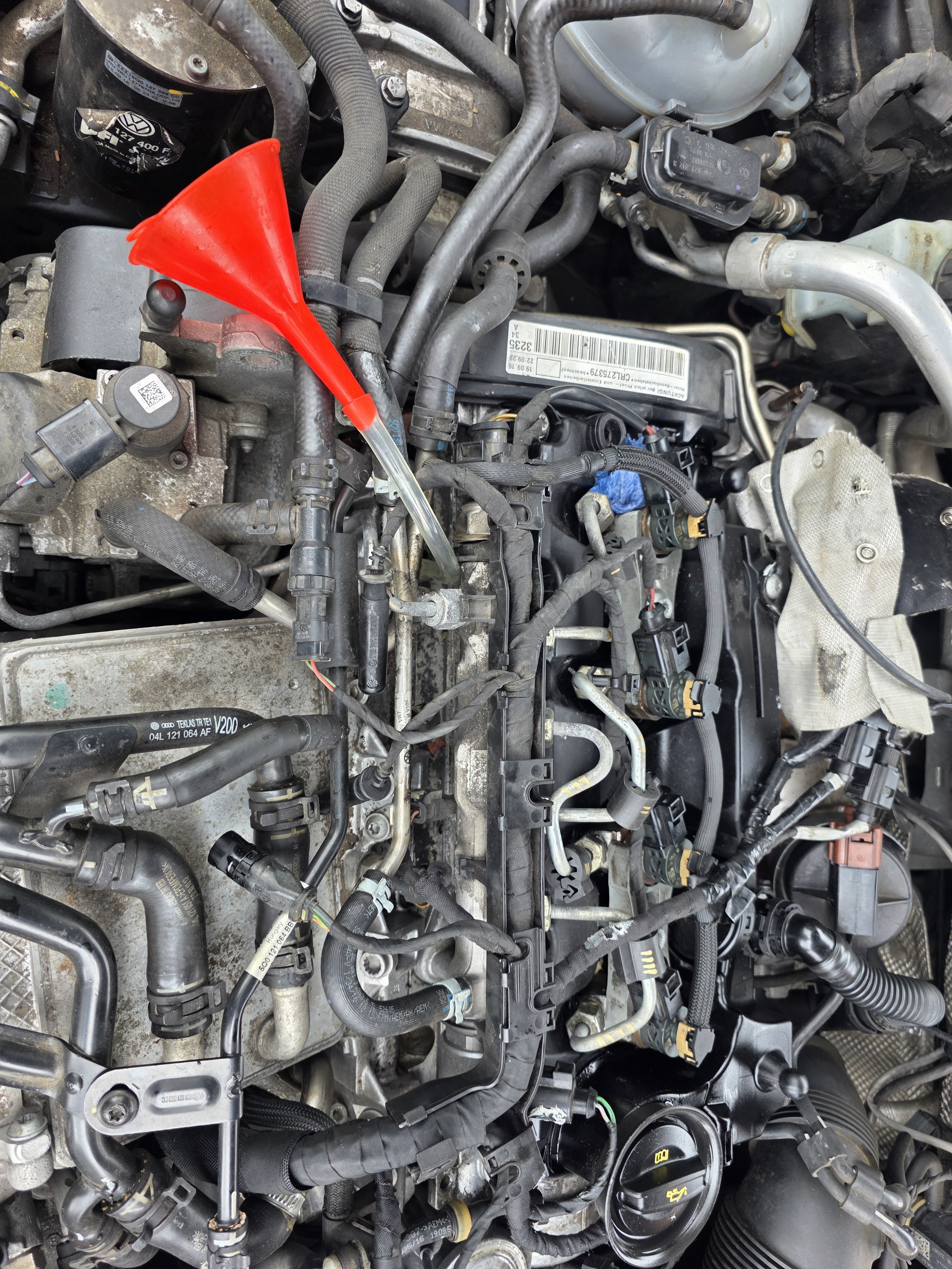

Quick update.
Managed to take glow plug 1,2 and 4 off without any issue.
Glow plug 3 however is just spinning round and round. Im guessing its snapped. I was very careful and spray lots of wd40.
Im going to pour the b12 in the 3 plug holes.
Let it do its job and hope that glow plug 3 doesn't cause a major issue once its all back together again.
30 minutes ago, gidi19 said:
Quick update.
Ignore above.
Glow plug 3 has come out successfully.
I was just being overly cautious. It needed turning alot more then the other glow plugs. I also kinda had to pull it towards me to get the threads to grip.
Just for anyone who wants to attempt it in the future. Here's a pic of joining got the b12 into the chamber.
I got a smaLloyds funnel and attached some clear plastic tubing at the end.
One thing to note,the area around the glow plugs was filthy. I should have sucked it all out but didn't.
Im going to try suck it all put somehow after the piston soaking
