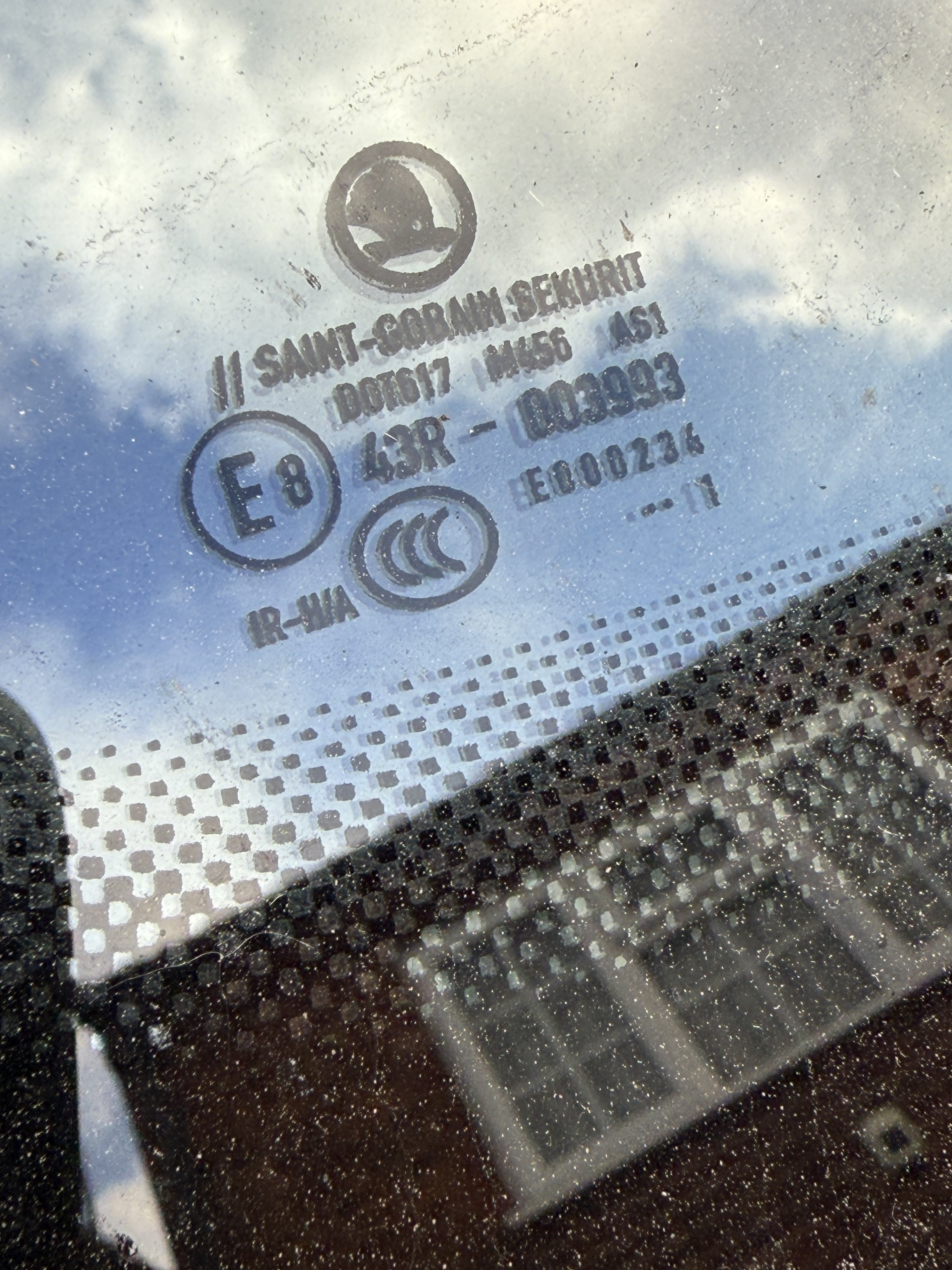

FWIW looking at my windscreen on the driver's side there is a label saying FUYAO with a part number of DOT459M148AS1.
Could someone else with a similar spec car (MY2020 2.0TDI L&K) have a look and see what it says on a factory spec car?

Fairly certain that’s a non genuine part, you should see the Skoda logo stamp if it’s genuine
I thought as much, makes sense as the glass is immaculate which I wouldn't expect on a car with 67K miles and a load of stone chips on the bonnet.

as i mentioned earlier - Part No. for the genuine Skoda heated windscreen is 3V0845011AE NVB
This is my 2022 Heated L&K Screen stamp........I think the 'A61' is the heated code......
Edited by Berisford
Thanks, looks like mines been replaced at some point.
