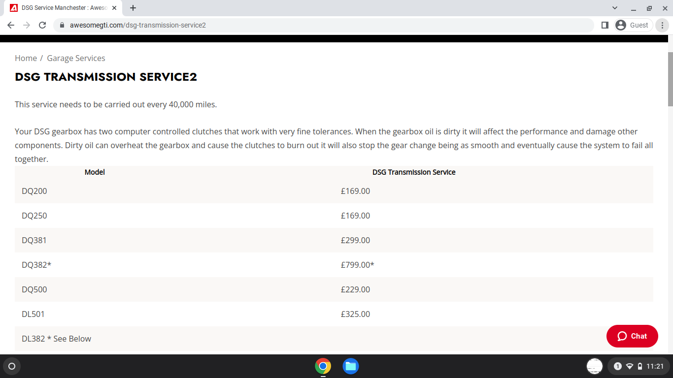

The average price I've seen is about £220. A tiny sum when compared to all the other running costs.
@Aldfort Where have you seen The Average price for servicing a DQ200?
There are prices often given here for a DQ250 or DQ381, one oil and a filter.
Not £220 for a few years now unless a nice cheap independent. Thing £300 + now for a DQ381.
As it is 4 years never was a Service Interval for DSG,s, 40,000 miles (38,000 Audi) or 80,000 miles DQ381 as given in the UK.
DQ200 DSG,s as an when anyone wants, done by someone that does it right.
If that is for £220 then 'What is the worst that can happen'.
Maybe best spend that on an extended warranty covering the DSG though.

A great price at Awesome.
