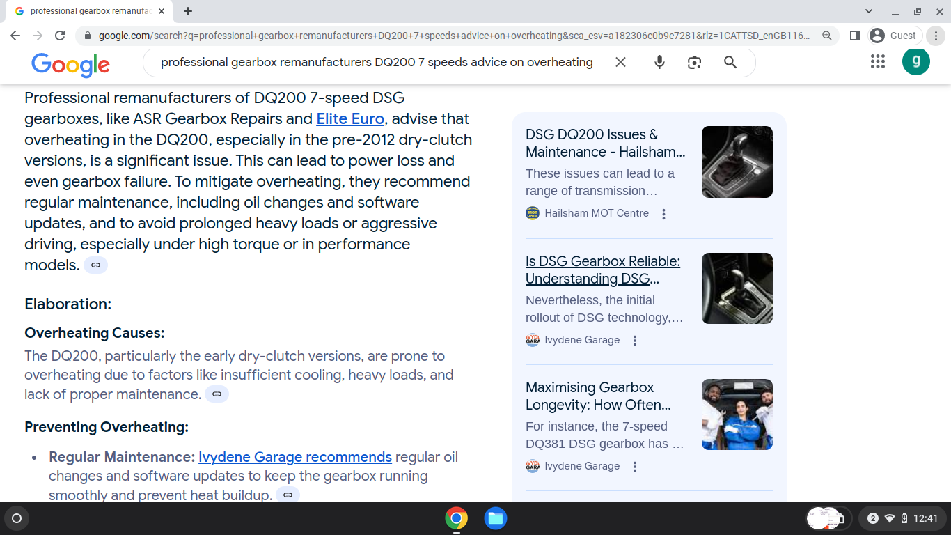

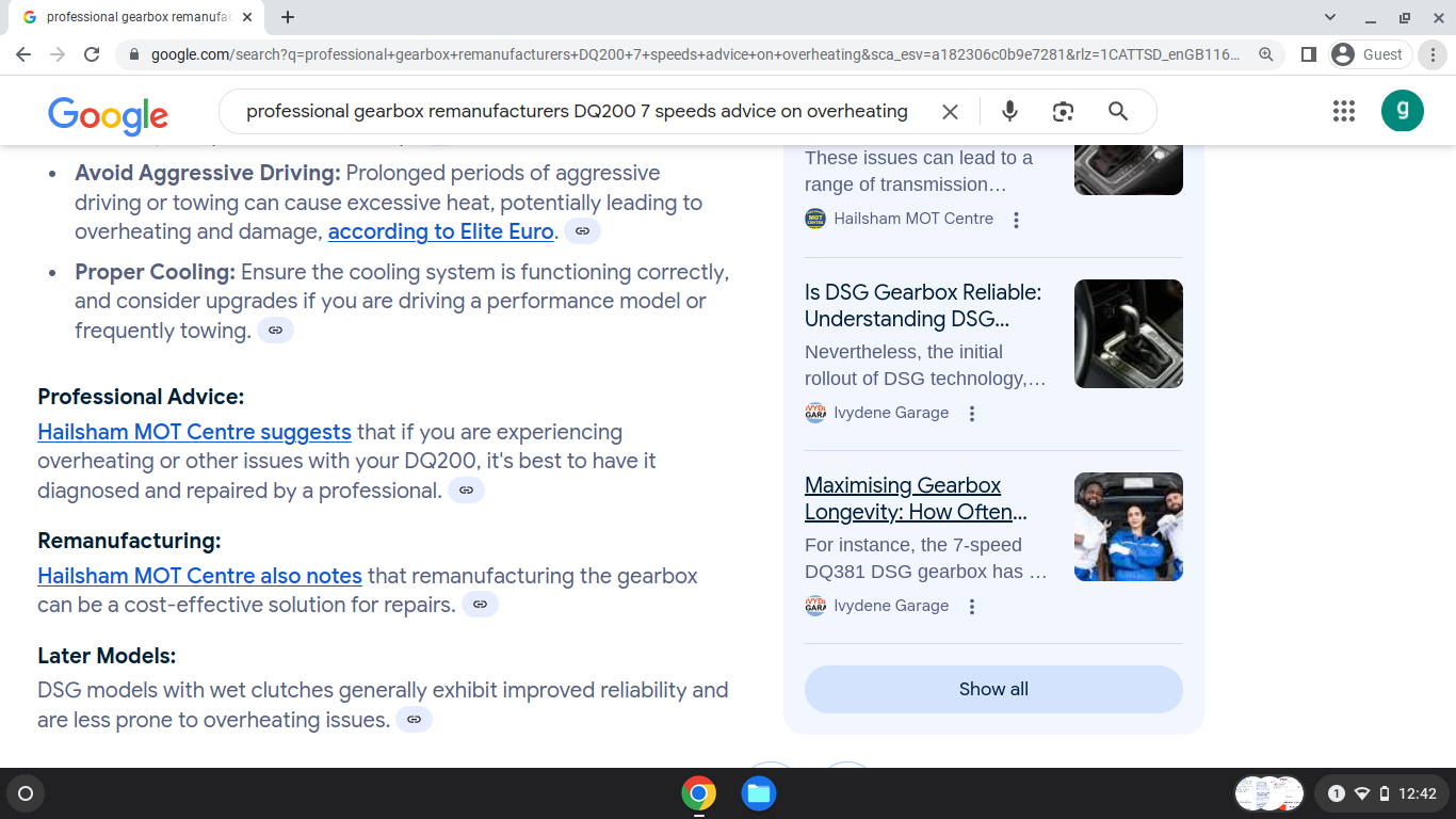

Just so we care clear, most professional gearbox re-manufacturers recommend the following for 7 speed DQ200 transmissions.
"Stop-and-Go Traffic: The DSG7 dry clutch system is particularly susceptible to overheating in frequent stop-and-go traffic. Prolonged use in these conditions can lead to premature wear of the clutch packs. Avoid heavy traffic or allow the gearbox to cool during long stops by shifting into neutral to mitigate this."

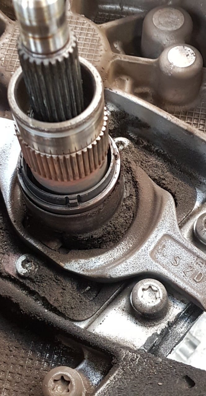

What there is is lots of mess beside the clutches.
As to oil colour there are various posts on here showing the colour changes.
