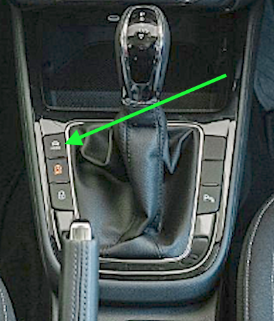

That car does have a MODE button and its use is described in the review.
(It's stating the obvious, but, if a Fabia does not have a MODE button, then there will be no means to select different driving modes as suggested in the Owner's Manual.)

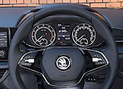

The Fabia's Virtual Cockpit is described here
The analogue instrument cluster (as fitted to my Fabia) has a pair of 'fixed' circular dials for rpm and speed, as shown here.
I can disable Lane Assist and obtain a central digital mph readout using the steering-wheel controls exactly as you do, but I cannot choose between different 'looks' for the instrument-cluster as is possible with the Viirtual Cockpit. (And I do not get "ECO" showing anywhere when my car is coasting.)
Having read and seen the images you sent, I would have to say that I do not have a virtual cockpit. The space between the two dials seems to be the digital element of the display, and that is where Eco pops up while I am in free-wheel mode. It looks like this is a topic for discussion when I get the car serviced in a couple of months time.

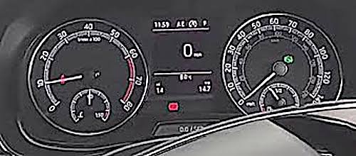

I was wrong about "Eco" not appearing on my Fabia's analogue instrument-cluster. When the car's transmission shifted to D a small insignificant symbol (ECO in a circle) appeared just above the "trip" distance figure in the bottom-right corner of the instrument-cluster's central section. And, when the car ceased coasting and D became D7 or D6, the symbol disappeared. As I've had no difficulty identifying when the car began to coast (D7/D6 changing to D and the rpm dropping to around 1000) I've never noticed the ECO symbol before.
I also have my Fabia's analogue instrument-cluster set to display a digital speed readout in its centre (as shown below) but that readout was not affected when the ECO-in-a -circle symbol appeared above the trip distance figure.
Over-riding the digital speed readout with "ECO" seems an odd thing to happen. Have you, perhaps, got the "Eco Tips" option enabled in your car's instrument-cluster settings?
I can see now that I have Analogue displays except for bit in the middle. Your experience this morning is exactly that which I experience.
As for realising that the car has gone Eco I know immediately by a"seat of the pants feeling" that it has happened. I was used to choosing to go in and out of Eco in my previous Golf Gti by activating a switch. The difference between Eco and non Eco is that the tight corner ahead approaches much faster in Eco than in normal mode. That could catch out the unwary.

When my Fabia is 'coasting' (D showing on instrument-cluster) this is the symbol that appears above the "trip" distance figure.
It simply indicates that the car is in fuel-saving mode and that its automatic transmission and motor are 'idling'.
Other than your car's central digital mph speed readout being replaced by "ECO" (which I wouldn't like either) I really don't see why you should be concerned about this feature. All the Fabia's DSG transmission does is to reduce fuel consumption by disconnecting the transmission from the motor and to lower the motor's rpm to a fast tick-over. Touching the brake or accelerator pedal while D is showing should instantly reconnect the transmission and motor and the motor's rpm will speed up. If you dislike the feature so much and are uninterested in your car's fuel consumption, just put the transmission selector-lever in its "S" position when you start to drive and it won't 'coast'.
