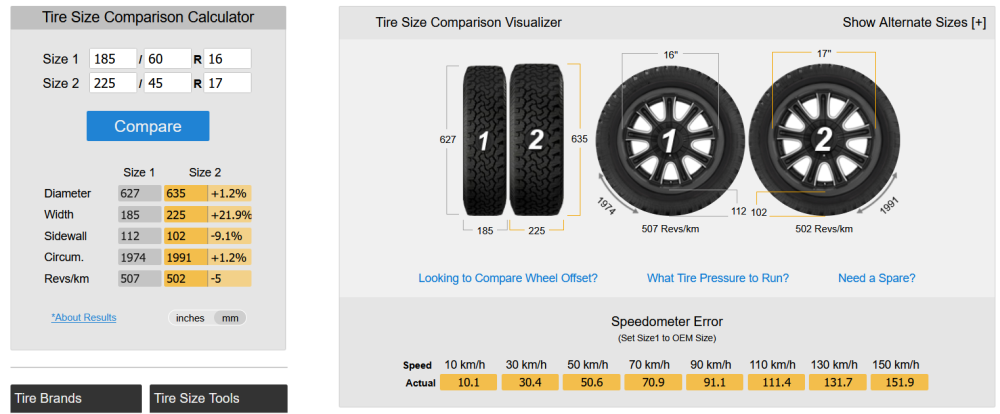

1) 225*0.45 = 101.25 wall height.
2) 185+0.60 = 111.0 wall height.
As you've omitted the speed rating of the 16" tyres I can't be certain if they're usable on your car, but they're certainly slightly under radius.

A tyre comparison website gives me:-
The alloys are VW branded, so I am assuming the wheel bolts will align.

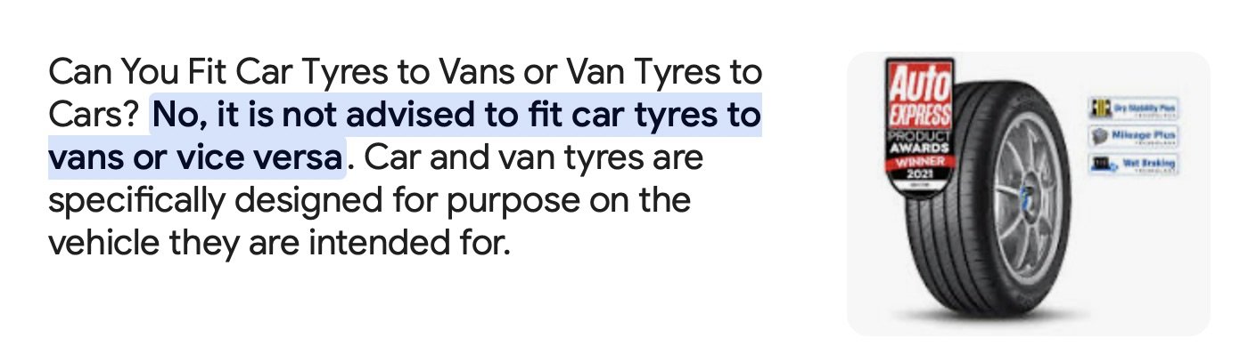

'commercial rated tyres' - are they van tyres?:

I can't see anything wrong with using commercial rated tyres on a car, with the caveat being you'd want to be under their (presumably low) speed rating.
FWIW, if you have 312mm brakes, then commercial 16" wheels might cause some issues with clearances if they are a weird shape/offset.
