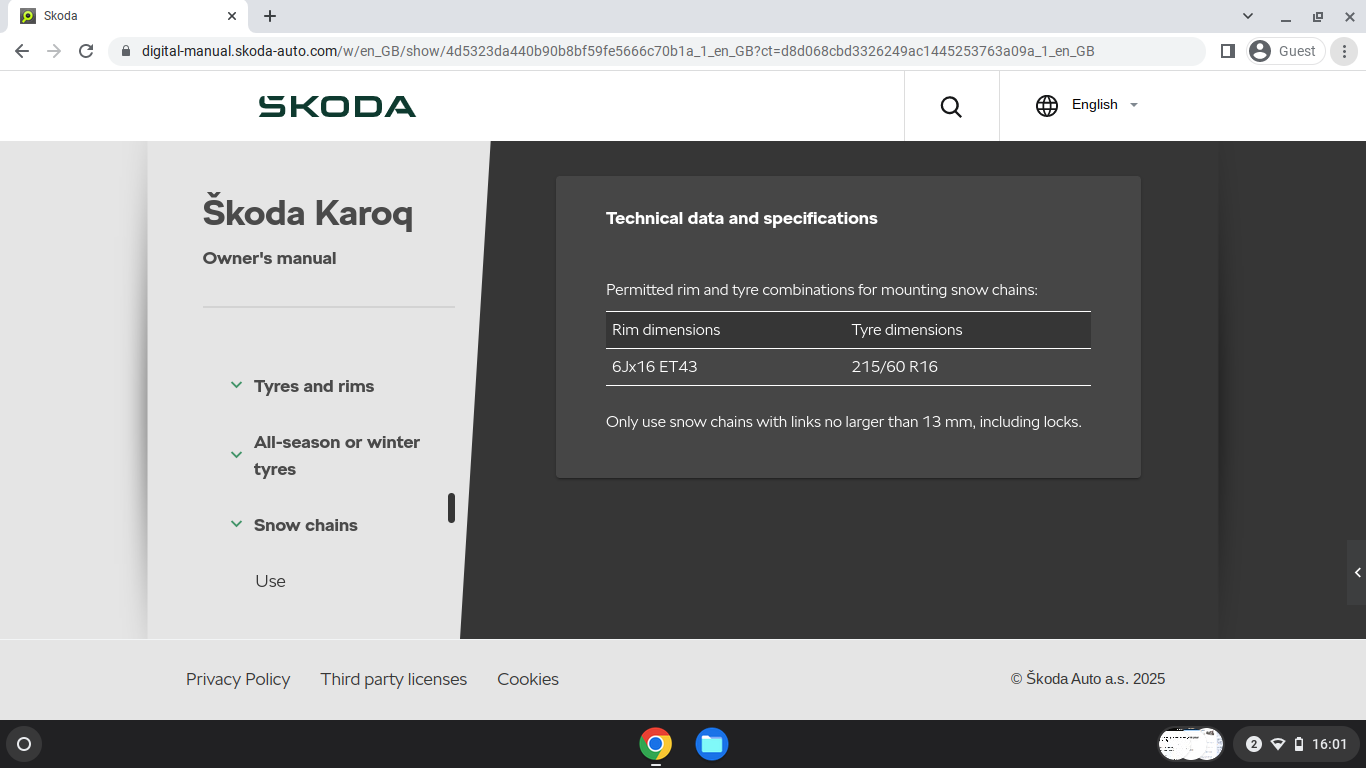

6 minutes ago, Ootohere said:
@kannanni Who at a Dealership, parts, sales or a technician?
EDIT,
I see salesman.
What does your Owners Manual show as the size of tyres suitable for use with Snow Chains?
Skoda / VW will sell you wheels that are Type Approved and appropriate and the choice of others in other countries,
& they might well be the RECOMMENDED SIZE IF USING SNOW CHAINS.
Not a Modification using the correct sized Wheels & Tyres for Summer or Winter when they are appropriate to the vehicle.
As far as the Insurers go and Brokers and some guff they spout, they need to be checking just what you are fitting and why and if a Factory or Dealer fit option. The person at the Dealership might want to check the sizes your vehicle can have fitted.
just checked my manual and it says rim 6Jx16 ET43 and tyre 215/60 R16 for chains in snow
I will ask for a technician from the main dealer to confim in writing.

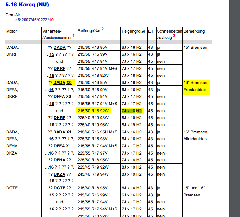

Any of the wheel sizes listed in the car's CoC (Certificate of Conformity) aren't a modification because they are approved by Skoda for that particular car.
All front wheel drive Karoqs will have 215/60R16 6Jx16 ET43 5/112 57.1 listed in the car's CoC, because that is the only wheel specification listed for use with snow chains.
If you couldn't use these 16" wheels, you wouldn't be able to use snow chains...and when it snowed you would have to leave the car on the drive and take the train.
Edited by Carlston
