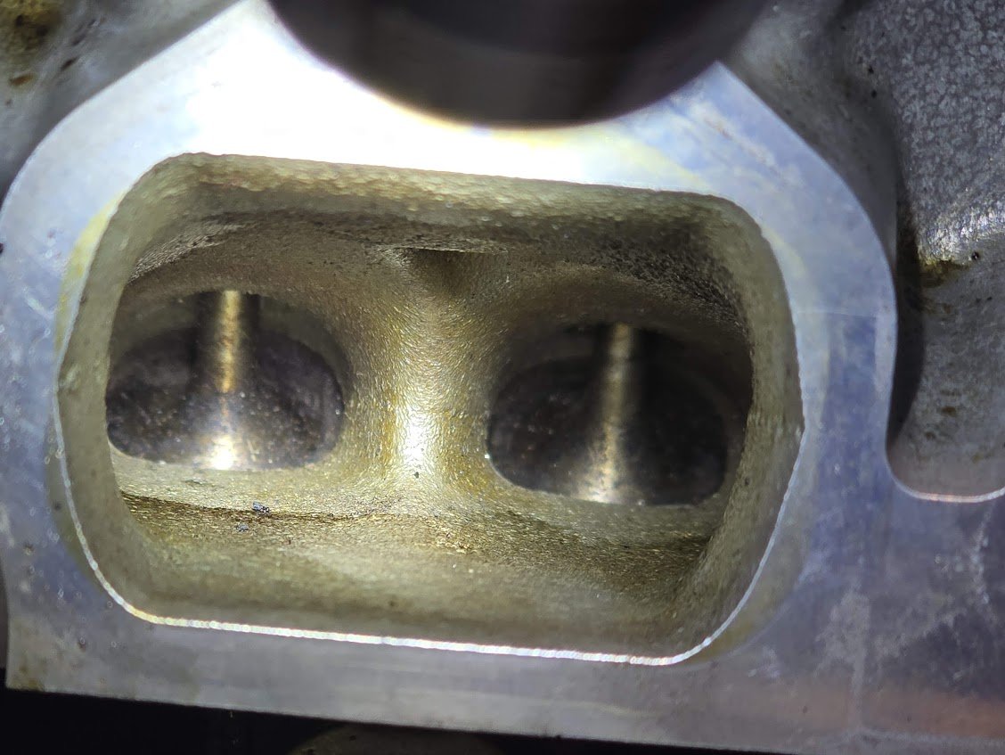

Aiming to take the inlet manifold off tomorrow so will see the state of them then, at least as much as the limited view down the ports will offer (image of a shiny clean head from an ebay listing):

Looks to me like it'll be hard enough to judge whether any given valve is closed or open, let alone get anything in there manually to attempt to scrape and clean.
It could be partly a camera angle thing but the ports look very narrow close to the backs of the valves, presumably to generate swirl anticlockwise?

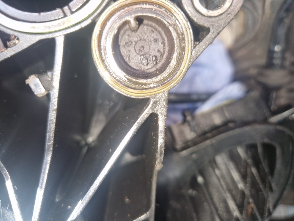

Thanks for that. Manifold is already off, surprisingly easy.
Tried to take some photos down the ports but really need torch, mirror, assistant. Had none of those.

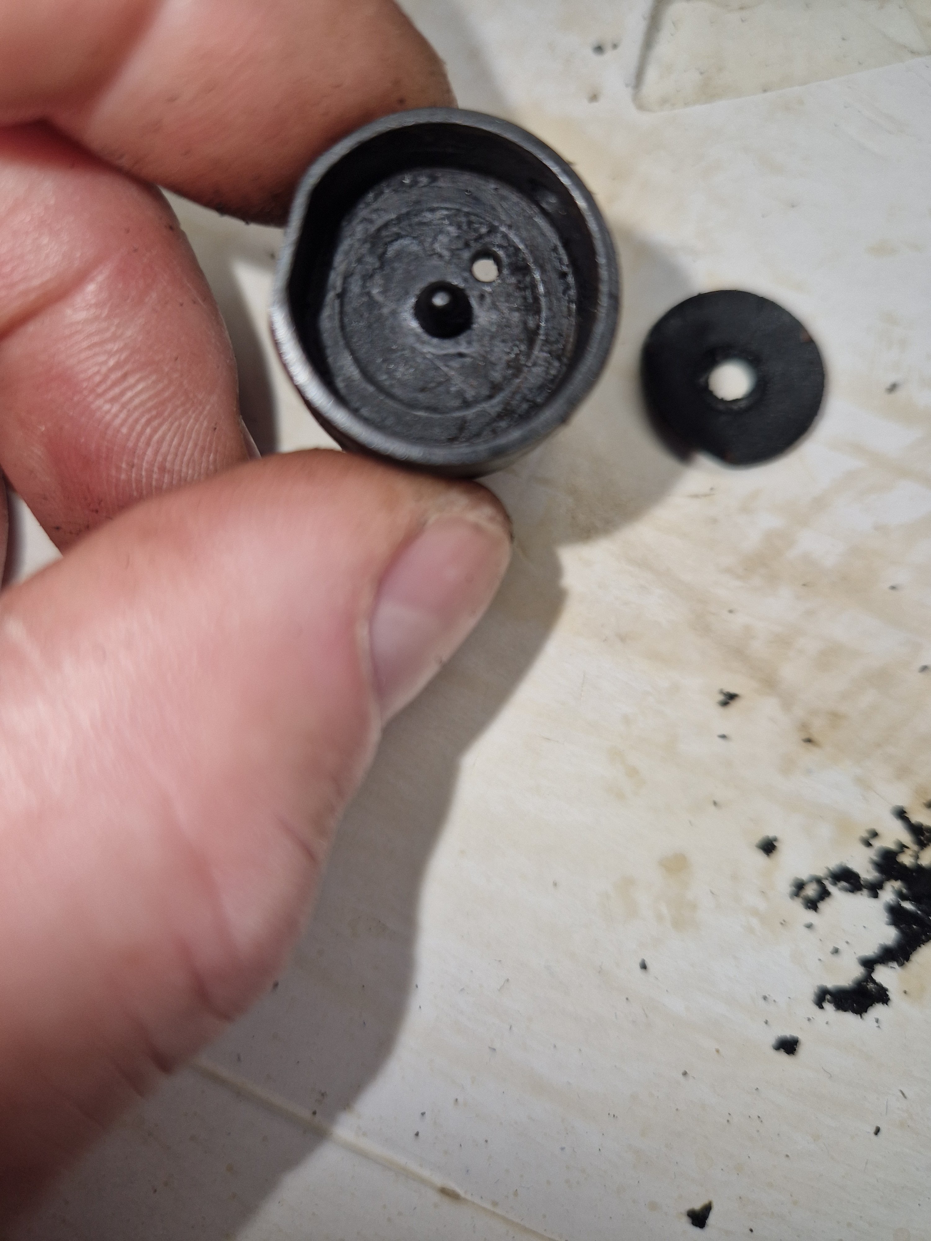

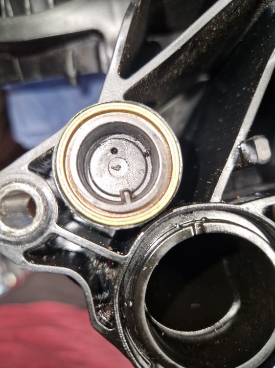

Did note with satisfaction that the breather jet that I expected to be completely blocked does indeed appear to be.
Should look like this:

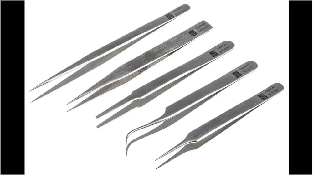

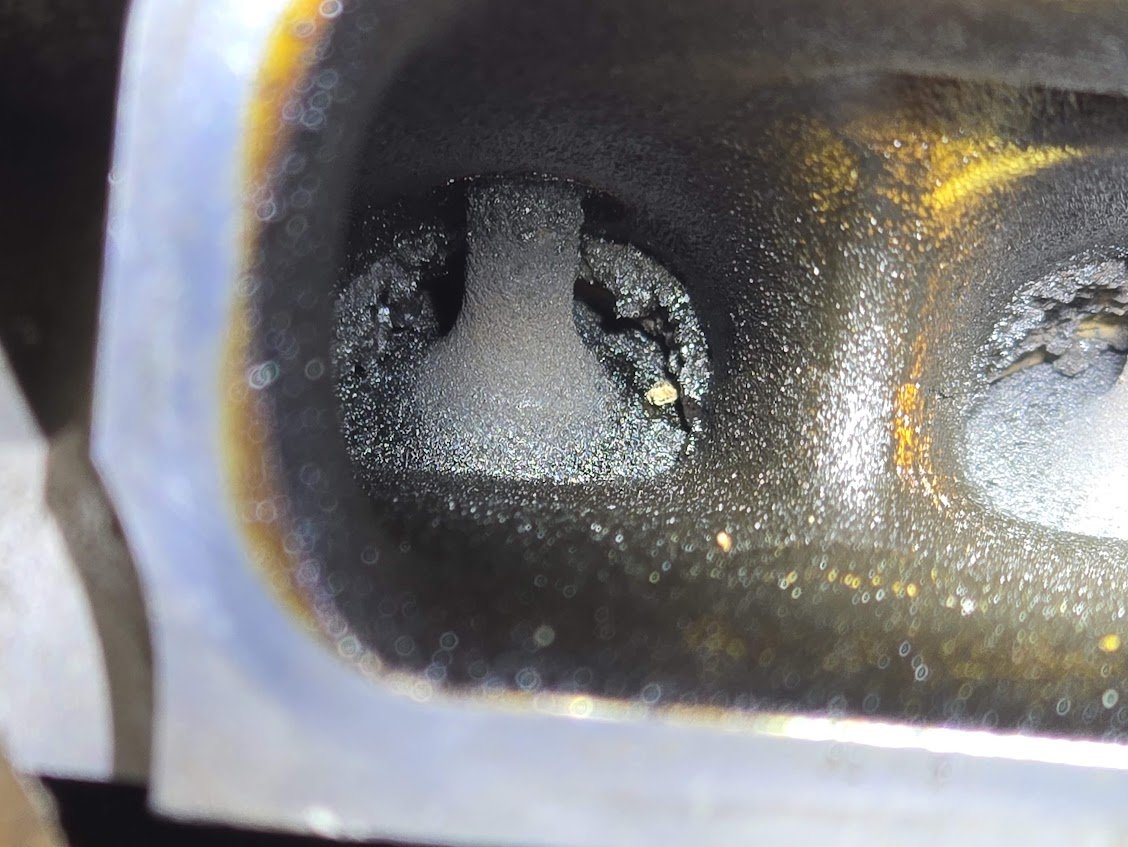

thats easy job now. turn engine to 4th cilinder valve sty open, that means that 1-2-3 are closed. spray little brake cleaner to see it valve seals properly. if yes, take bottle of carburetter cleaner add spray in ports 1-2-3 to the top. wait 12 hours, i left it to morning, you will se how easy dirt will come off, isung just plastic brushes and picks. i uset tools and stuff like that on pictures. cut a piece of this polimer mesh for cleaning copper pipes and fix it to some pick or little tweezers, with plastic zip ties, that i have not use strengh on fingers and detailed brush everything.
when liquid become black and thick, i pull it out with come cotton cloth, use compressed air too and see where depozits are left, then concentrate on them. same stuff carb cleaner and brushing.
all of that will cost you 30€, i wont never pay 700€ how much some garage ask me to, or skoda service i think 1000€. insane.
look before and after..

Not easy at all. Look at the image above of the refurbished, super-clean head and consider those views but with everything deep inside the port completely black and light-absorbing. Couldn't even see much at all with a device for looking inside the ear canal which my partner kindly offered. πŸ˜„
