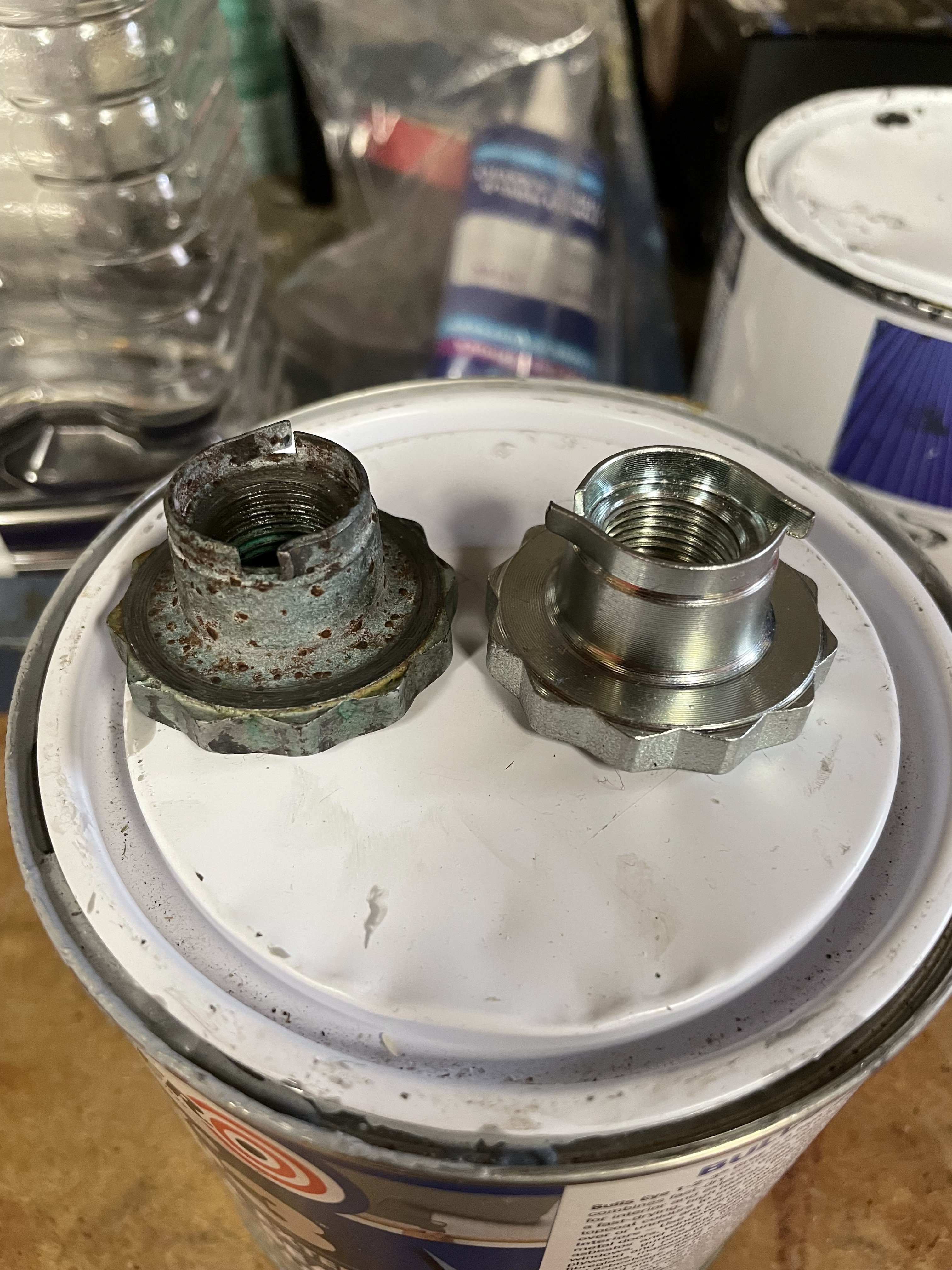

Your son was lucky, mine were not locktited.
In the photo, old and new where you can see one of the tabs missing on the old one. Both sides just span off.
Disappointingly, it may have happened last year at my local “trusted” garage where I had the front shocks replaced.
