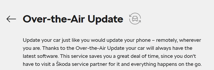

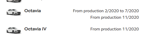

Buried deep in the Skoda pages is this little gem;
etc etc
which seems to imply some of the super early models could get it; but there was a period when it couldn't. Then, theoretically it should be able to get it (OTA update) from 11/2020 production date. I have a dreary sequence of device part number and software changes done by the dealer (but, of course, no helpful detail on what they actually did). I put 1941 on myself and it seems to be stable enough for me to not wish to get any higher.
I do not have this little box ticked (sob).

@inspectorman Build date for my car was 20/7/2020... which, based on the information you found puts it at the start of the period where they were fitting parts that were not suitable for OTA updates. Back then was the Covid/lockdown times, so they may argue there was a shortage of suitable parts...?

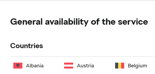

    2. Have you verified that Skoda claims that your car supports OTA? (go to https://www.skoda-auto.com/, select Connectivity, click on Connect Availability, top left select your country + click Confirm, click Select vehicle, enter your VIN (find it on front window bottom driver side alt on door frame driver side alt under the bonnet) + click Confirm, scroll down to General Information and check whether there's a box for Over-the-Air Update that is ticked)
      Answer: Yes

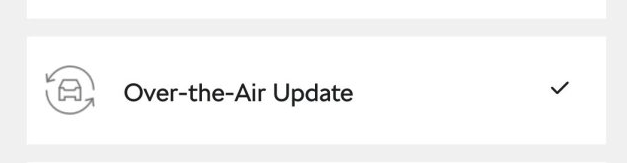

For my car...
Online manual instructions/conditions to enable OTA set : Yes
OTA shown as available for my VIN in my country : Yes (screenshot below) - the only difference that I can see from @JamesK car
Hardware Version: H56
Device part number: 5E3035816H
Current Infotainment version: 1941
OTA Updates currently being received for:
Infotainment: No
Maps: Yes
Apps: Yes

A bit too early to draw a conclusion but IF, and that's a big if, what is provided by Skoda below General Information is reliable, then neither Hardware (@Lowepepsi2004 has the same Hardware) nor Device Part Number might be relevant in determining whether the vehicle in question has support for OTA of System Updates.
@SteveTheElder has the box below General Information, @JamesK doesn't. But both have the same Hardware as well as Device Part Number. However, neither have received System Updates OTA.

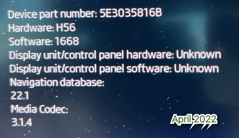

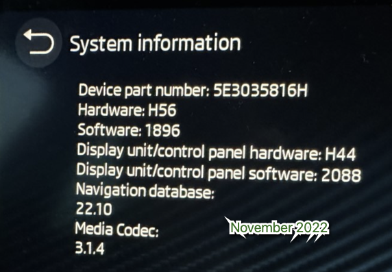

To complicate matters further I've went through some old screenshots of my infotainment. When it was on firmware 1668, the device part number was reported as 5E3035816B.
When it was upgraded to firmware 1896 was when the device part number moved to 5E3035816H:
Edited by JamesK
Added screenshot of 1896 firmware
As far as I can remember from other threads, the part number corresponds to the initial firmware of the unit. Sometimes it gets changed up with updates.

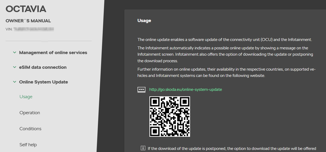

My user manual is dated 07.2020. It does detail the online functions but is fairly sparse on detail:
Yes, very sparse. Looks the same in my manual. It's a bit of a puzzle so that's why I made the compilation in my original post in this thread (but who am I to make such a compilation, I don't get System Updates OTA! 😵‍💫).
