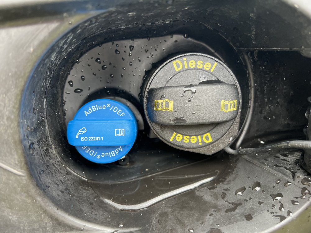

Hello everyone,

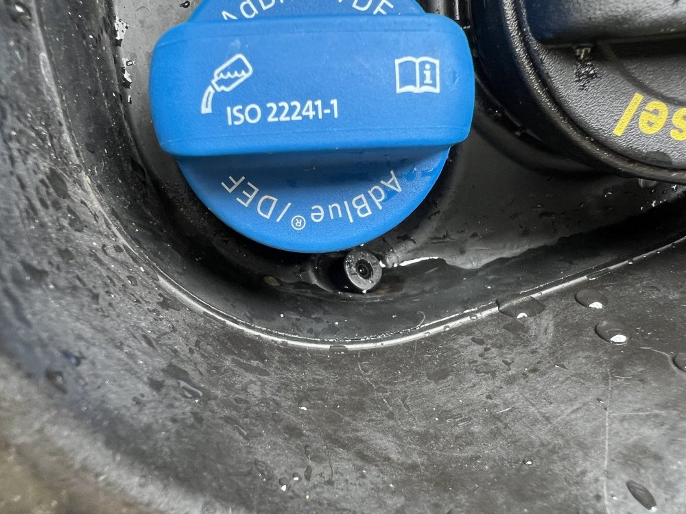

I have a problem with my fuel filler flap drain. It seems to be blocked.
I've tried using a very fine brush, but I can't get it in. I also tried blowing air through the drain hole with a syringe.
After heavy rain or when I wash the car, I have to empty the contents of the hatch with a syringe.
Do you know if this part is easy to repair? Is it attached somewhere or does the pipe fall directly onto the wheel arch insulation?
The hose reference: https://www.skoda-parts.com/spare-part/3aa809937-hose-skoda-44774.html
Thanks for your help!

They tend to just dangle down behind the plastic arch liner.
Ought to be pretty easy to remove and unblock.
I'd be having a go in situ with a bit of earth wire stripped out from some thickish twin and earth house wiring cable, or a straightened out wire coat hanger.
Mine was blocked, managed to clear it by poking gently with a cocktail stick.
Thin coated gardening wire or strimmer cable. It does block up from time to time.
