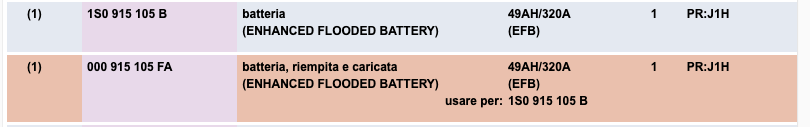

Hello, I replaced my Kamiq style 1000cc battery two years ago. I took into account the restrictive measurements and power requirements and found two brands, EXIDE and YUASA, with a slightly higher amperage 49 Ah > 55 Ah(perhaps avoiding coding) but with almost double the power, 540 A, with EFB type. At the moment, I am very satisfied with the change I made myself in 5 minutes. I am attaching the measurements and data for the original battery from spare parts.
Translated with DeepL.com (free version)
Schermata 2025-08-07 alle 10.26.13.pngSchermata 2025-08-07 alle 10.20.37.png

The Battery is 49Ah e 320A see on site https://ifinterface.com/page/page3.php?langid=1
