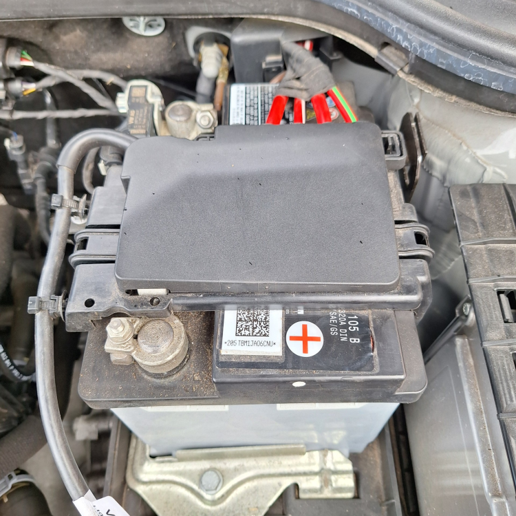

I did read through the Kamiq manual, but thanks for those attachments re the battery. Like a fool I thought I'll just pop out and check the battery acid level, that will instantly tell me what to do if the level is low. Lifted the bonnet, but of course this connection box on top of the battery restricts me from doing this. As it's so hot here, I will have a look when things have cooled down, then I will pop this connection box off.
