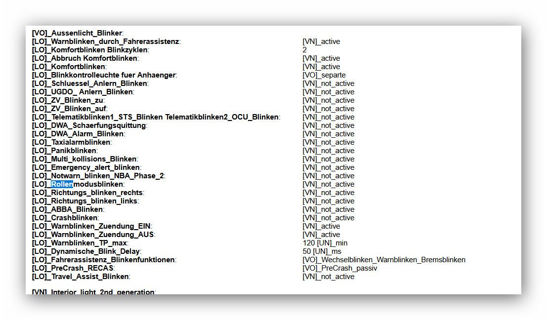

I have turned my dynamic indicators off on a 2023 SIII.
It is Rollenblinken not Richtungsblinken you have to inactivate.

Just enabled it on mine using VCDS (Rollenblinken), no idea why it wasn't enabled by default. I can barely notice it though, it seems only the outer lights sweep whilst the lights on the boot lid still flash.
Does anyone know what Richtungsblinken actually does?

Just checked mine with VCDS, I had Richtungs_blinken_links and Richtungs_blinken_rechts active already. Setting ZV_Blinken_auf and ZV_Blinken_zu enables sweeping indicators when unlocking and locking. It only does it on my rear lights though.

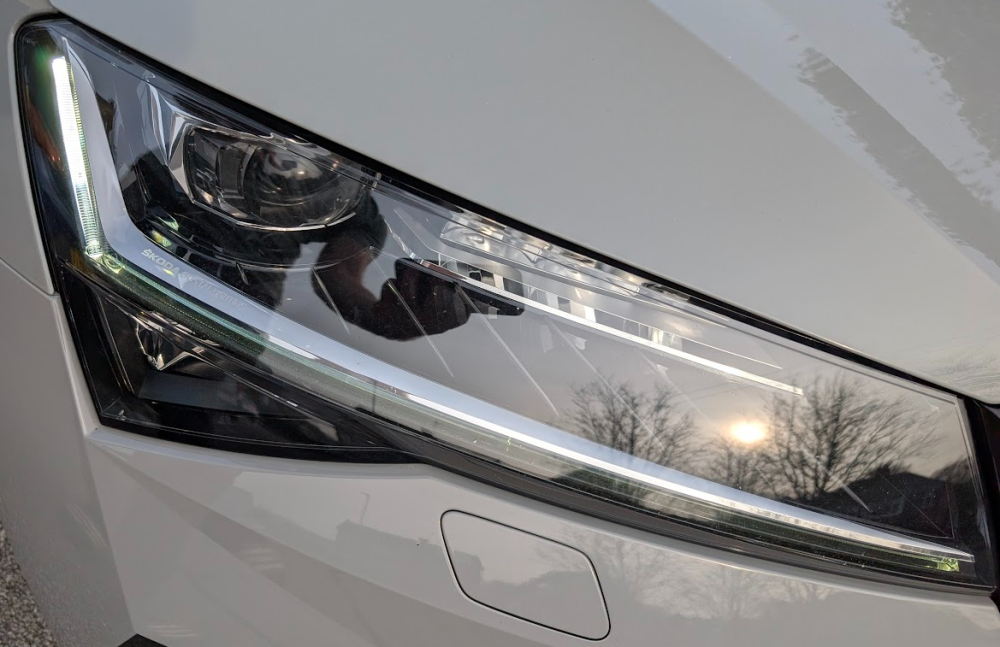

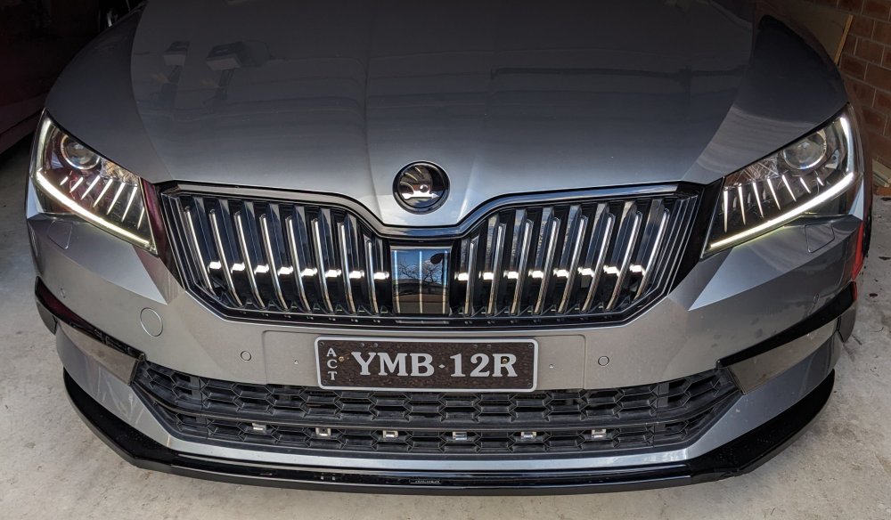

Yeah, permanently on the the bottom and left strip here
These eyelashes I meant.
Ah, just checked and it does have them at night. Maybe not permanently on though
