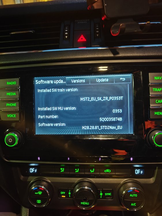

Hello all ,
Can anyone tell me which screen I can upgrade to without any hassle just a simple plug and play I currently have the one attached below
@pab567 will help you out
5E0919605J (6.5" pre-lifted, exactly the same as you have now)
5E0919606 (8" pre-lifted)
5E0919605M (8" face-lifted)
I also recommend upgrading formware to 0369 (or 0480 if word like "patching" don't scare you)
Thank you Legend ! I'll be looking for 5E0919605M (8" face-lifted) I'll give the "patching" a go in the meantime 😆.

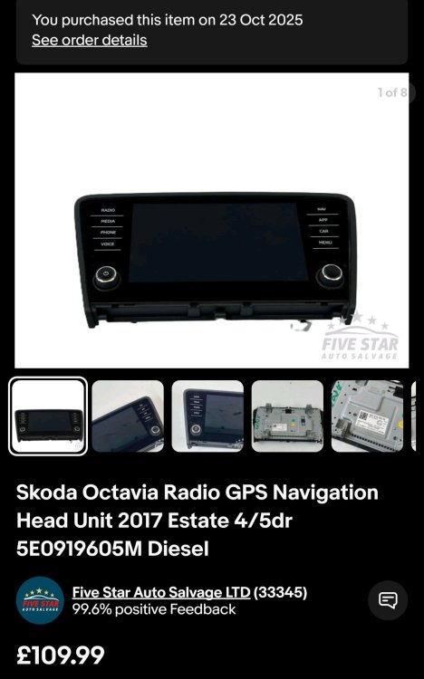

Hi Pat,
I bought this , in an earlier post did u mean I should upgrade 0480 on the new one or previous unit
It's a pity that this screen is INCOMPLETE - it is missing plastic trim at the bottom.
I mentioned upgrdae to 0369 or 0480 - I sent you links for both.
Keep i n mind upgrade to 0480 requires unit to be patched first and modified metainfo2.txt - don't ask me how to do it, search for MIB STD2 TOOLBOX.
😭😭 So now I have to hunt for the trim !
