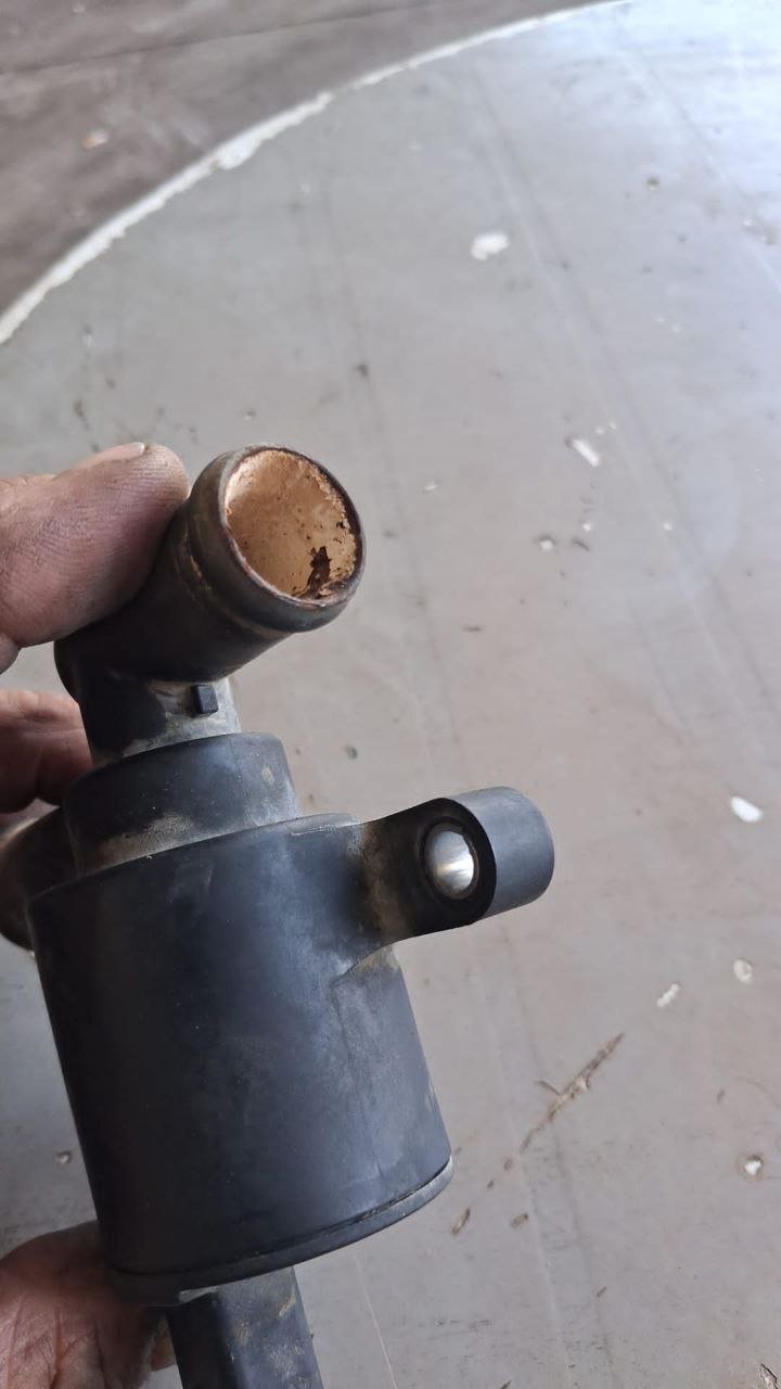

main waterpump
heat pump
auxeliry water pump
coolent tank

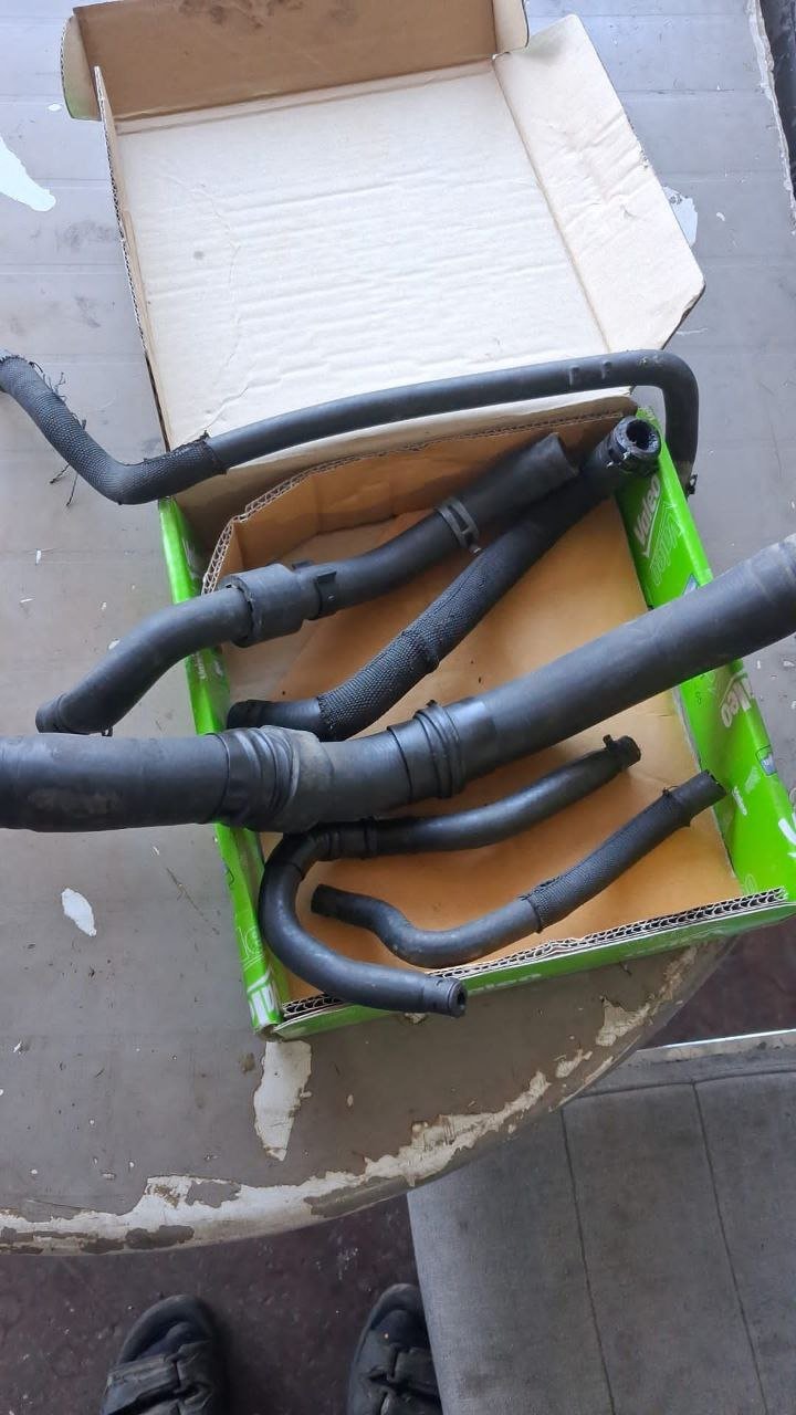

all the hoses
coolent.

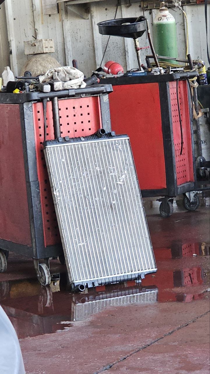

next week my radiator cracked and got replaced too.
in another words the whole system got re-newed :)

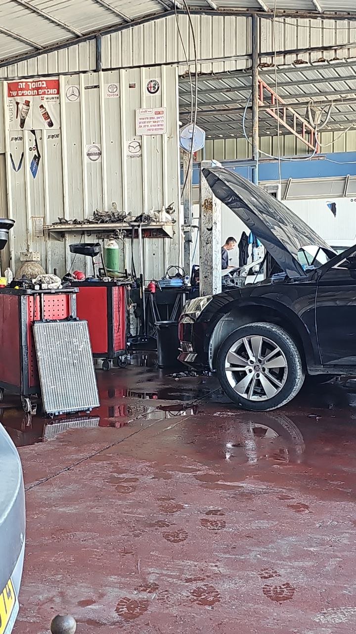

he said coolent should lower for about few days because of all the air and stuff after he replaced the radiator and did a pressure test (that i didnt see what he did exactly).
it has been 2-3 weeks from my last visit, the coolent WONT STOP GOING DOWN!
no leaks under the car, i even replaced the coolent cap because i heard some people said it helped.
i got no headgasked/engine block problems from what the mechanic said
do someone got a hint??? its driving me crazy and i cant get any ideas.

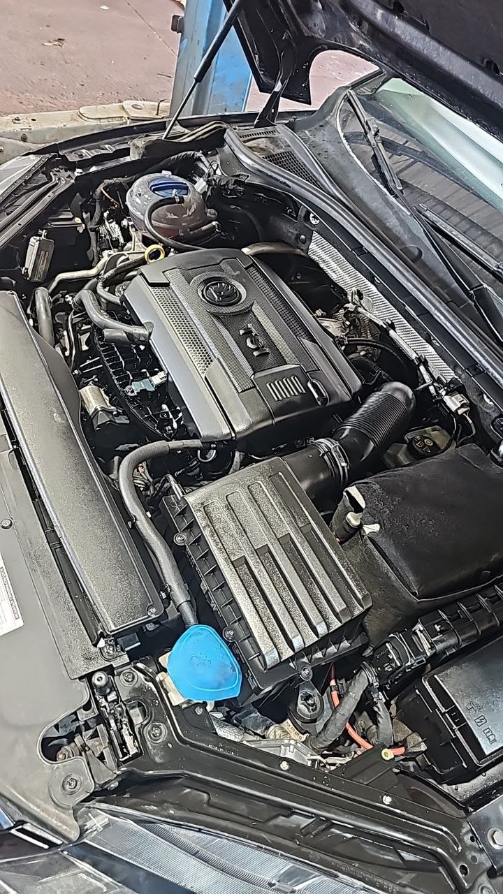

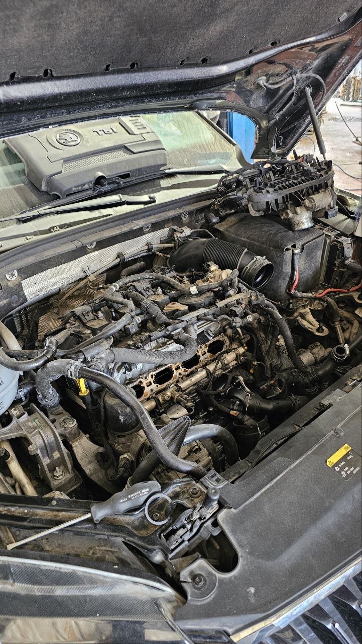

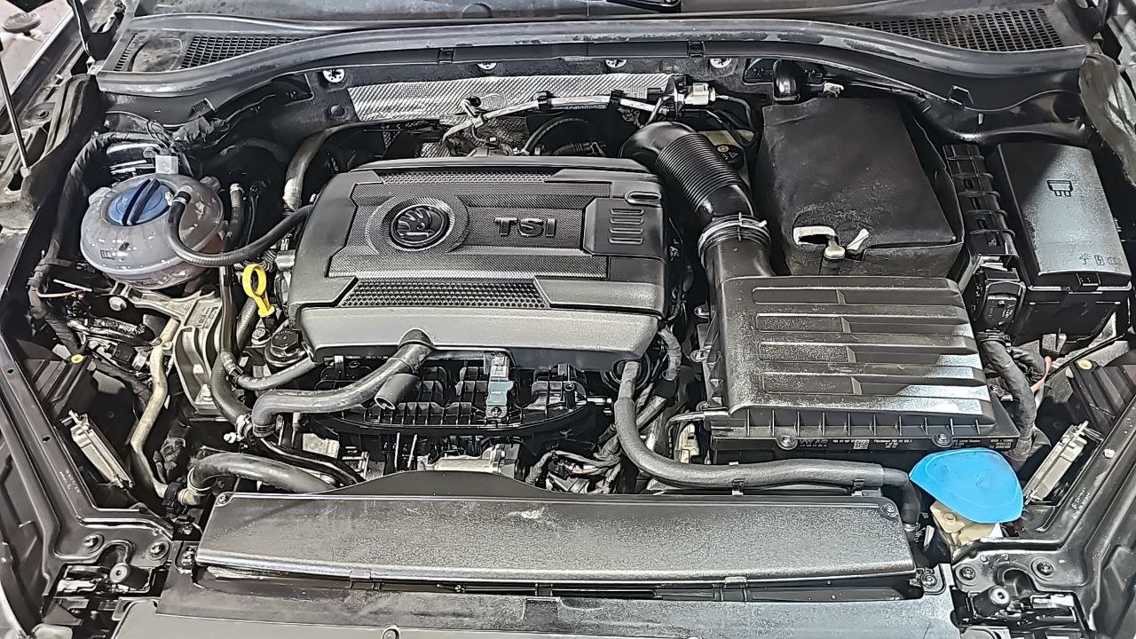

i adding some pictures from the repairs and such

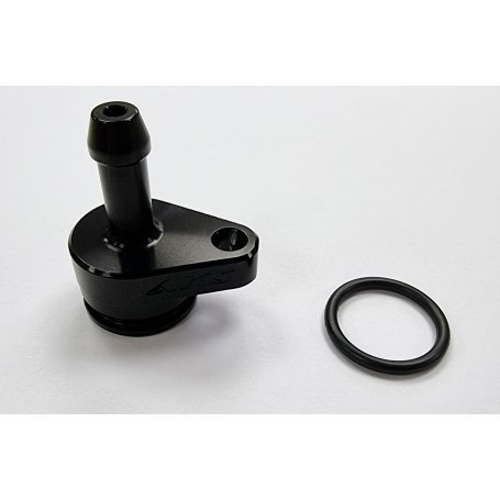

check the stock plastic version which is siutated at the back of the engine as it prone to fail:
