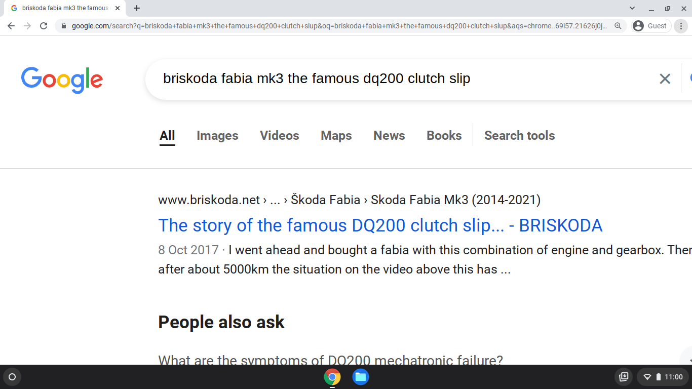

The DSG might have what in the Fabia Mk3 section is in a thread titled ' The story of the Famous DQ200 Clutch Slip.
