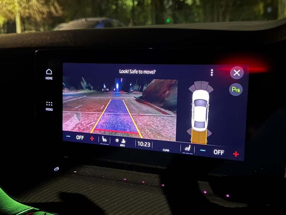

Hello, does anyone know if it is possable to recode a rear camera 5WA 980 556 B. I got a used camera off ebay from a (SKODA NX) but will only show me AUDI view and will only code as an AUDI?
It works perfect just would like the other views
