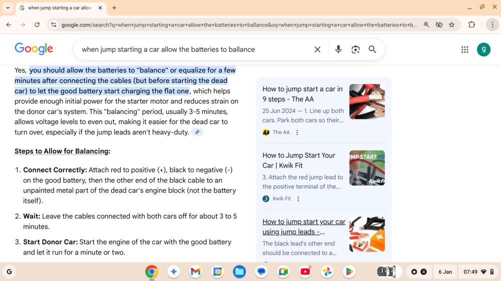

This
When you connect to the final jumper clamp you should see a small spark and or hear the other car load up a bit.
Try earth connection to engine or even negative on the skoda battery.
Then after 2 min, try and crank the skoda with the Seat running and connected still
This is just as many have done for decades. Now with modern electrics doi not be surprised if there are Faults / Warning lights, steering etc, which may require once the car is going to turn the steering to each stop. A starter pack is by far a safer way of boosting and starting.
