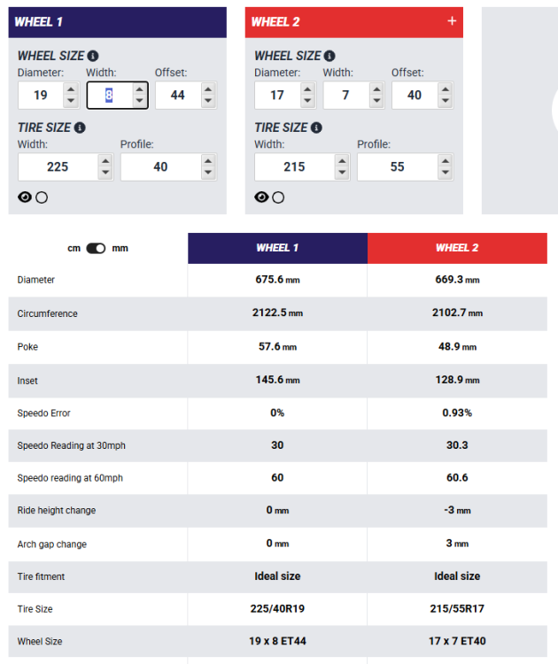

As you can see in the chart below, changing from 235/40R19 to 215/55R17 will make the speedometer over-read more.
Outside diameter of tyres
235/40R19 670.6mm
215/55R17 668.3mm (0.3% smaller outside diameter compared to 235/40R19)
Edited by Carlston
225/40R19 should read 235/40R19.
Edited by Carlston
