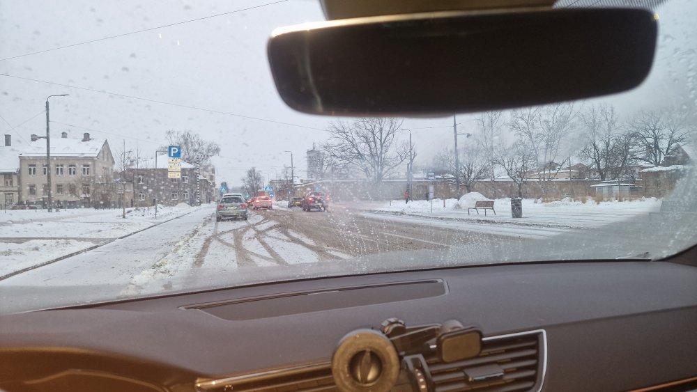

I was driving for like 1.5 hrs in temps ranging from -8 to -5. Suddenly I felt a freaking humid air thru my nose and the windshield started to fog up quickly (air quality sensor kicked in). Sure, it was cold outside, is this really normal?
I went to the dealership, where they checked this fogging, and of course it wasnt that bad after standing still for 5 mins till a technician came to check, interesting... so of course they said it is normal. (But I drove the 2016 one the same day, and I went on trying the inner air circ button for an hour, NOTHING, not even a slight patch of fog)
One thing to note, the windscreen was replaced before selling the car to me, as it had a crack. Can this be a botched install, maybe?
Of course, I have a video of it, how it looks, how fast it builds up, the outside temp was -8.5 at that time:
I would greatly appreciate any feedback from you fellow owners, maybe you guys have an idea what or where to look for. Additionally, fogging started also, when the headlights were washed, only slightly though.

I dont have that problem aroubd the obd port, so I can offer pictures of that area, maybe that helps? In exchange you could check how the car reacts to using the inner air circulation in this cold 😉
Quick update on the matter.
Even though that the windscreen was changed by an official skoda dealer in germany, it turned out the install was botched and there were holes on the under side, in the glue itself. RESOLVED
