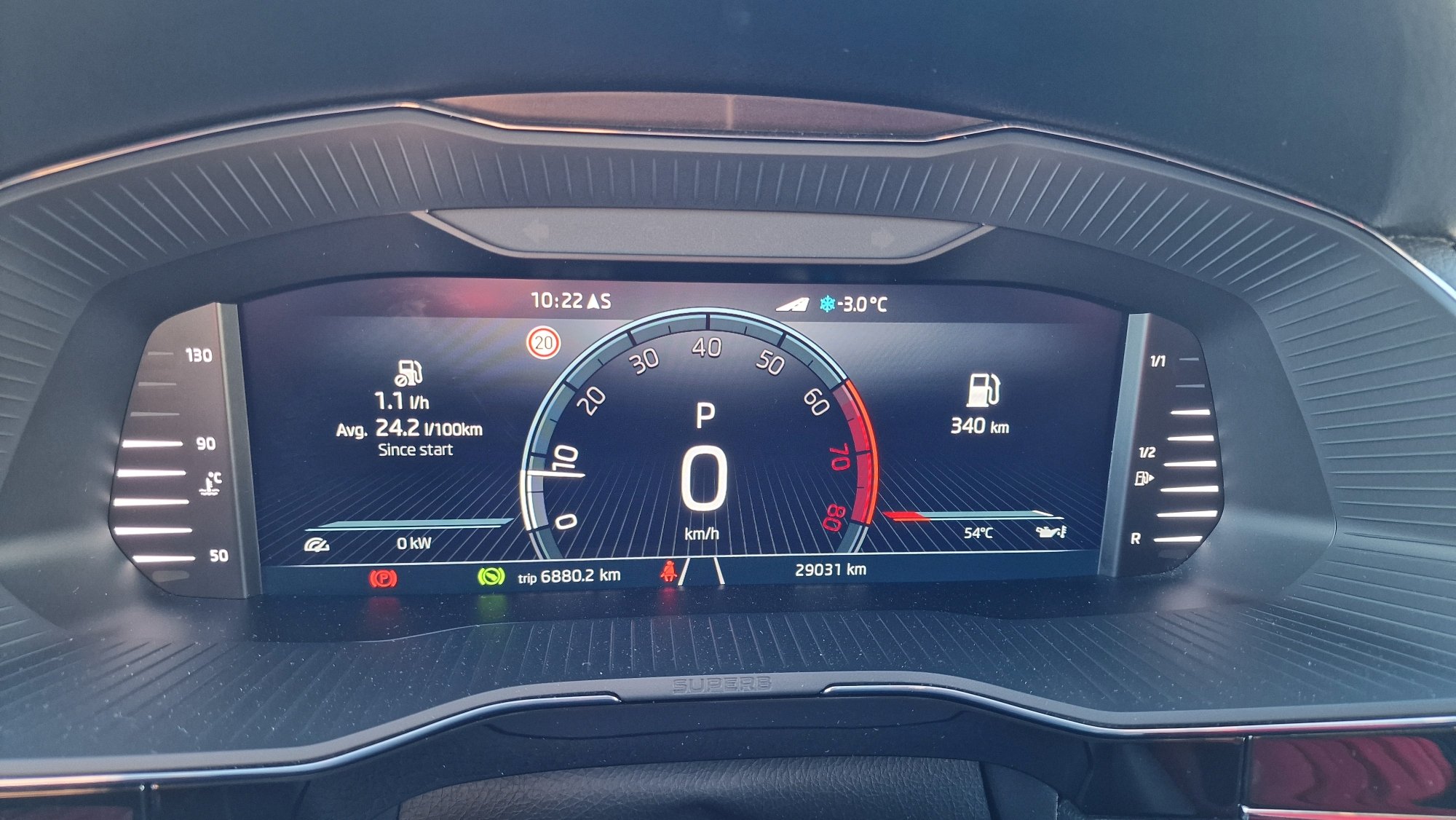

outside: -6°C
oil: 87°C
cooling fluid: 90°C

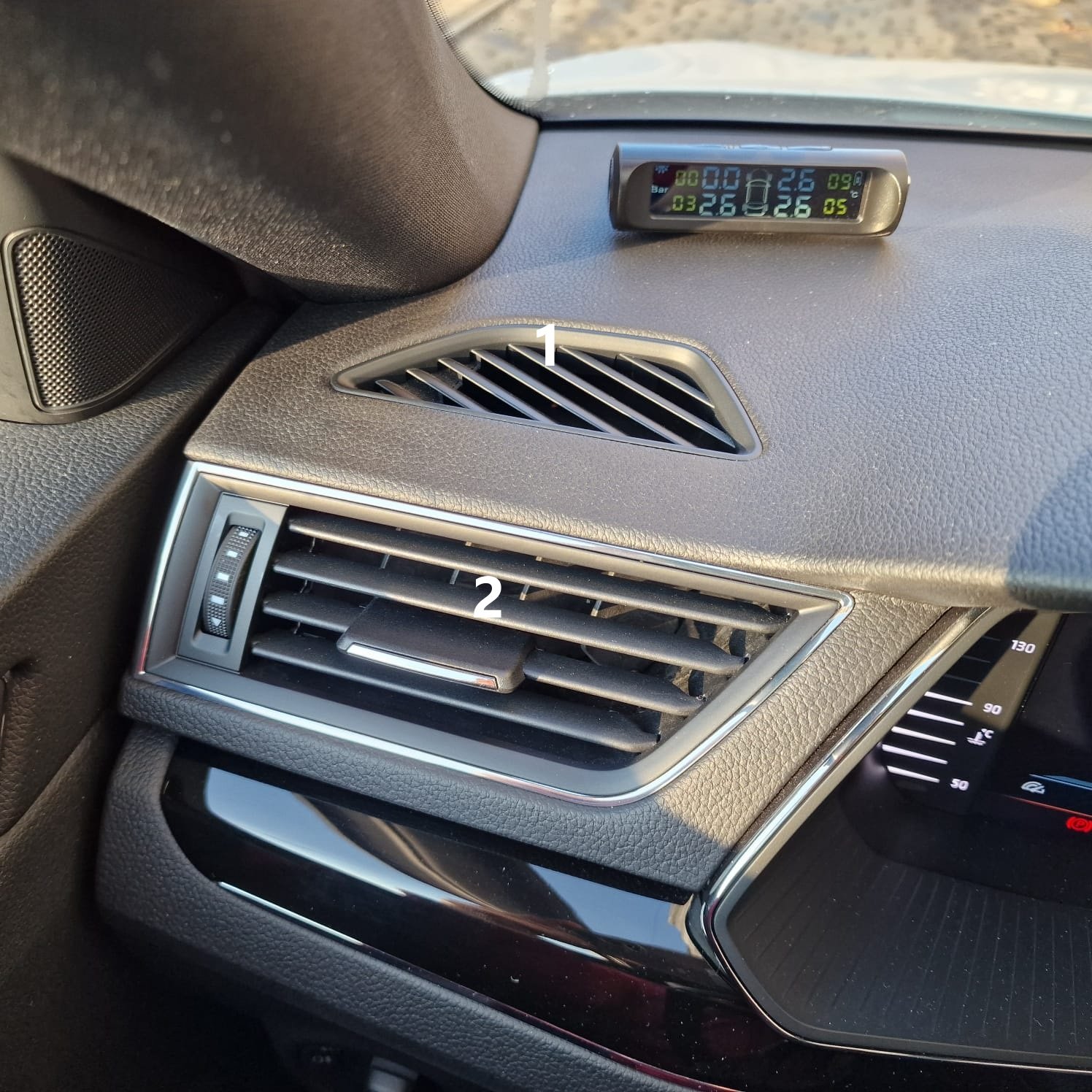

Do you have auto on? If so you get different temps from the vents or not on at all.
Bit like mine if I have it on auto I get warmer side vents compared to the ones above centre screen, taking it out of auto and pressing the forward only vents “fixes” it, but auto gets the whole car to your desired temperature quicker

Added to the above I wonder if you have some loose trunking under the dashboard on that side that should be feeding one of the vents
@Danoid
Auto + AC all time
@skomaz
most likely something has been disconnected, because blue marked area has no air feeding holes

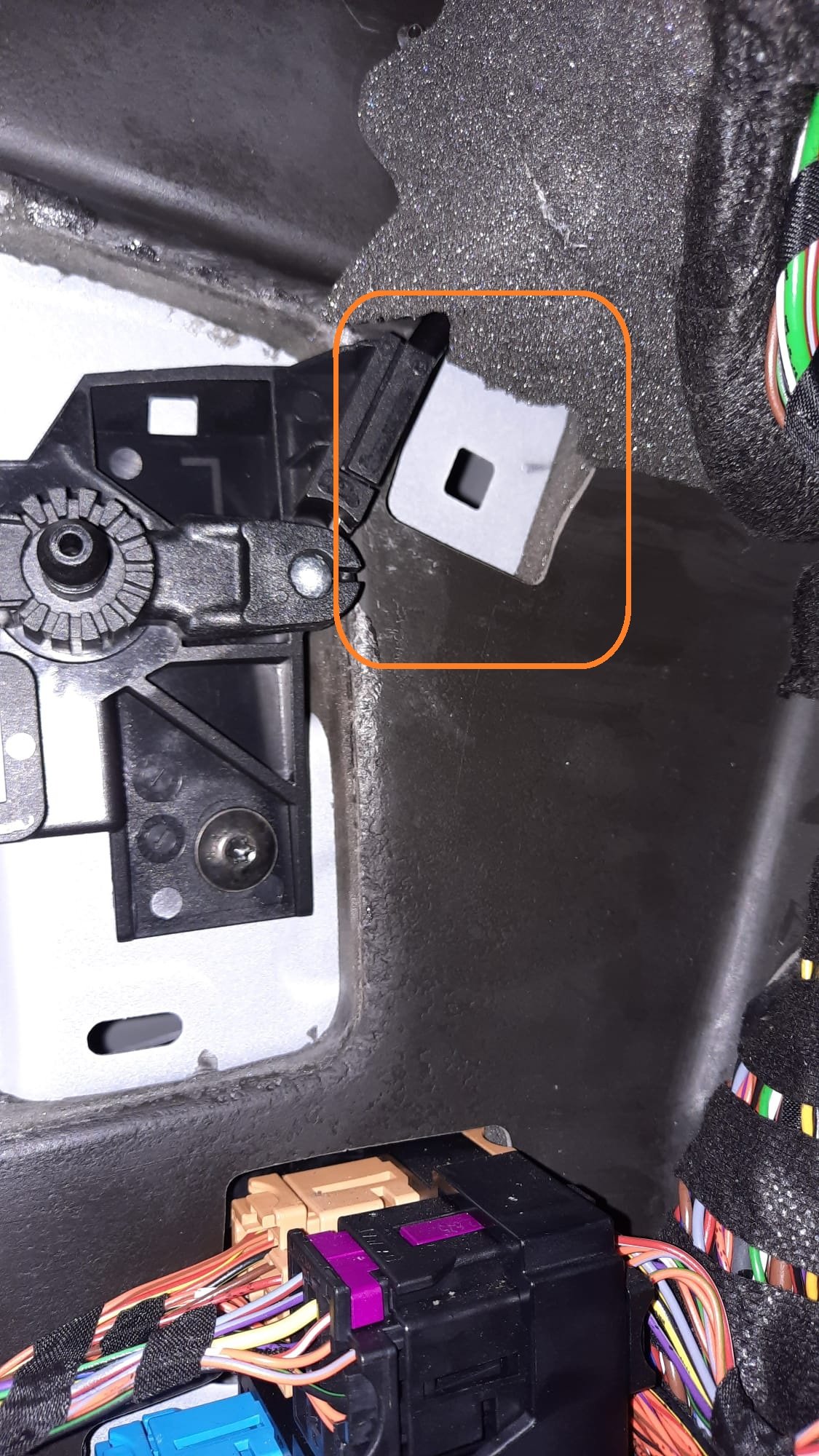

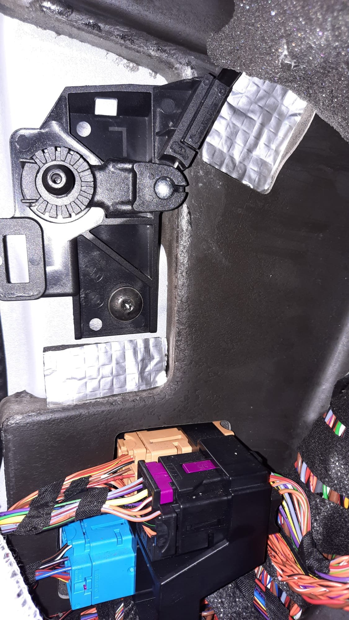

dealer managed to find some hole which they weren't expected,
same as they weren't able explain where did it come from
just covered holes didn't help at all 😞
No, those holes could not generate such temp difference. I've driven my Range Rover for long periods with various parts of internal trims removed, for various reasons, and yes I have felt cold spots, but not such a massive difference ....
