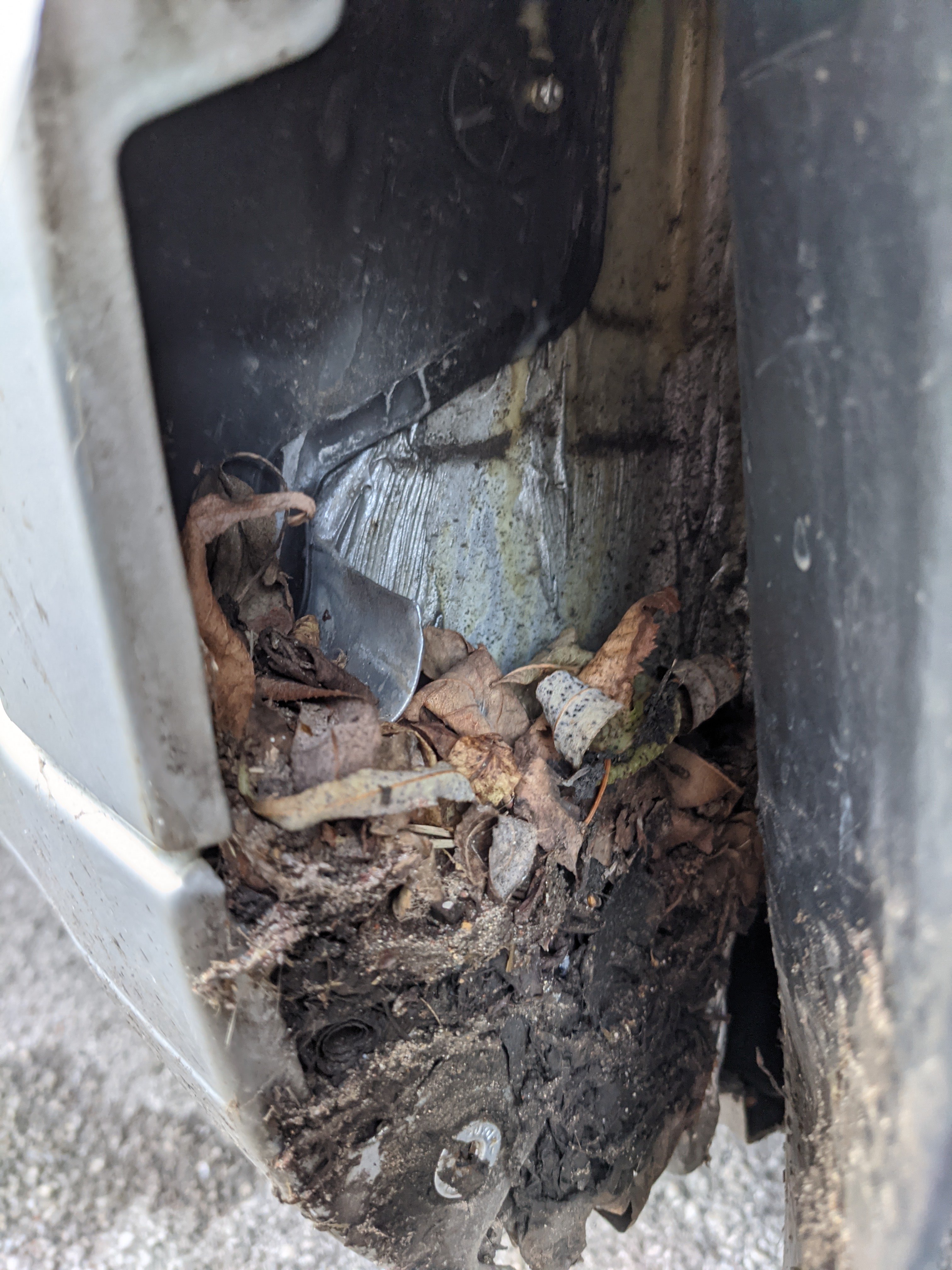

With the mkII check around the plenum chamber especially where water flows down into the rear of the front wing. It's prone to getting blocked/ restricted and if it does water will find it's way in somehow. Also check behind the wheel arch liner where the rear of the front wheel arch meets the sills - it's usually full of all sorts of carp and can eventually rust through. Easy job undoing a few screws each side.
