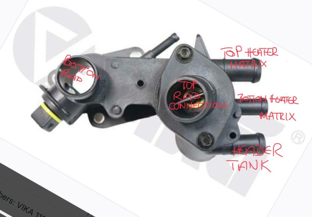

Checking what I’ve fitted the thermostat housing is correct to LLLparts though mine according to my order has an 80 degree thermostat rather than 87 degree one quoted.

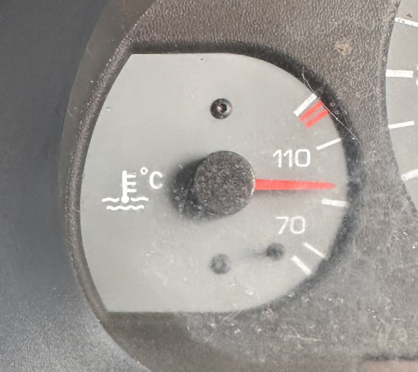

When the car is sat on the drive the temp will climb slowly towards 100 degrees, the fan kicks in and will bring it back down to 90.

It comes on when the needle is horizontal or around 100 degrees

Another thought (a rare event), as I don't know the heater plumbing arrangement I'm not sure how the heater matrix would be a cause, partial cause or contributory cause to your issue, but how about rather than ordering a new matrix first try bypassing the heater matrix to take it out of the equation and see if that makes any difference.
