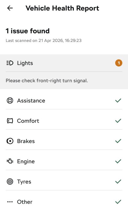

After I stopped and restarted the car, it was fine. But my 'My Skoda' app has recorded the below which implies that it is a lighting (presumably indicator) issue although, when using the hazard lights to check, all indicators are working fine (including those on the door mirrors).

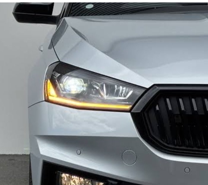

Is the front right turn signal lighting a bulb or LED?
If it's a bulb it could be loose or faulty.

It's a fancy thing like the below that I assume to be multi light LED. It all appears to be working fine....

The photo in the original posting indicates that PongoBongo's 2025 Fabia Monte Carlo has the 'Full LED' headlights that are optional for that model and are mentioned here
https://www.skoda-storyboard.com/en/front-2/

The problem should definitely be mentioned ASAP to the Skoda selling dealership and see what they advise. The fact that the My Skoda app referred to an issue with the "front-right turn signal" might suggest a fault confined to the headlight unit itself or to the indicators' control system (or to computer bloody-mindedness!)
It may be necessary to wait and see if the problem reoccurs and, before stopping/restarting the car, check if it's only the front-right headlight indicator's speed that has doubled or all the right-hand-side indicators.

(I'm not sure it's still possible to opt for 'adaptive' LED headlights on current UK Skoda Fabia Mk4 models. All Fabia Mk4 cars now have 'all LED' headlights (ie. they do not contain traditional bulbs) as part of their standard equipment, but only the 130.has 'adaptive' LED headlights as standard.)
