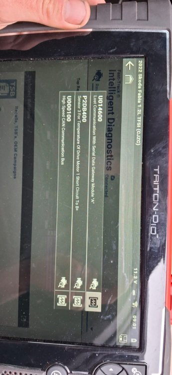

Ok so he’s plugged it in and it’s saying misfire on cylinder 2 & cylinder 3 also secondary battery is very low? I was unaware the car had 2 batteries or am I misreading that fault, also the fuel cut off has activated ?
I’ve also just remembered when the car stopped it did come up with something about stop start on the dash but because I was concentrating on getting off of the dual carriageway I’m unsure exactly what it said, I’m just wondering if there is a way to reset the fuel shut off valve? Maybe disconnect the battery ? any thoughts would be appreciated. Cheers Paul

Hi, I’ve got an update, I asked if he could do a compression test as I was panicking a bit, it’s been checked and all good, he’s also checked all of the fuses, 3 fault codes came up as shown below, he’s going to do some research tonight, however I did tell him I’m a member on here and said I would ask if anyone had any thoughts please, many thanks Paul
