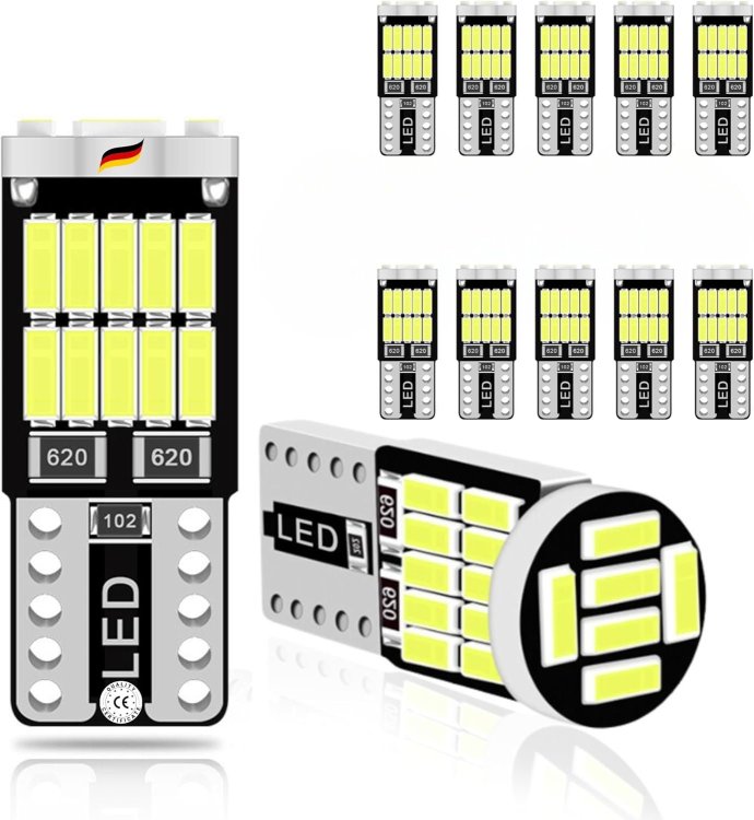

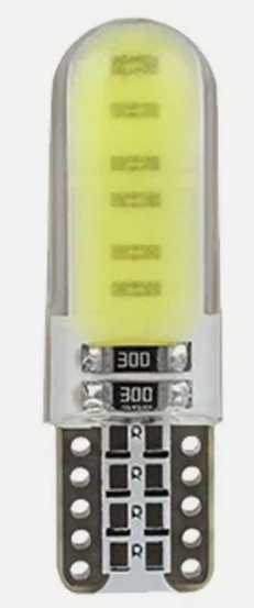

I usually get the flatter profile ones for this job. The last lot I bought did require a little trimming of the clear soft transparent plastic around them to fit the boot light holder but at £2.24 for ten I wasn't complaining. image.png

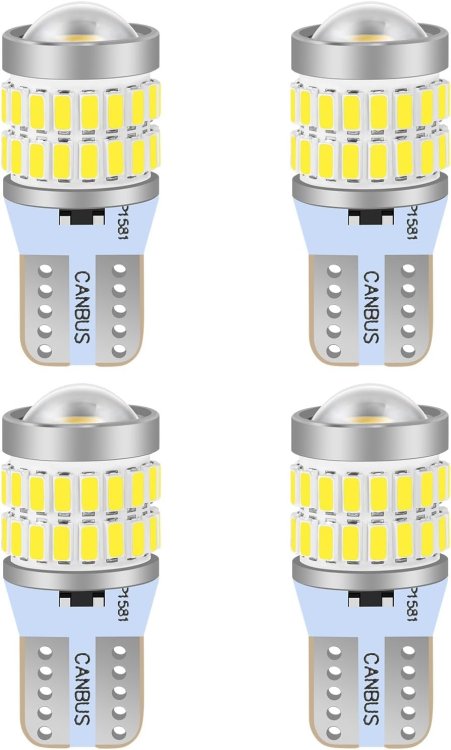

I've placed an order for bulbs ("XELORD" W5W T10 LED, supposedly 800lumens but I'll believe it when I see it, since most W5W LED replacement bulbs for which I saw lumen ratings were 450LM and 300LM). https://www.amazon.es/dp/B0DK8FV8V8?th=1 These bulbs have the word "CANBUS" printed on their stems. 🤞
We'll see. (If the new bulbs are bright enough, that is!)

Ahhhhhh, nuts. These bulbs' metal fins are a bit too short/ the much wider diameter LED round blocks the fins from pressing far enough into the T10 socket to sit securely. Returning, continuing the search... (Also, still need guidance on how to get the over-the-rear-passengers'-doors lenses out of their holes without breaking something ... Bueller? Bueller? 😅).

Also re bulbs try the flat one sided 'cob' bulbs rather than cylindrical ones... Auxito are a good make in my experience.
