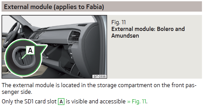

I wanted to look into updating the firmware of the headunit, but I can't seem to find any SD-card slot or anything at all inside the glove box on this one. It does not have a nav button either.

I sent you link to download MST2_EU_SK_ZR_P0480T.
SD card slot is available inside glove box, vertically, next to the display.
