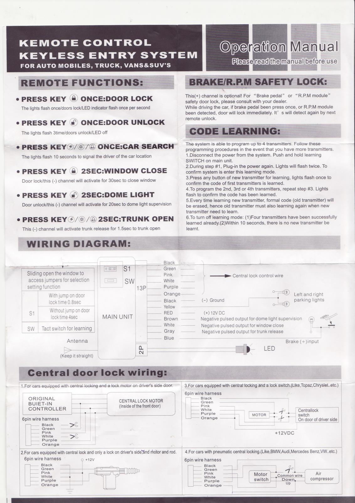

Im trying to install this unit http://dvbnzx2bwm8w.cloudfront.net/dat/files/centrallaasdiagram.pdf
(put it aside for a while, but im back now). If you scroll down there is a diagram of the control unit pinout.
The car (2001 1.4mpi comfort) has central locking allready and i really just have to find out what wires to connect.
they are sorted as follows from the control unit:
Red = +dc power
black = ground
blue = lock control (all)
green = lock control (all)
brown = lock control (front)
white = lock control (front)
I just want all doors unlocking and locking, so brown/white wires shouldnt be needed atall (i think, this i a question actually)
but it could see the brown/white detects the doorlock position (manual unlocking) and forwards it to all doors, that feature is allready in the car so isolate?
Anyways that leaves me with basically 4 wires, i guess they just share GND inside the unit so i wont have to splice 3 wires like the guide says and i could live without the indicator lights flashing. But still ??
GND and DC+ i can find, but how do i go from there? green and blue in the door with a 180omh resistor or what?
Get power on the unit and see what signals come out the wires?
Edited by Sort

quoting myself, i bought this kit:
http://www.ebay.com/itm/281455816017?_trksid=p2060778.m2749.l2649&ssPageName=STRK%3AMEBIDX%3AIT
I dont really need the key and the remote to be as one, i hope this kit will work.. :)
the resistor makes one signal come out with less amps, as far as i can tell that tells the car components if you pressed lock or unlock.
My unit finally went in the car this weekend, i skipped all the lights etc, cause i really need to see the unit actually lock/unlock the car before i move on. My car is LHD so possibly i shouldnt have connected to pin number five (theyr numbered on the plug) either way it does click but doesnt unlock the doors.
Next step is test the output on the wires in that white plug, as i press the lock/unlock buttons on the car panel.
As i see it the whole setup basically fools the car into thinking someone pressed those buttons anyways.
My unit originally reverses polarity on two wires when it activates, so i had to solder up a little circuit board with 4 one way diodes and that 180 ohm resistor on it, to get two positive signals,
Edited by Sort
