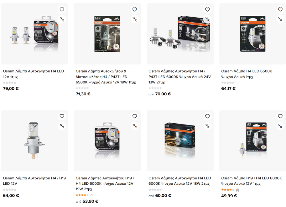

I have no intention to travel around the World with my Felicia so the other countries Police won't stop me.
I have Led bulbs (better than HID bulbs) but the light concentration with stock headlights glass isn't good in highbeam.
why better?
