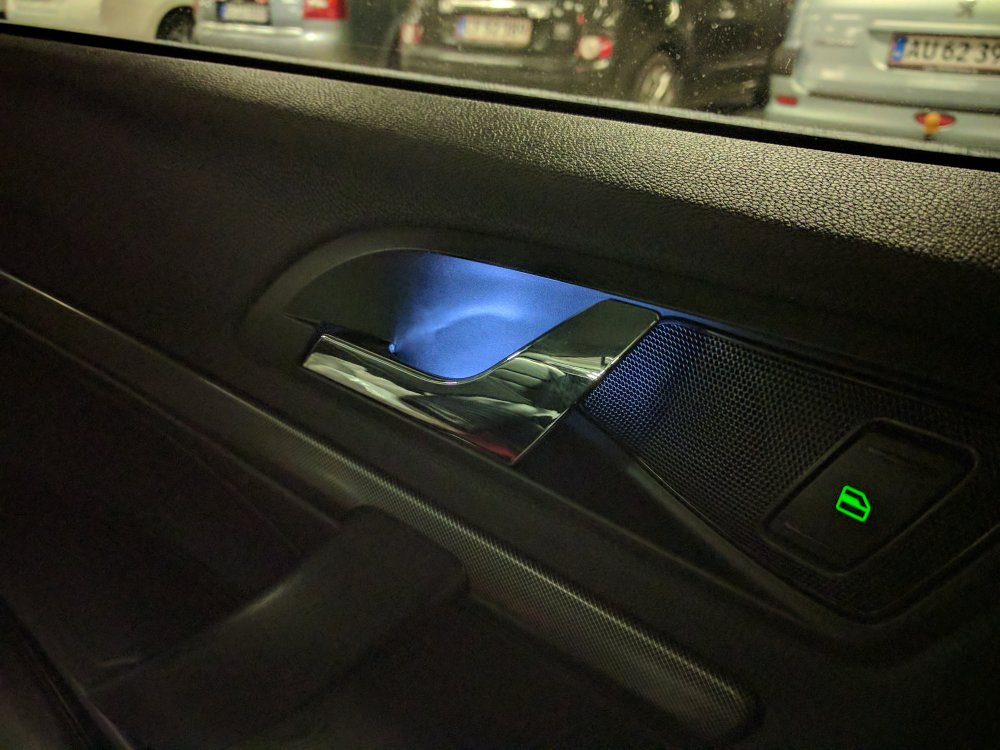

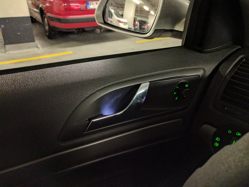

Today I added an illumination in internal door handle from L&K to my vRS
Demophoto L&K (it is what I wanted)
Parts for this (left and right lamps, around 6 pouns each)
Removing door handles and bring them at home
Back of a handle. Inside red cyrcle you may see mount for illumination and rectangular for removig
Drilling holes and finishing them to rectangular
Illumination
Done. Connection is easy - on the driver side to mirrors adjuster, on the passanger - to window lifter switch. Black wire to brown and blue to gray/blue. Also I add a green light filter
