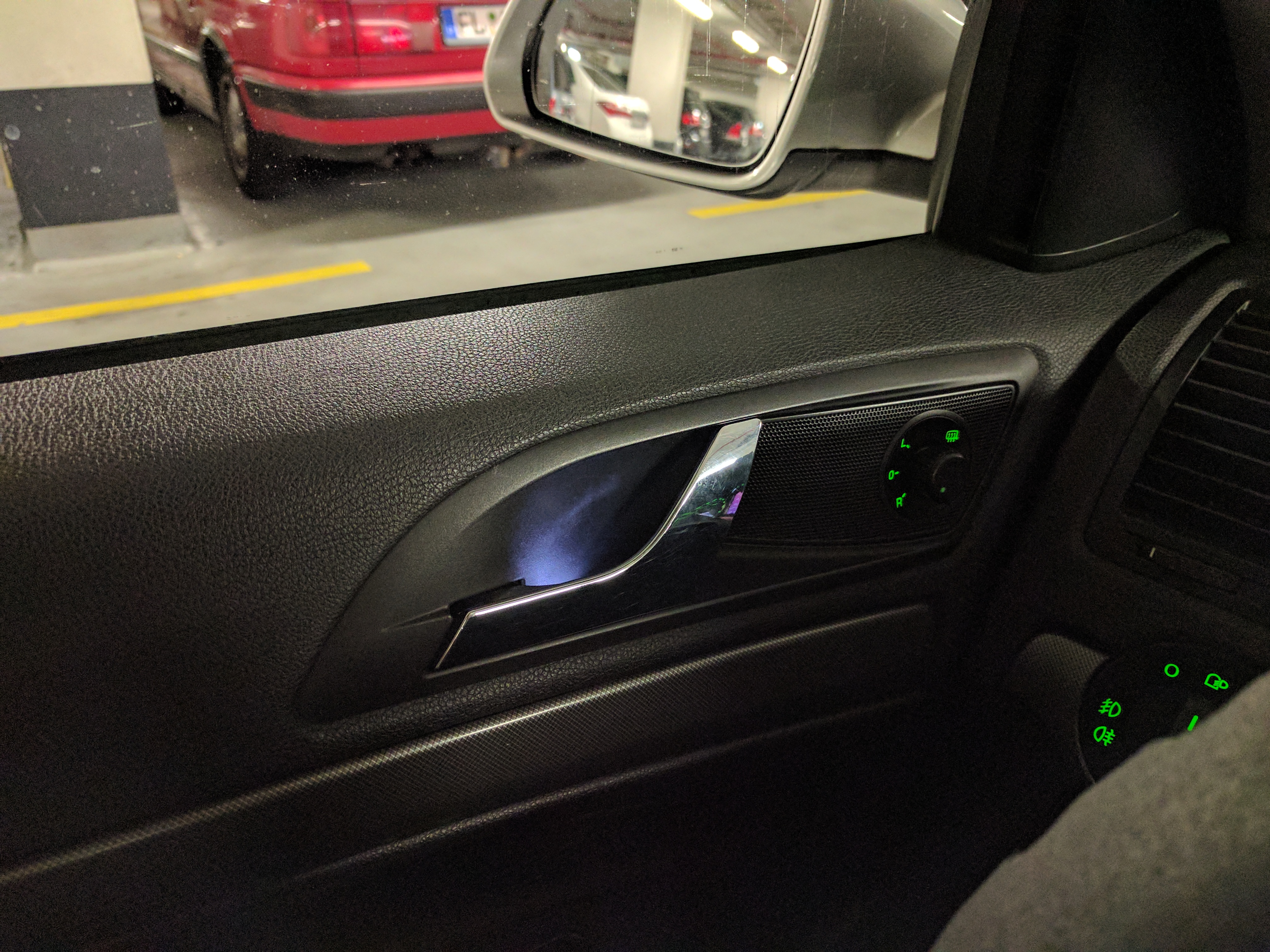

I have successfully installed mine a few weeks ago.
Thanks everyone for the explanation and pictures :)
The greatest challenges were:
- Flattening out the round holes the drilling machine leaves when punching through the hard plastic. It's tricky to both apply pressure and not scratch the inside of the handle.
- Removing the handles. I suggest you get someone with thin fingers who can squeeze in behind through the tweeter cover hole and push the clips off so you don't risk breaking them...
- Be careful with the wires coming out of the light assembly. They are not very well secured and then you will have a PITA connecting it back if it comes off. Make sure you don't fiddle with them too much.
Here's the final look and like everyone else said, the front ones are dimmer but I don't mind. That's what the L&K looks like too :D
