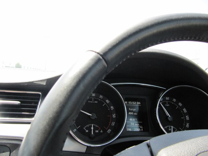

My aircon is working with flying colours in the blistering Indian Summer at 45 C. But I had to lower my cabin temperature to 22 from the 24 that I normally kept -

Oh man... 45°C is a lot. When is the best time to visit India for a Norwegian?
