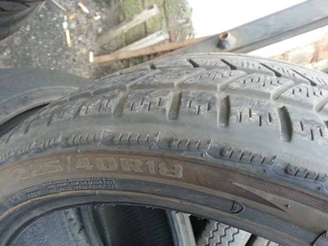

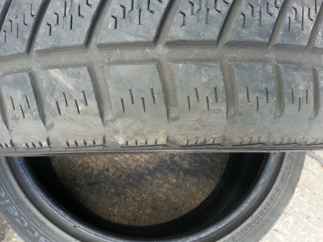

Hi,
I've got a persistent problem with tyre wear on the front wheels of my 58 plate Superb. I fitted some Avon Ice Touring a while back and after about 9 months got a pressure warning light on the dash... Close inspection of the tyres showed excessive wear in the inside edge of both fronts (almost down to the steel threading). I replaced them, had the suspension and tracking checked (both fine) and waited. On Saturday the left hand one did the same to the point where it nearly shredded and started deflating. (see attached pics). So what I'm trying to find out is if there's known issue with this sort of tyre wear on the Superb and what i can do to fix it. If I can at least give my garage something to look at specifically they may be able to identify the problem. Eating a pair of tyres every 9 months is getting annoying. ( Size are 225/40/R18).

I'm pretty certain that you must be running too much front camber, or wrong toe angle to get that.
I have never had a wear problem like that with my CR170 DSG.
You can sometimes find that toe in is all wrong on a brand new car, let alone one that is a few years old. Depending which way it is out it will cause edge wear on the inside or outside of a tyre. Low tyre pressures will cause wear on both outside edges. In both cases there is usually evidence of feathering on the tread as the tyre is being scuffed across the line of travel.
I was looking at your pictures for some time. Whilst I agree that wrong camber or wrong toe in are the most usual causes of wear on tyre edges, along with low tyre pressures, The wear doesn't look as I would expect it to for that. I'm no expert, but I would have expected the wear band to be wider and encompass the entire outer tread bar, not just the outer edge of it and to show more feathering on the edge.
It may well be camber, toe in, or low tyre pressures, but as it is a quite sharp angled and narrow band of wear on the insides of the front tyres, one thing I would check is that the tyres are not rubbing against the bodywork on full lock.
As Caspian says that does not look like conventional wear at all, the angles are too sharp on the worn patch and the patch is way too narrow. Something strange is going on there.
yes, I'm glad I'm not the only one who's a bit baffled. The garage couldn't find anything obvious either. I've put a budget tyre on now anyways in place of the Avon Ice Touring I had. I'll now just wait until the other Avon starts to 'go'... based on last time this should be in about 6 weeks. So odd because at the moment the tyre looks fine from what i can see in terms of wear. I will also ensure the tyre pressures are correct. If anyone has any comments on that I'd welcome it too.

That looks like something is rubbing on the tyre
Sent from my HTC One X using Tapatalk 2
Agreed. If it was alignment you'd expect the wear to run to the edge whereas your photos look more like a groove worn into the tread.
I had the same issue on my last set on the front, they were still 2-3 mm all across on tread but the inside edge on the off-side front had worn down to expose steel braiding and the tyre was losing pressure. I had done 32k on them over about 15 months so was not too upset but was surprised the side was worn without rubbing off the tread near the edge of the tyre!
Silly question but do you drive around many roundabouts daily, I had the same with my old Superb, I too had the front end checked which found nothing and all they could think was it was due to the heavy front end and roundabout driving especially with more decent tyres as they are a bit softer.
