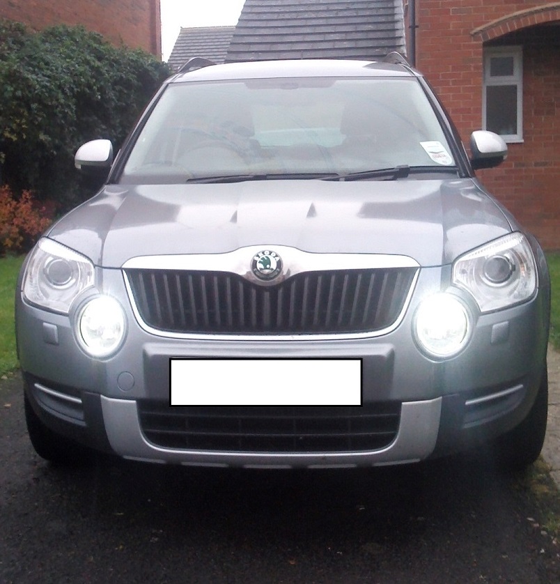

Just fitted a pair of these LED DRL bulbs on the Yeti and they work without external resistors and there is no 'bulb out' message.

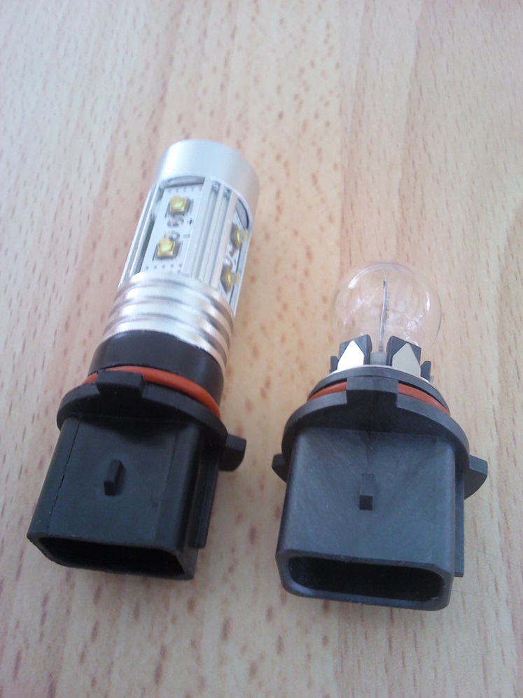

LED bulb longer than the original bulb but fits fine.

Nice to get rid of the yellow DRL's.
They look very bright in photo, in reality don't look so blinding, may be due to low quality camera phone.

Photos added to original post  :happy:
Longer bulb = light source further away from designed focal point = uncontrolled light scatter.
Not for me.
Not for me.
The DRLs aren't focussed as they come from the factory-they are deliberately diffused as a position light and don't produce any organised beam so I'm happy to try them.
I know they don't "produce a beam" but the reflector and lens are still constructed to make use of a specific focal length from the bulb, and putting something in beyond those design parameters could potentially lead to a problem with light scatter.
