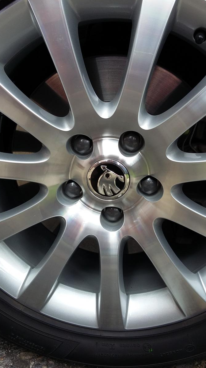

Update.
I spoke to my Skoda garage and the reply was basically hard luck, so I bought 4 plastic bolt caps/covers.
I then spoke to Skoda UK customer services. They confirmed that it is hard luck.
They also infomed they they were totally unaware of any issues regarding difficult to remove locking wheel bolts.
The lady made a note on the system and I advised her that somebody should look at the Skoda forums.
Colin
