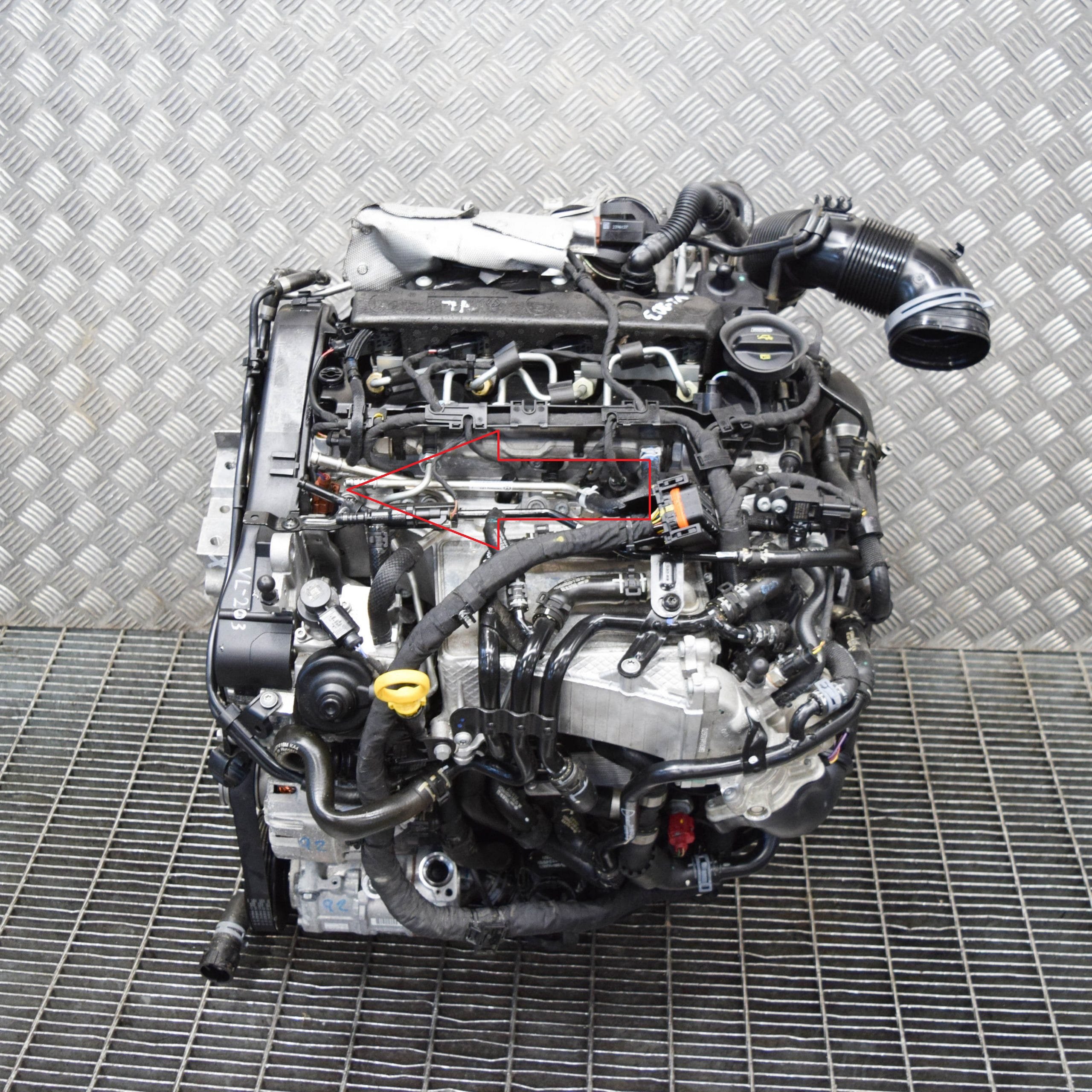

I'm sure these days a faulty glow plug will throw an EML because of the emissions implications of them not working pre and post starting, not 100% though. With it being a 1.6 I would have a total stab in the dark at one or more injectors being faulty although I advise getting a diagnosis rather than firing the parts cannon at it.

Opinions Required. 1.6TDI or 2.0TDI
SuperbTWM replied to SkodaCB's topic in Skoda Superb Mk III (2015 - 2023)
Based on threads on this forum the 1.6 is more likely to give you injector issues, the 1.6 may not have SCR though which could be a bonus, the SCR system can be very very expensive to repair.
