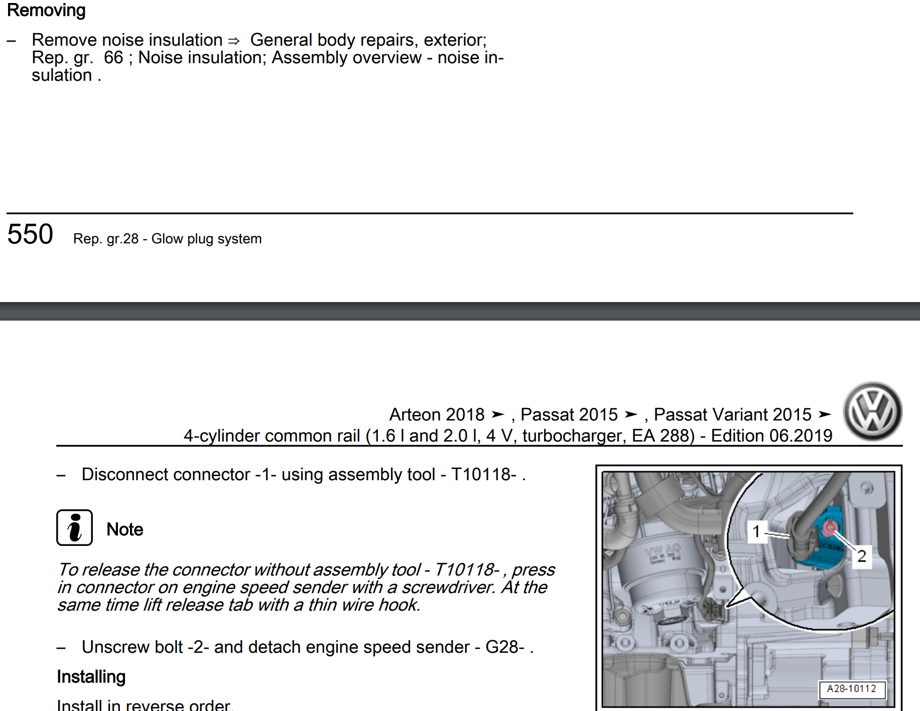

Crank sensor replacement
The workshop manuals only specify removal of necessary components, it might be a struggle but somebody used to working on cars would have it out a lot faster by feel than taking half the car apart. Have a go, you might surprise yourself Good luck!
The manual suggests access from underneath, removal of undertray is the only thing necessary for removal of the engine speed sensor. You will need a long 4mm ball ended Hex by the look of it as well.
