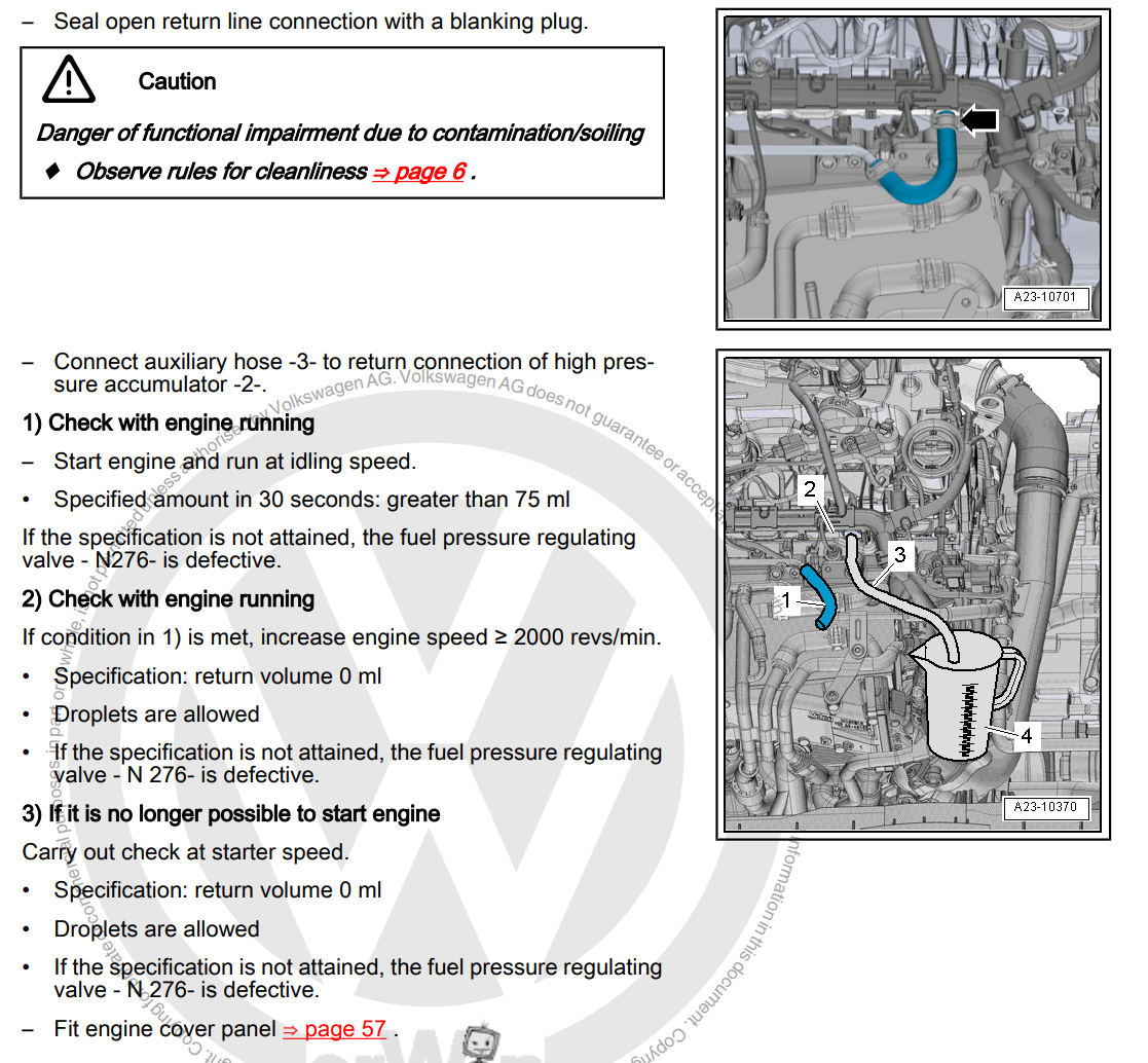

Can you fuel pressure regulator on right side
It says in the manual the fu el rail has to be removed to swap it out, even if the clearance is fine, torquing it up to 100NM would put strain on the fuel pipes and any brackets holding the fuel rail on. Here, you can diagnose it yourself now!!!!!!!!!!!!!!!!
