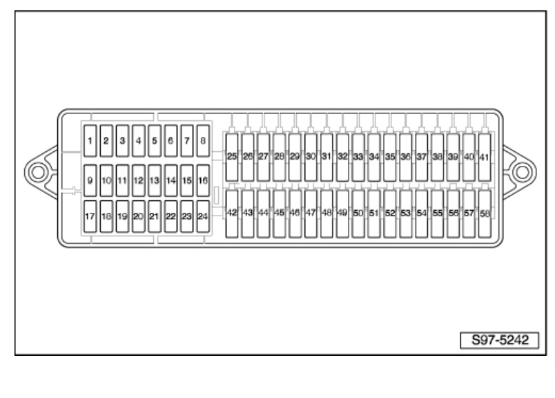

  4. Fuse 22 which is a 7.5amp powers the OBD port.
