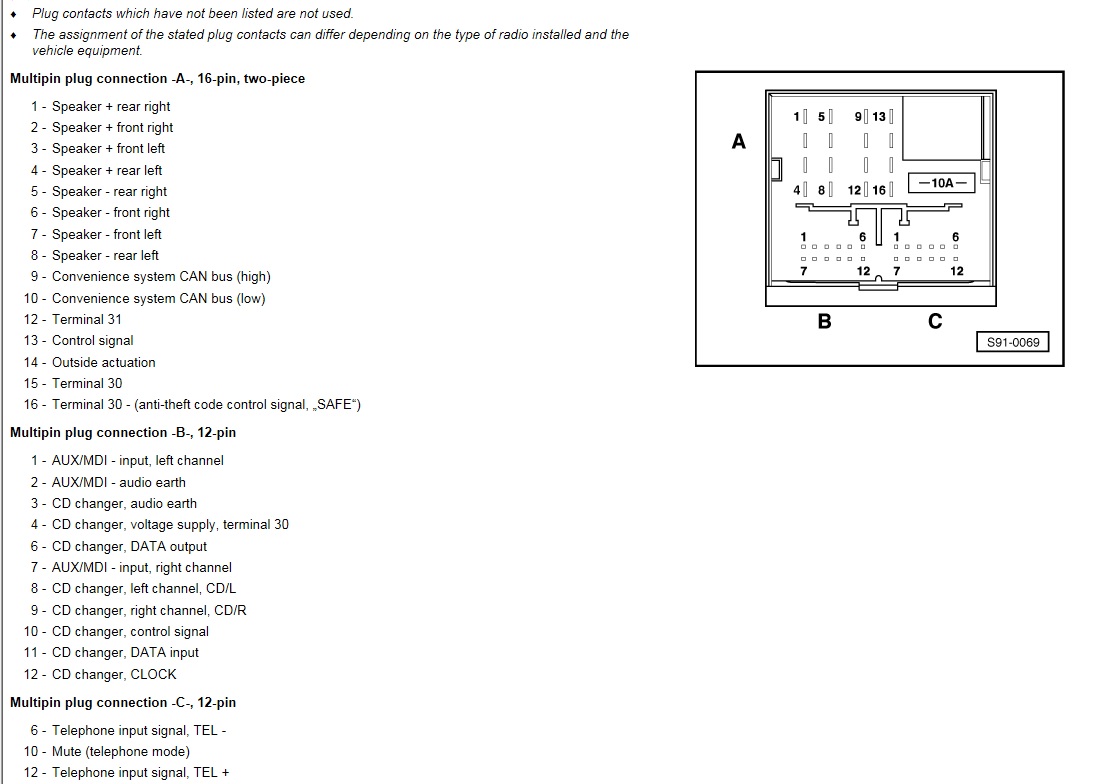

  9. here you go.......I think after 2010 the CD changer was replaced with the MDI unit.
