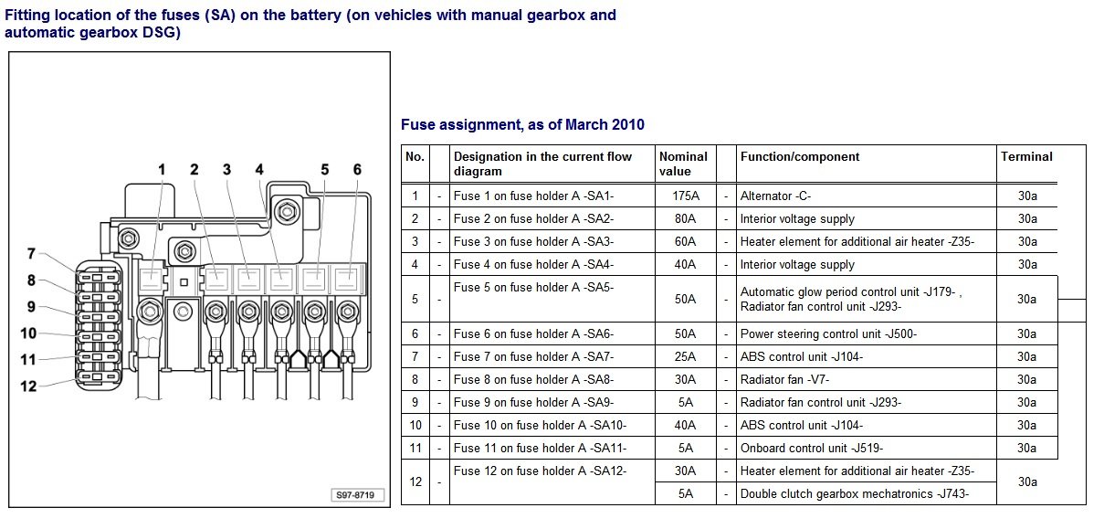

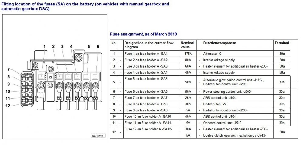

Power Steering defect
New electric steering pump / pack is my guess. Any lights on the dash ? Check fuse 16 in the interior fusebox (by drivers knee) Also check engine bay fuses, these are the big ones ontop of the battery, fuse 6 is for the steering pump / control unit, these can develop small cracks and break the current flow to the steering unit. You cannot replace them individually, it comes as a single part, but you can check visually and ideally with a meter that there is voltage either side of the fuse.
