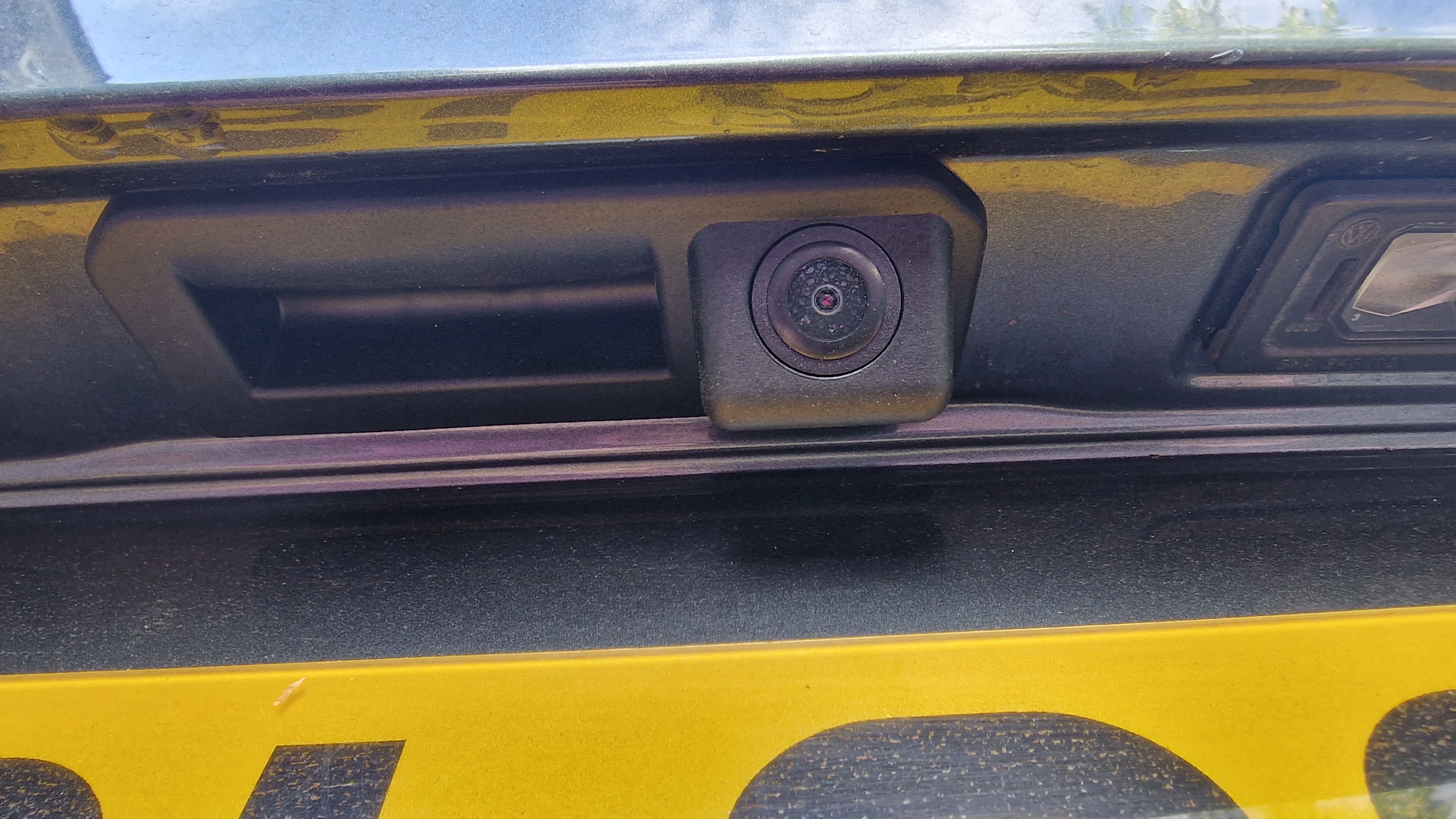

Their big boss picked this up the other day and after he visited the dealer and speaking to the staff, he's apologised. In short he wasn't aware that one / some of his staff had lied to him about what and how the deal had been agreed and we've come to an agreement. I've missed some of the back n forth out but he had said he'd refer it to their legal team until finding out the truth. The short answer is i get to keep this camera and get some refund of money. Also the boss has offered to look after me if ever I'm in need of anything. The member of staff also resigned yesterday and apparently had a list of unhappy other customers. My V5 has also been processed without issue now someone else has been asked to deal with it. For info, I had been emailing and phoning, both with pretty much no responses until they escalated to their manager. Now got to decide if I can be bothered with the pain of finding someone else to put the oem camera in and mess with whatever has been fitted already.

Getting the parts aren't a problem it seems and I'm fairly sure I have confirmed only high is used on the kodiaq too. There are some skoda dealers advertising this high part and that it needs coding / calibration etc. And a few other sellers that can provide the oem correct part. At the moment I'm waiting on the dealer advising what they will or won't do to rectify the issue. I've had to chase daily for a week so far and am being mostly ignored. Today I've also found out that they have not actually registered the v5 to me either. Sigh, losing faith in this dealer a little.

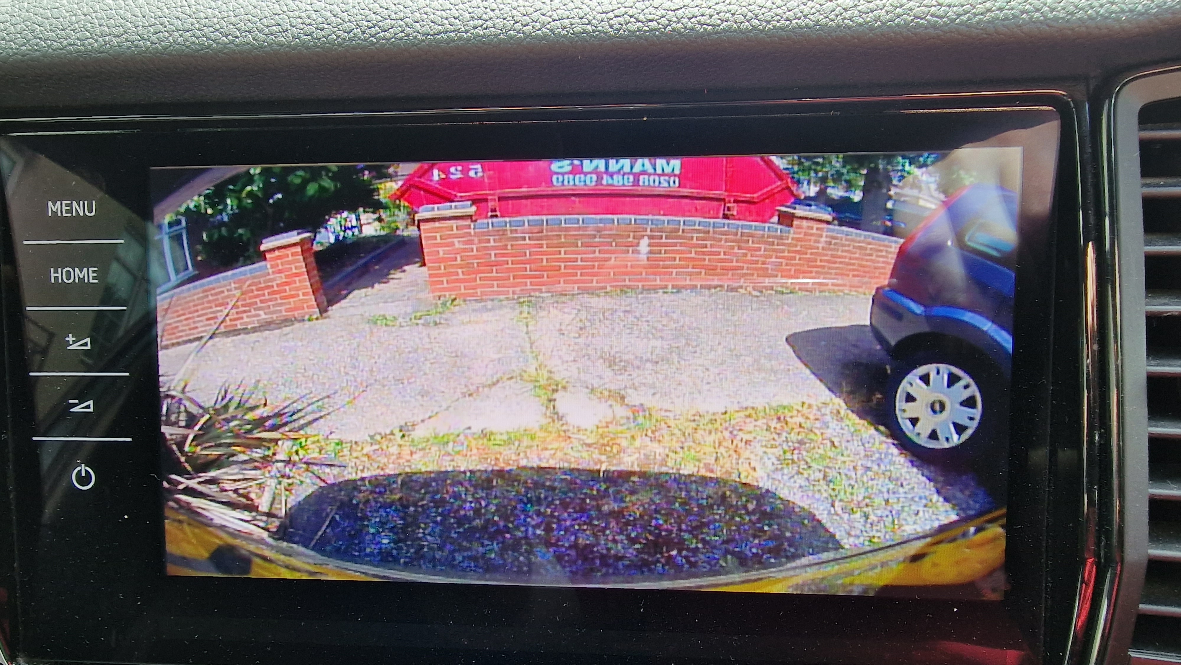

Yes I have rear sensors and pdc, but this is no longer visible on the screen so you are relying just on the sounds, distance is hard to judge from just the video Yep seen lots of options for supposed oem fitting, but this was what this was meant to be from the skoda dealer lol. It was implied to me as if the dealer would supply the parts and this was just a fitting company. Anyway, I want full oem camera and display, else I could get this basic picture for peanuts from elsewhere.

Well the installer that the dealer used has confirmed 3rd party parts were used and even confirmed it was a system listed for mib2 cars. I agreed with the dealer that I wanted oem / factory fitted parts as if it was on the car from the factory, obviously this is far from it at the moment so now waiting to see what they say next. To be honest, I'm a little surprised and disappointed that they even farm this work out to an installer that uses non genuine parts let alone doesn't even seem to know the differences in the cars platforms etc. Either way, at the moment I consider that picture worse than the pdc lines that at least give you a better indication of distance and which side of the bumper any obstruction is etc. Apparently cost the dealer £600 ish for this too and it looks no better than a 50 quid ali express generic camera. The picture is grainy with occasional interference also, probably better with a cheap wireless camera lol (all just guessing)

Thanks for that Would I be right in saying the kodiaq should only have the highline version? (This seems to be suggested from my looking into the issue) Either way, I am presuming that the lines should be there along with the view options as per all other kodiaqs?

Hi all As part of the deal of buying a 2021 kodiaq recently, the dealer agreed to retrofit a reverse camera of which has now been done and I believe is missing coding / calibration and maybe wrong part used. Can anyone that has had a camera retrofitted to an MIB3 kodiaq share a picture of their display please and confirm if they also have the washer jet on their camera? For info, this is all I have on my display and the camera seems to be missing the washer nozzle
