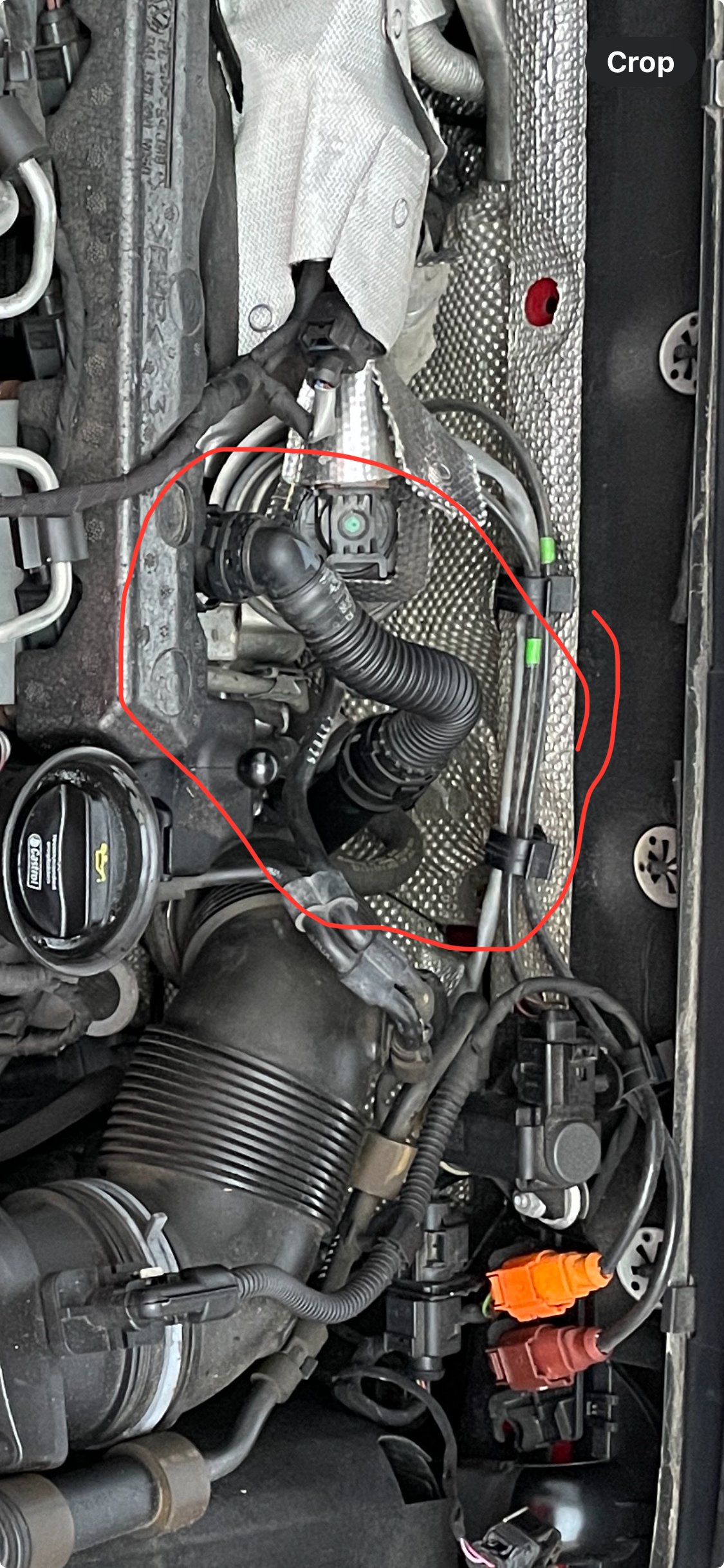

  4. Below your hand is the pcv pipe. It vents oil and air from the crank case. Hard to tell from your photo but maybe looks like it has been disconnected? That would lead to oil vapour in that area

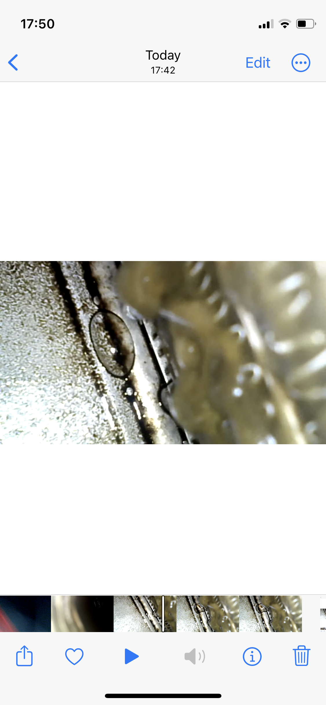

  12. Yes, it could be hydro locking the engine. The temperature sensor on the charge cooler can be removed and a endoscope stuck in to check for leaks. If leaking will look like the attached
  13. Yes, the charge cooler sits atop the engine and when it leaks it can leak down into the cylinders over time causing hydrolock. These charge coolers are known to leak unfortunately. not sure why the radiator would have been changed though before. There’s also a bit of a funny start up on these engines, something to do with the vvt solenoid and it sometimes takes a bit longer to turn over. Was your starter motor actually faulty at all?
