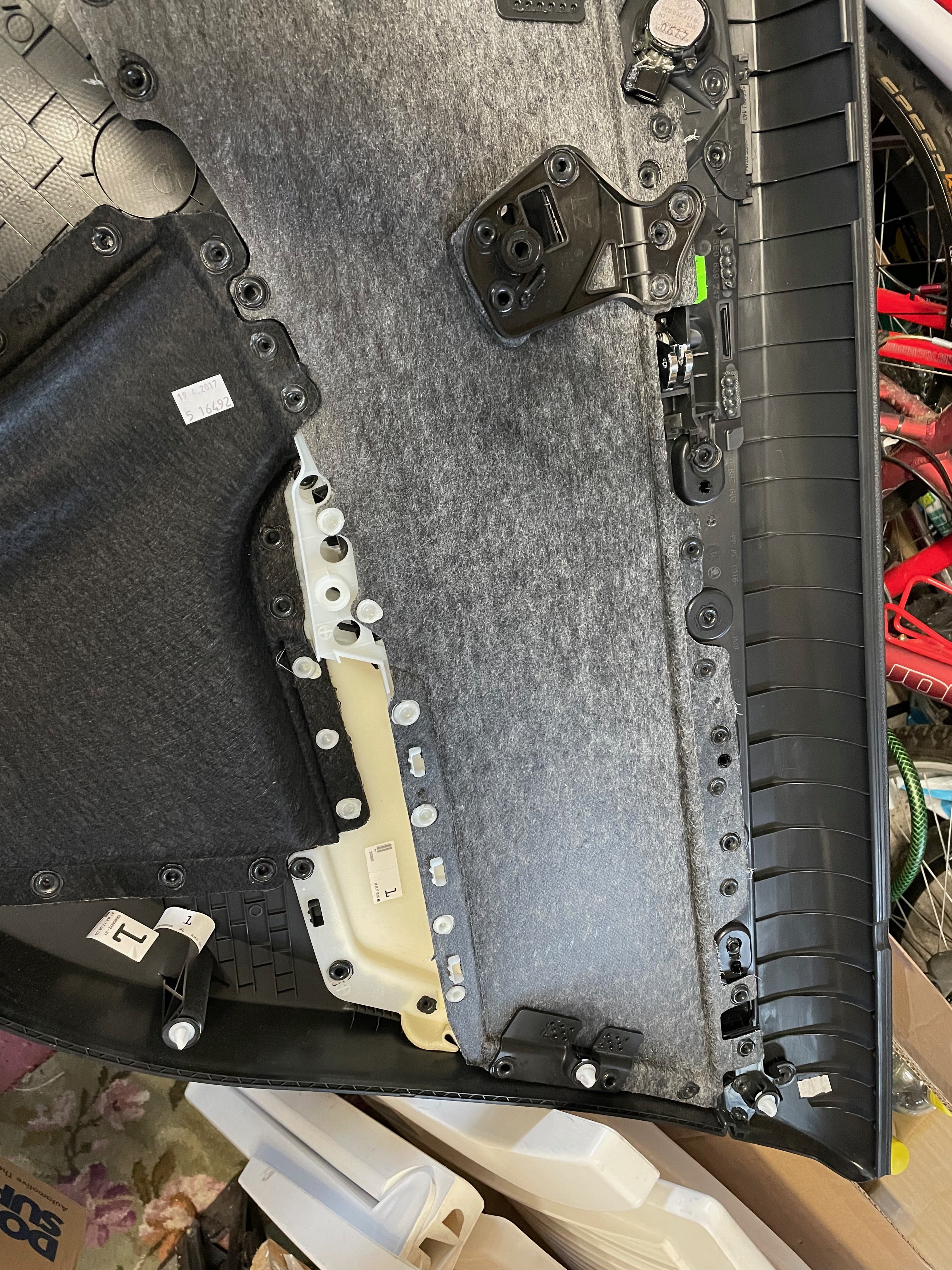

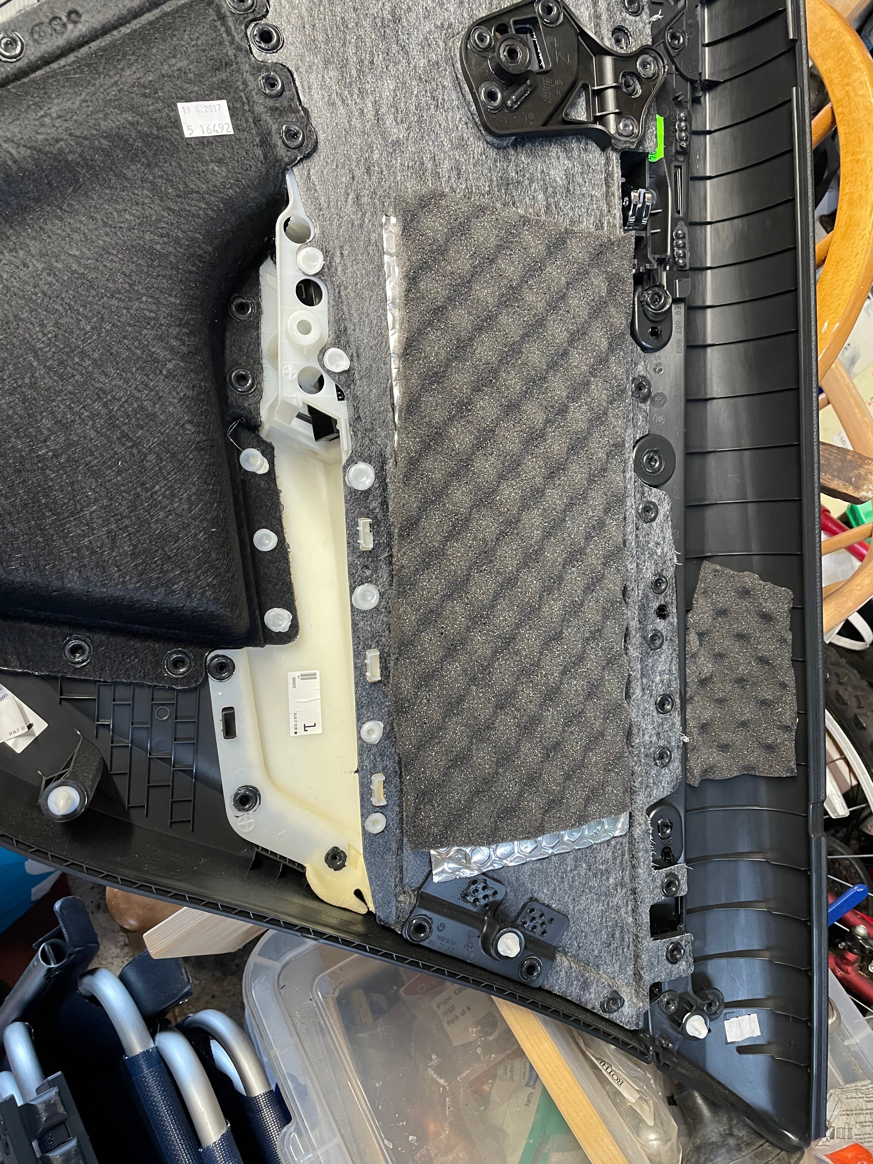

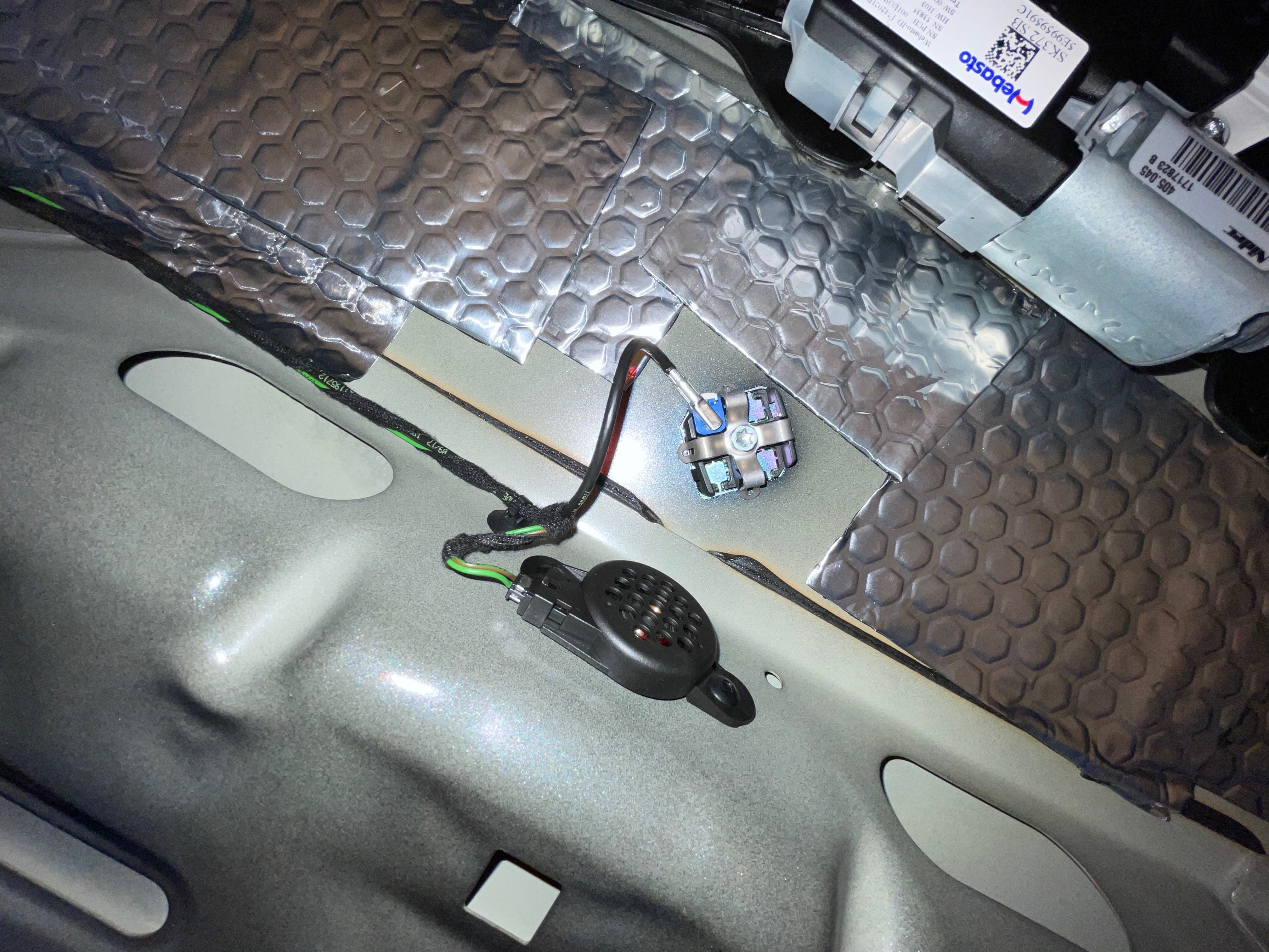

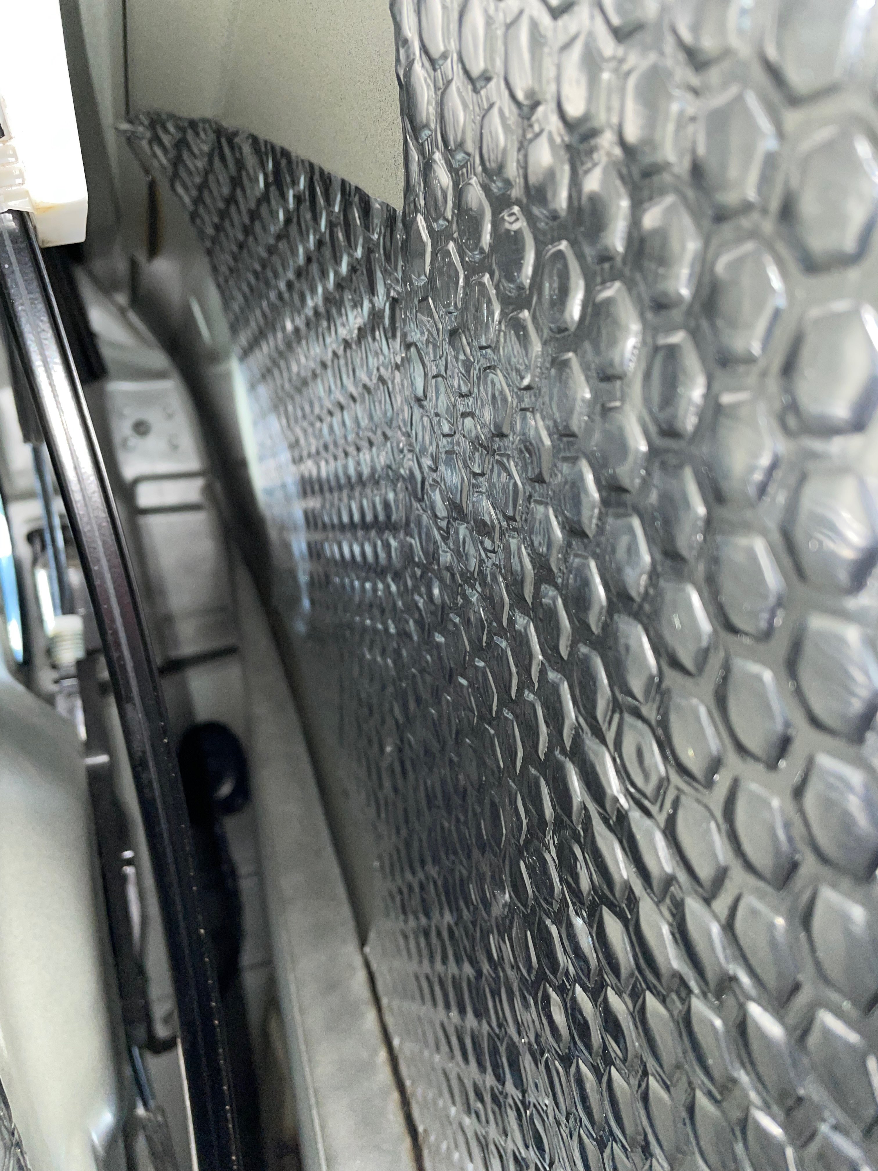

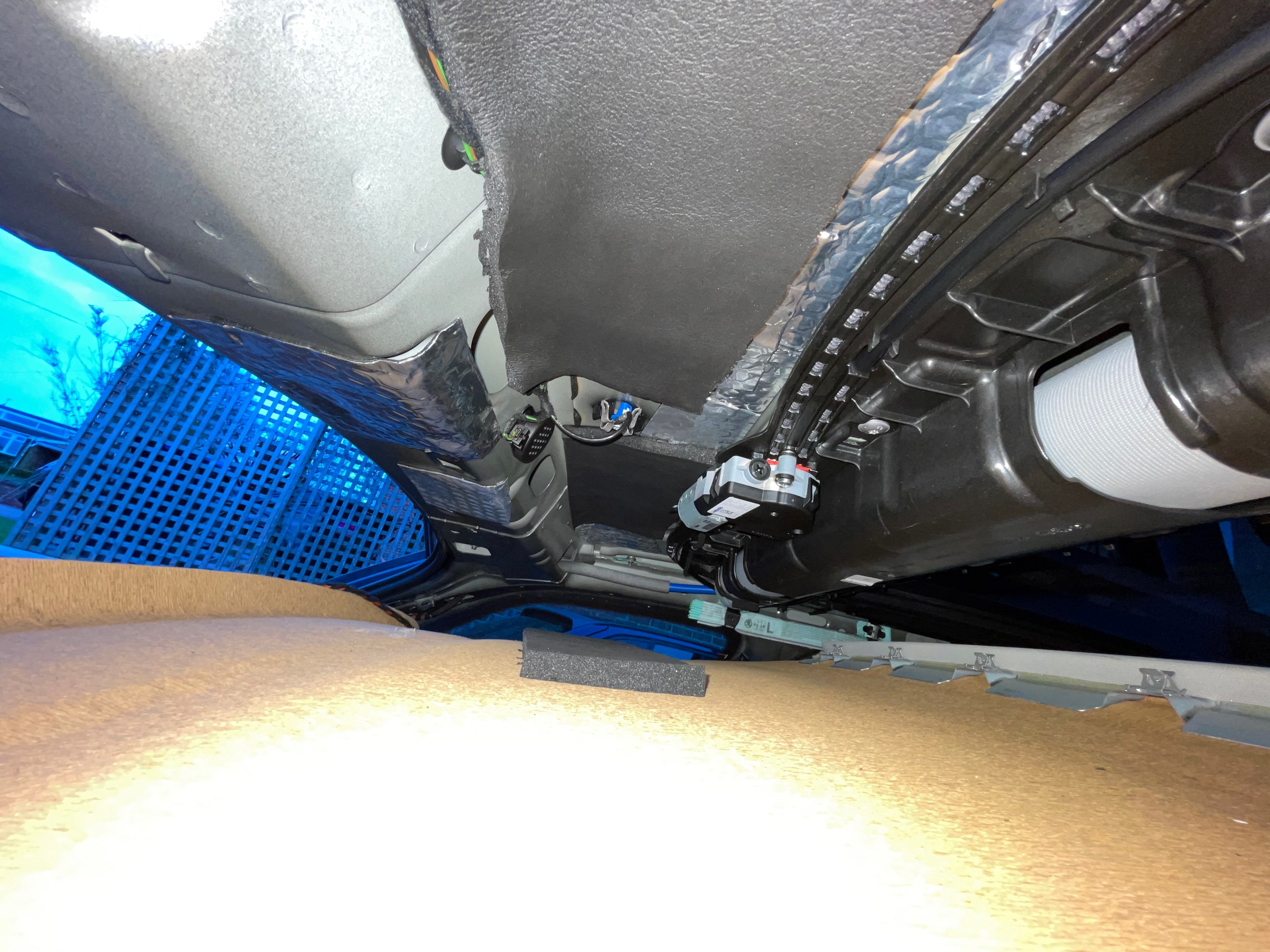

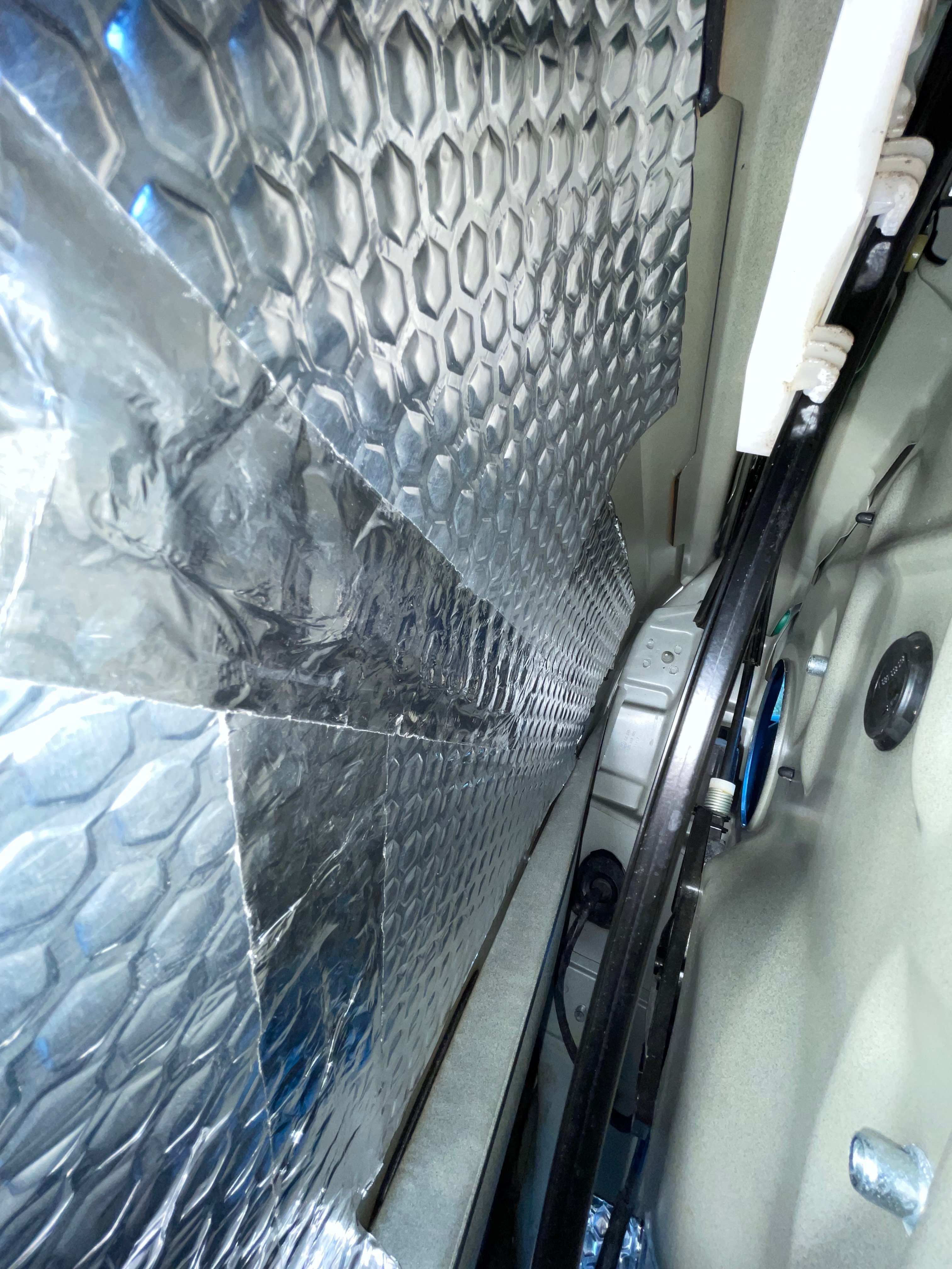

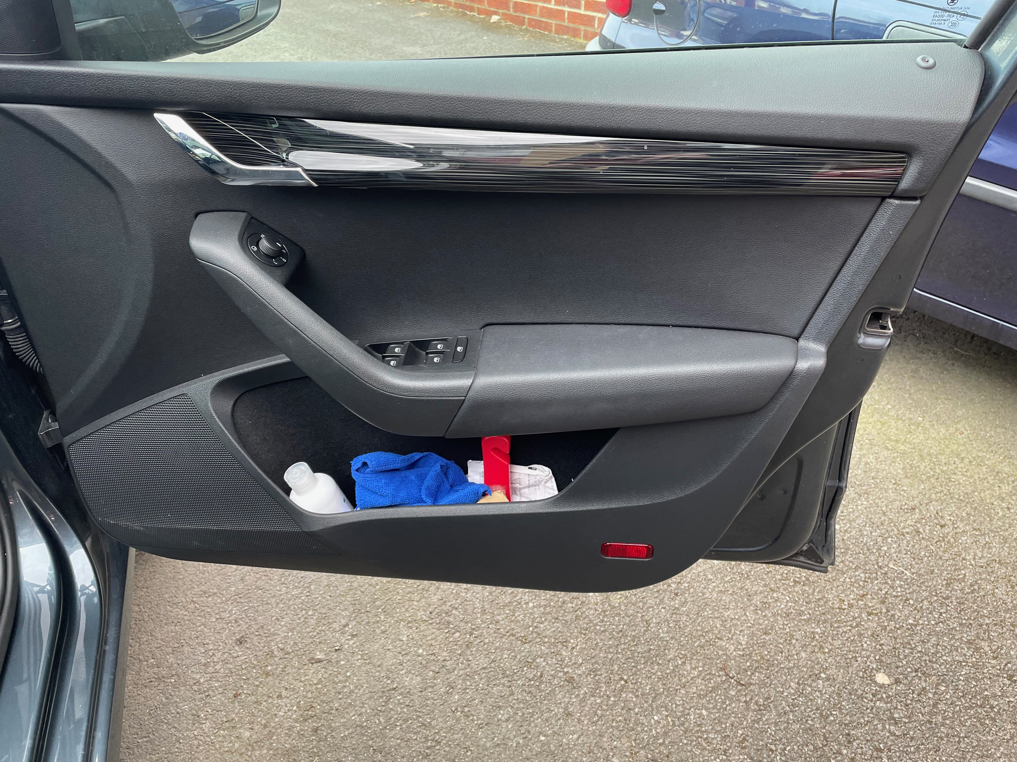

Got on with another project in the past few weeks, now the lighter nights have been happening, but also the weather has been a bit warmer. Started sound deadening the doors. Massive improvement so far, still have the boot to do, and the rear panels. Before I started, I also got another kit from Rocket Wires so that I could replace the red reflector with an Led/Halogen (halogen for now) Had the old halogen ones from my yeti in a draw at home. Also he combined a loom for the front door bin illumination which I had to drill the hole for that, but they work fine and run off the same circuit that the panel and button illumination run off. Think the above is a rear door, But a bit of a before image.... and now the after.. . Dodo mat 2mm I think mat on, then I put the egg cup design on top to absorb the sound. Also still clears the window mechanism. Did the Door card as well, Similar process as they're quite a flat plastic panel. Before: After: I also Lowered the roof liner around the panoramic sunroof. as the panel at the rear has no sound deadening on it. All back together and so far a lot quieter, When I get some time I will probably take the seats out and try to get some under the seats, on the floor pan. Oh and the working Door open Warning light...

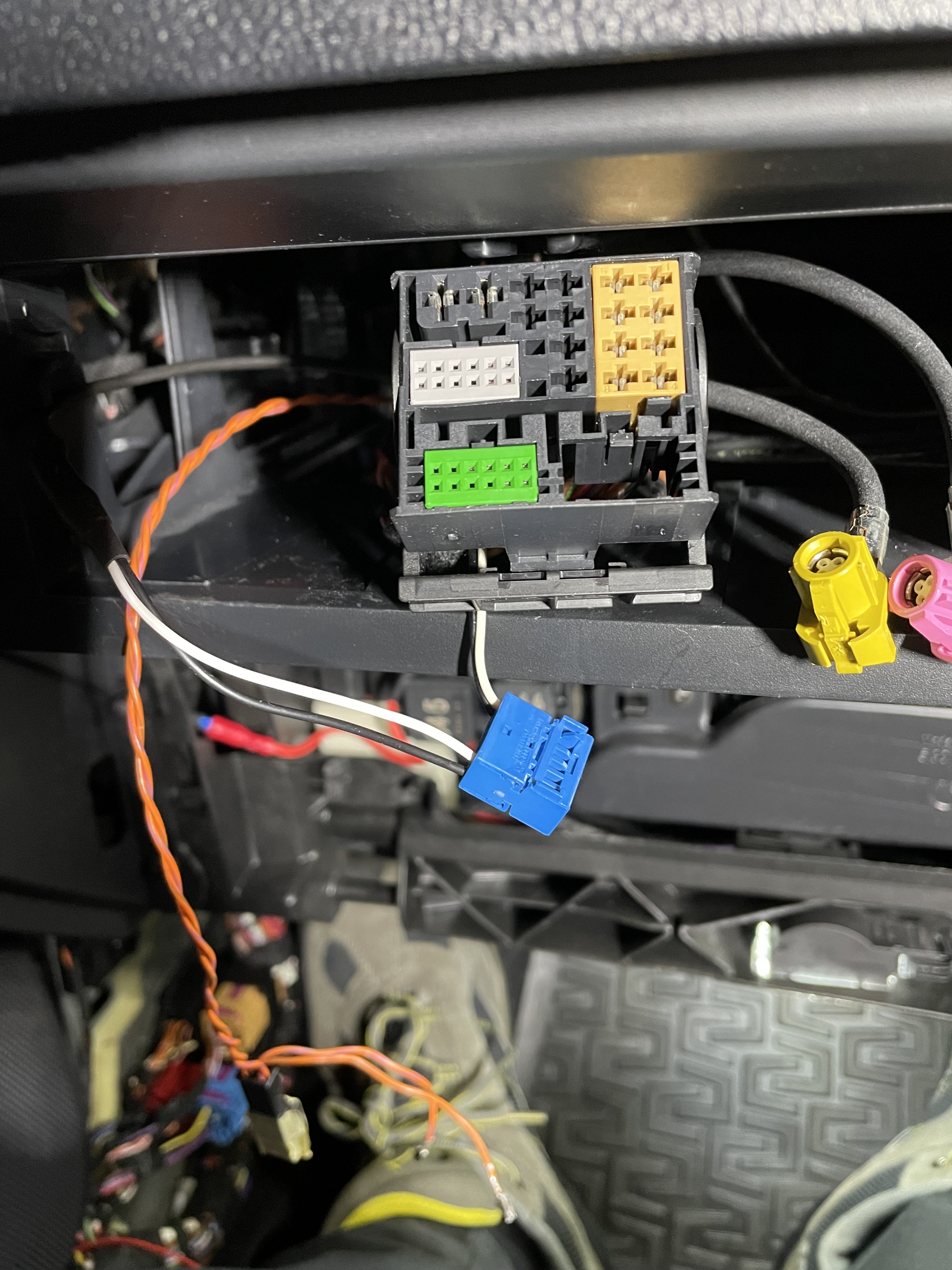

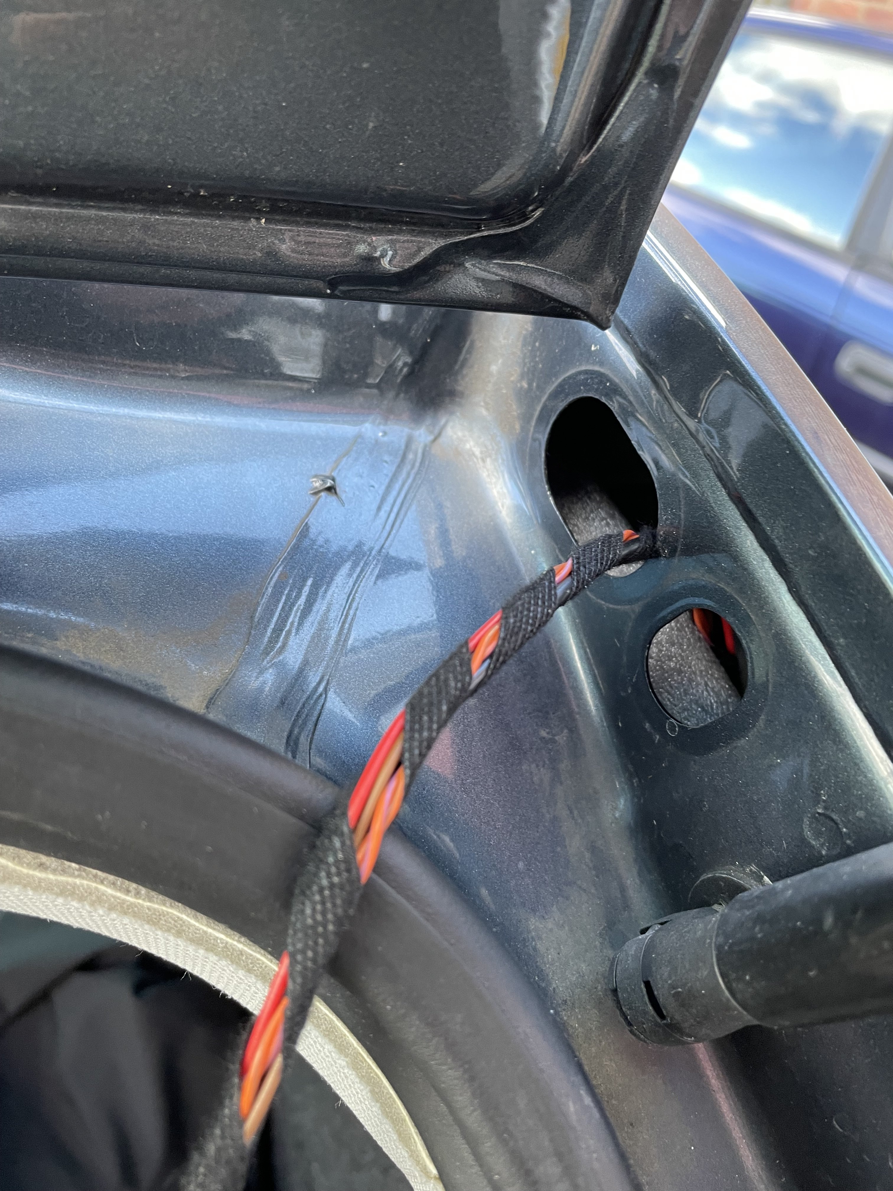

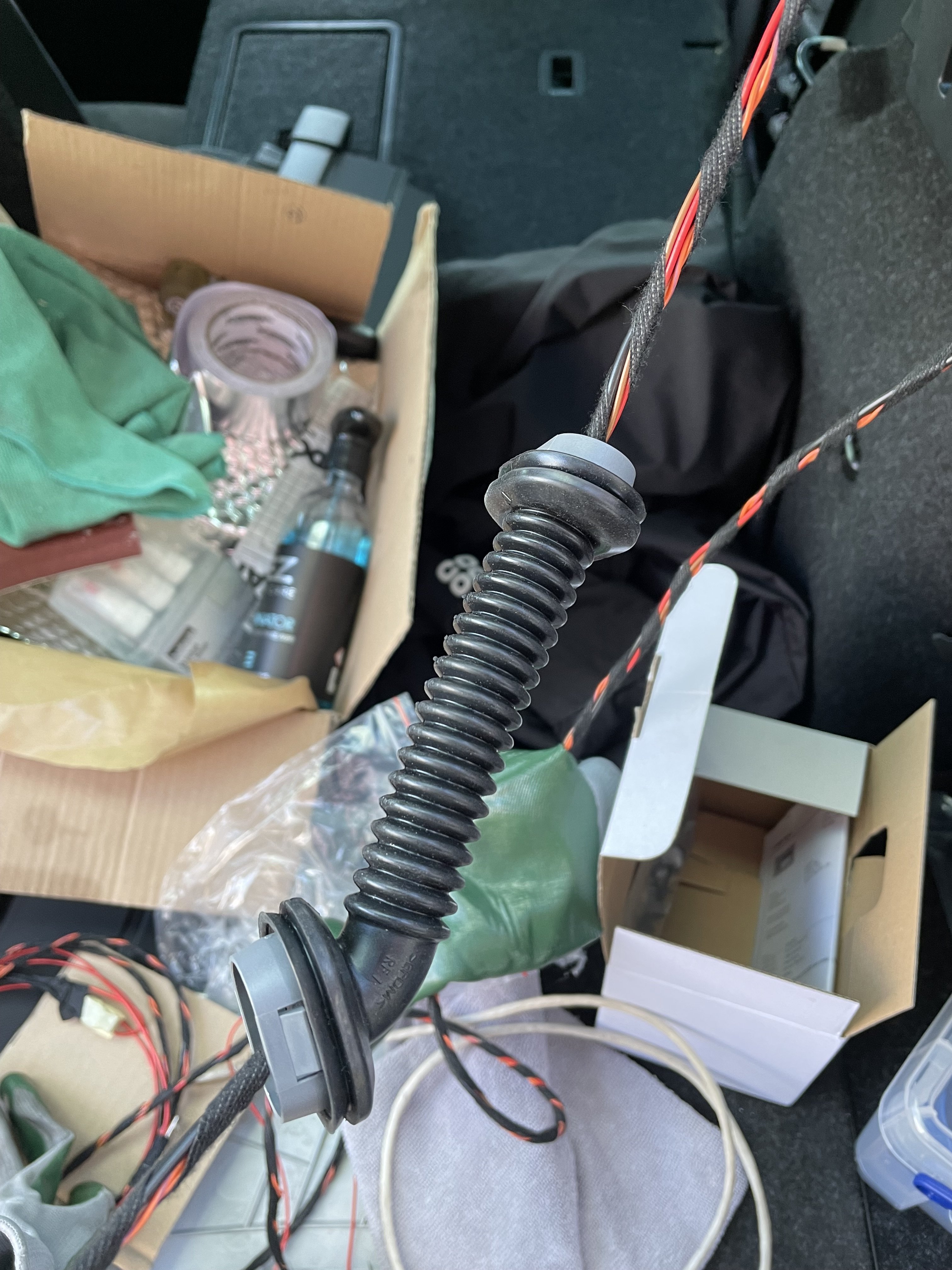

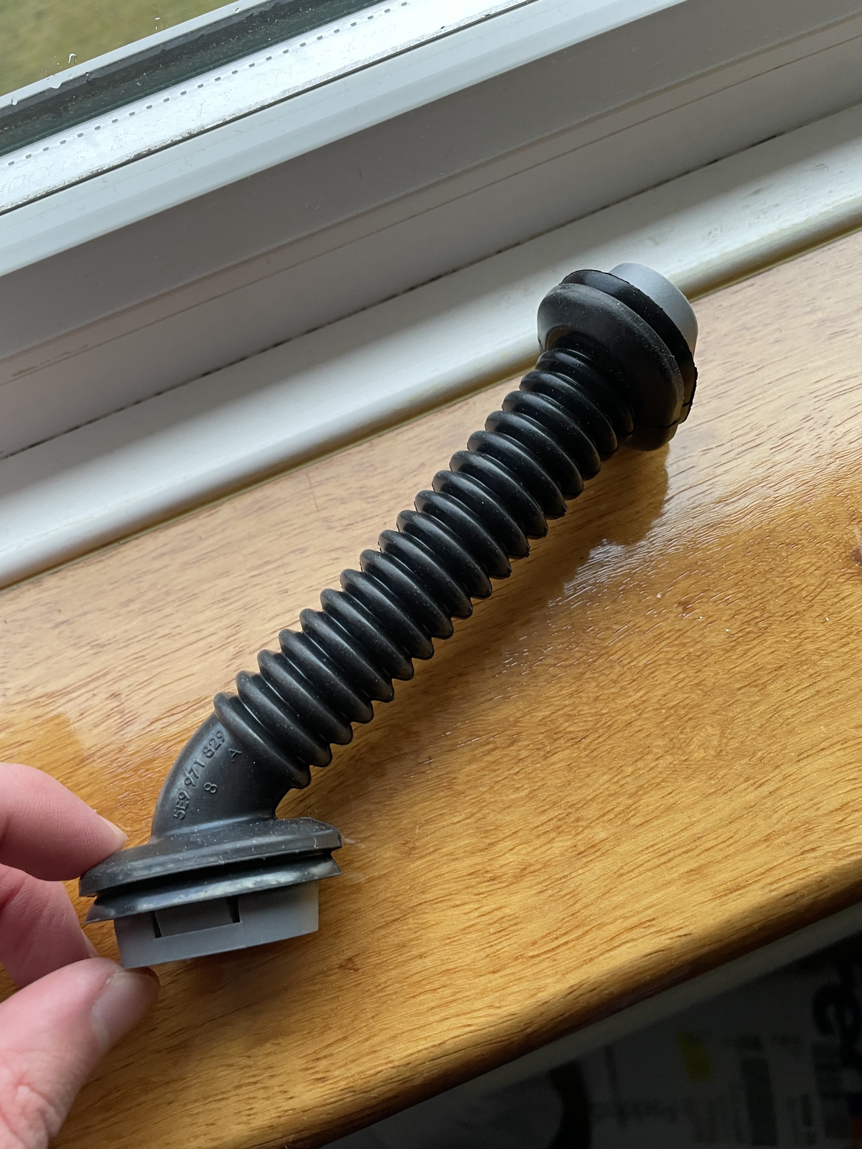

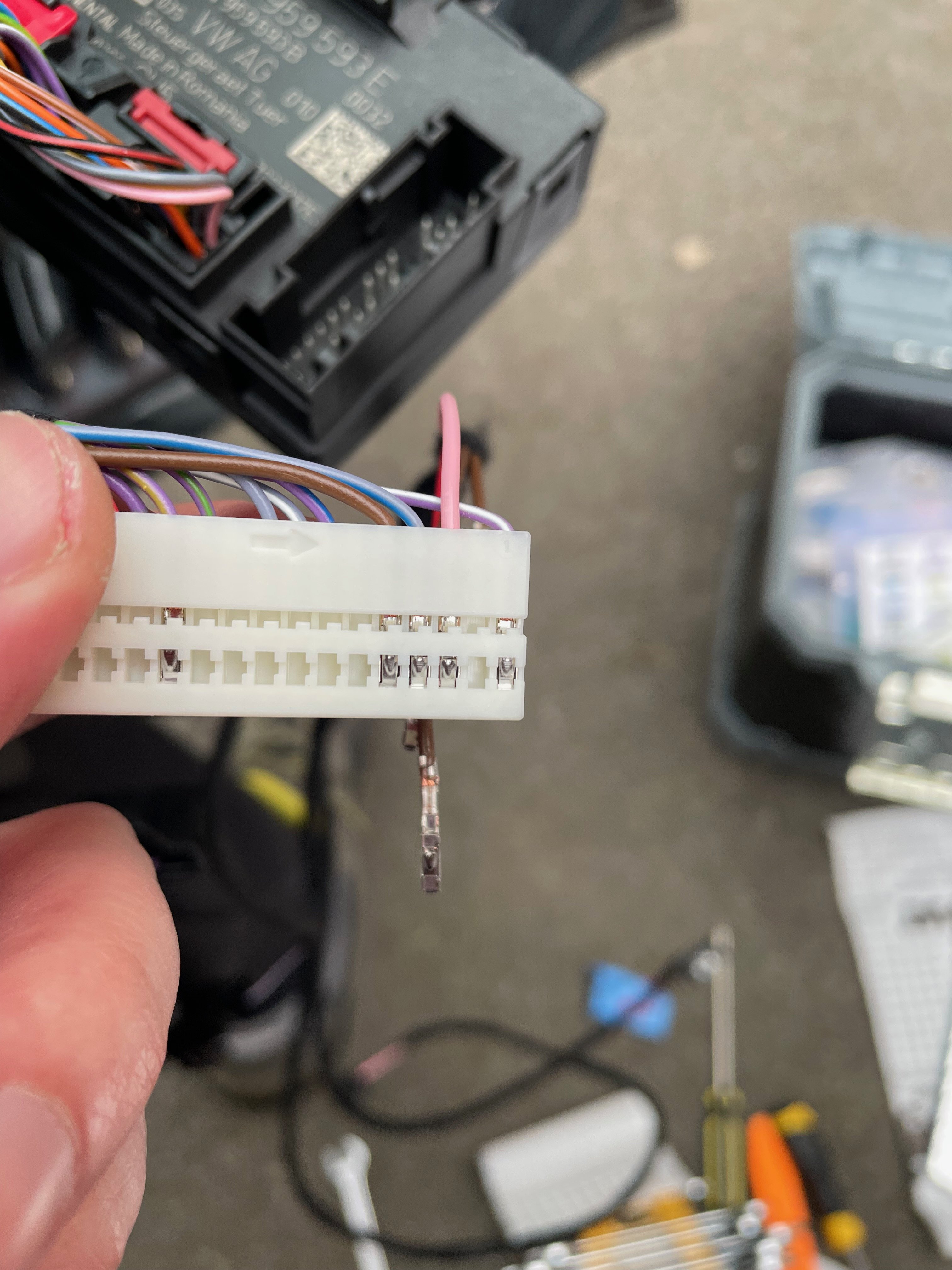

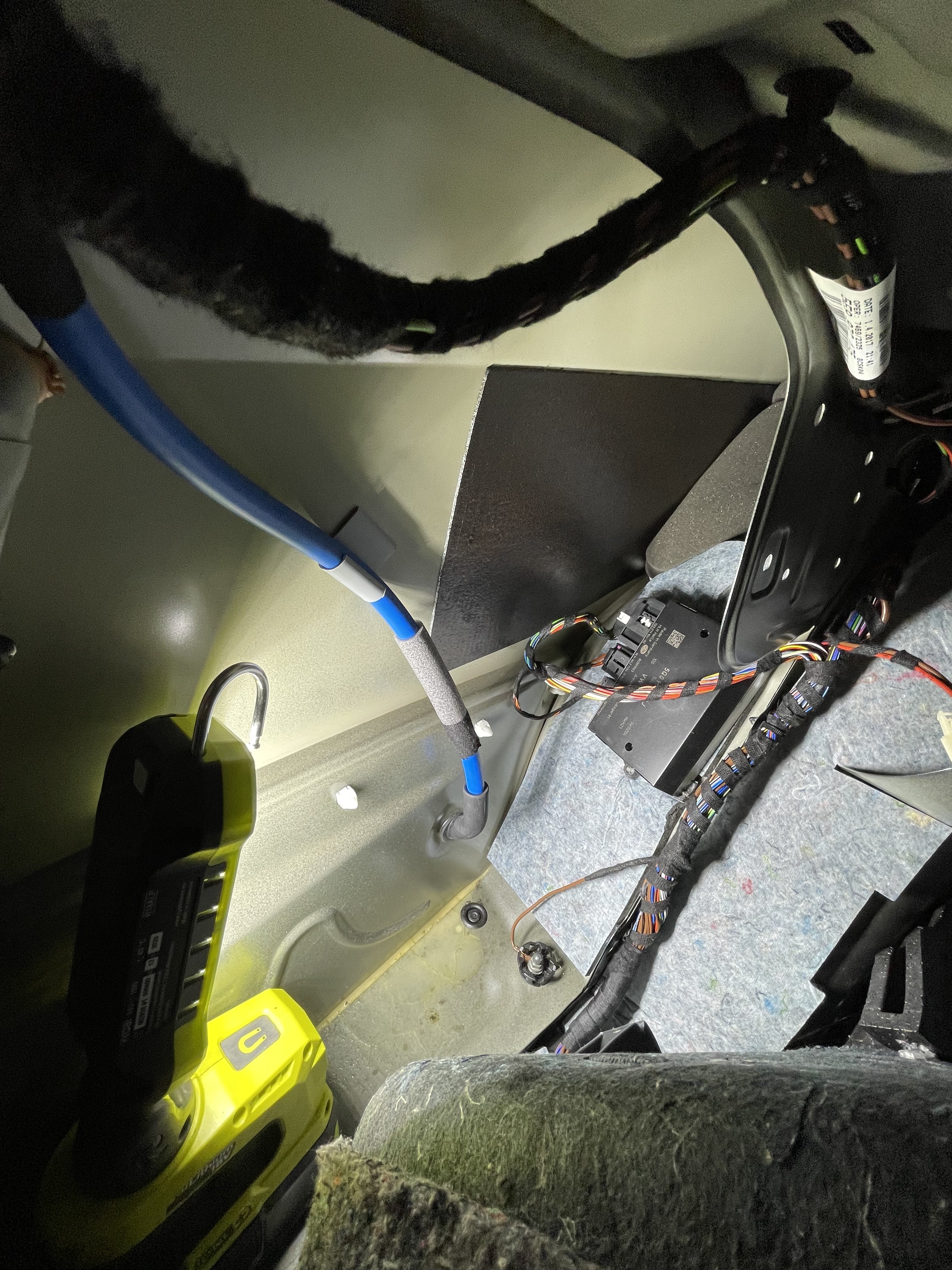

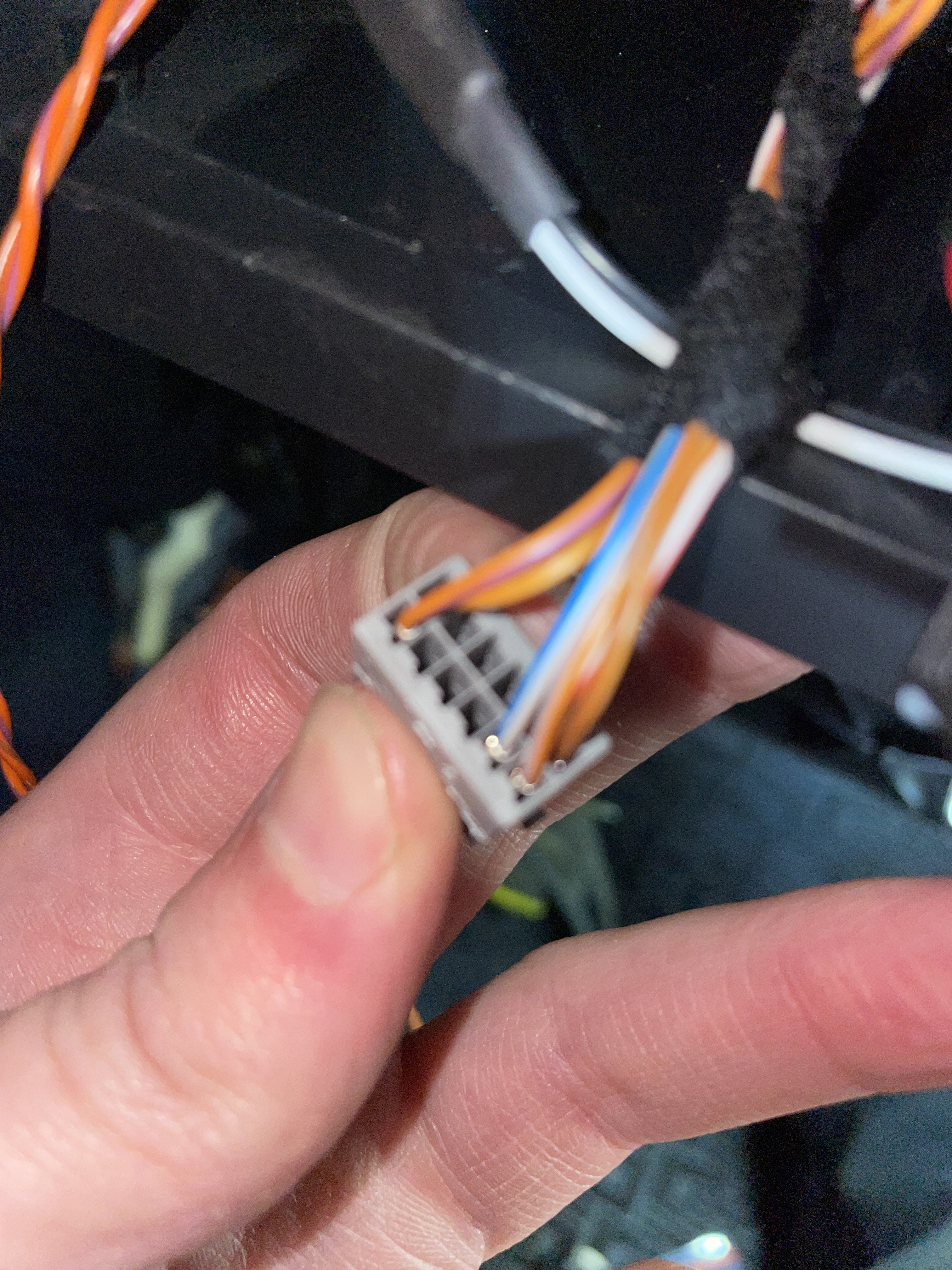

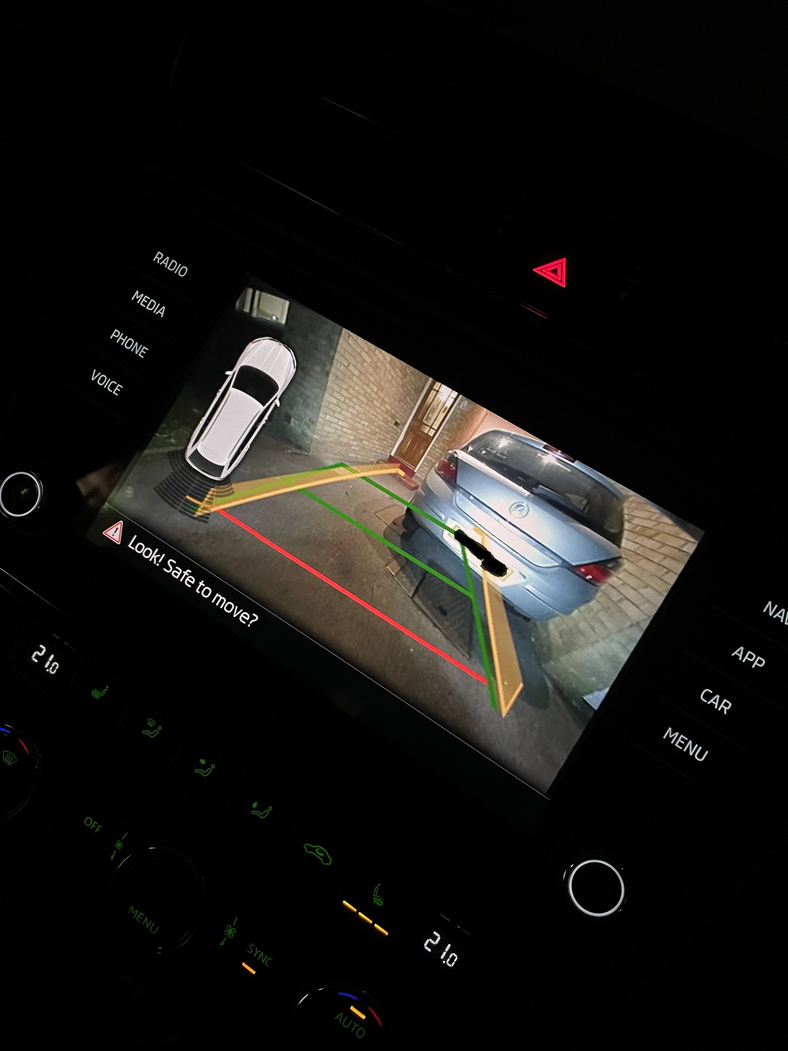

Next OEM+ mod.... Reversing Camera. Bought new From VWModul Pretty much next day delvery from Germany. Set about installing it, the other evening, first hurdle was trying to get the looms through the existing belows between the boot lid and the body. Bit of Cat5E cable to try and fish the cables through, However that was a struggle, so after a bit of investigation i noticed a similiar route on the other side. Bought another bellow from skoda parts (Part Number 5E9 971 829 A) So packed away then started again today. Pulled the liner out of the side of the boot to aid in routing the cable to the front. Later project will be to sound deaden the rear as its very tiny! Cable all Secure! Routed along the sill. Video signal Wired in then had to swap the Canbus cables out to another plug which came with the kit and put the new cables in there place, this was all explained in the guide provided with the camera, as well as the coding changes. All Complete and back together and it works!

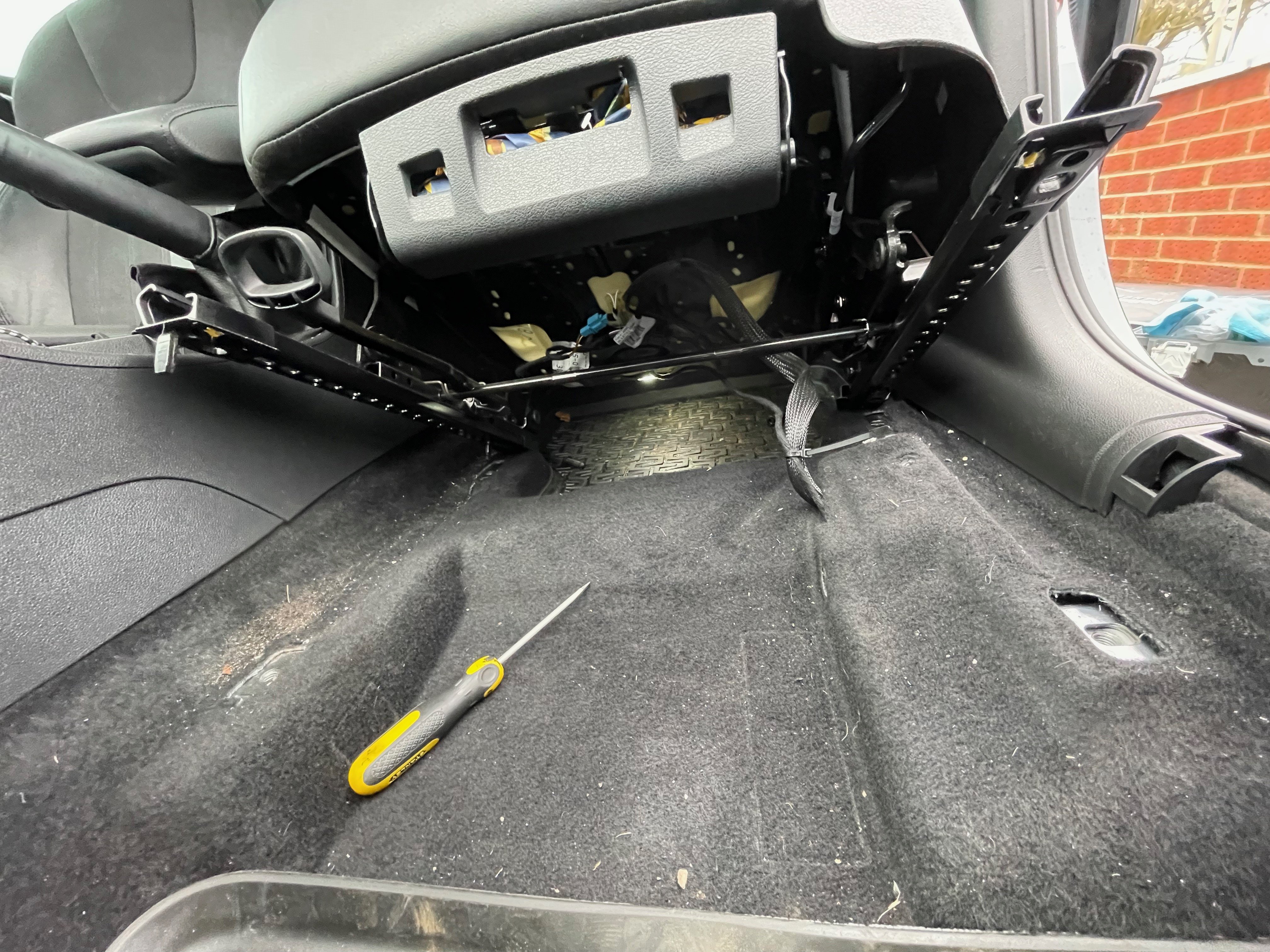

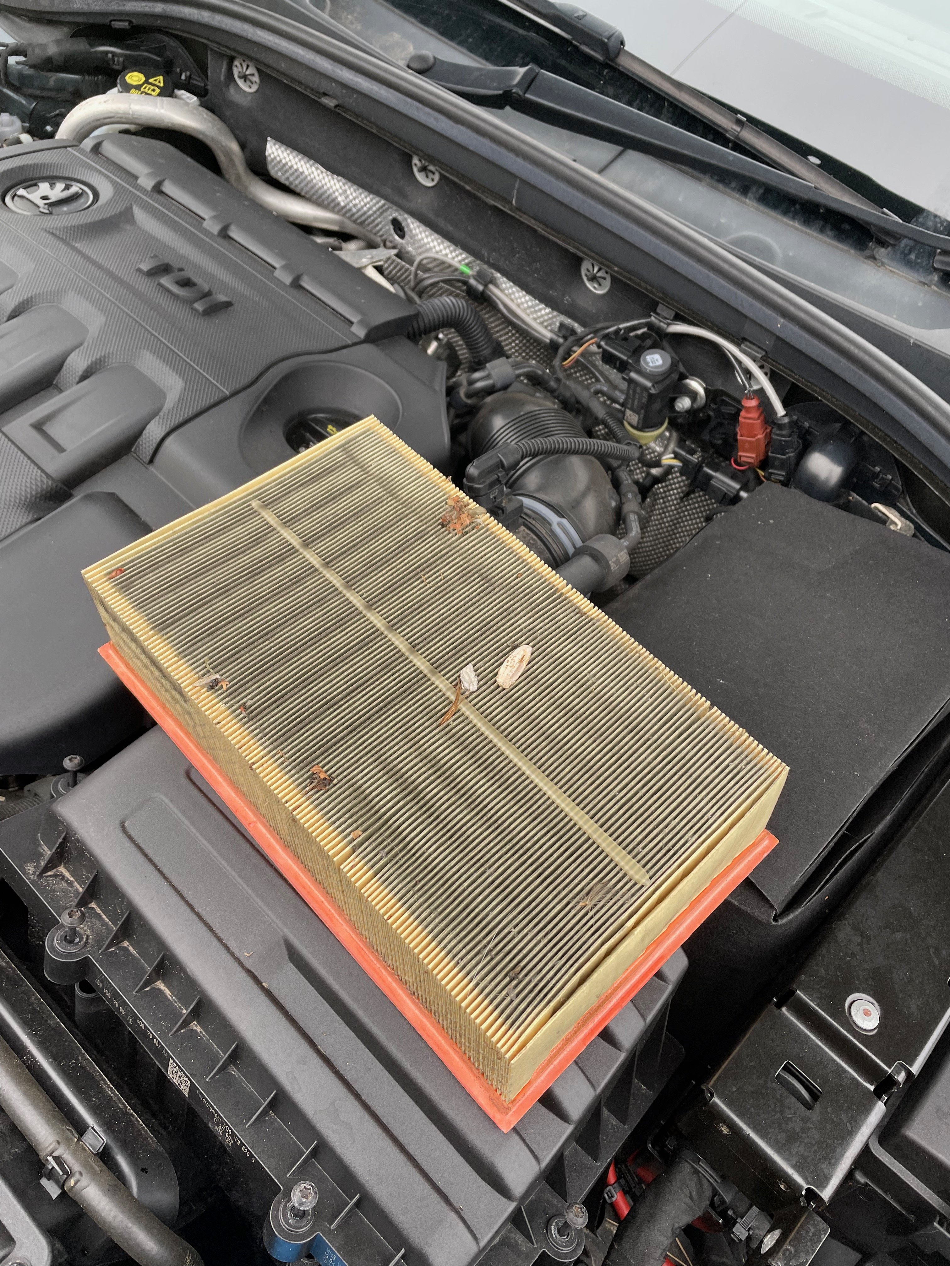

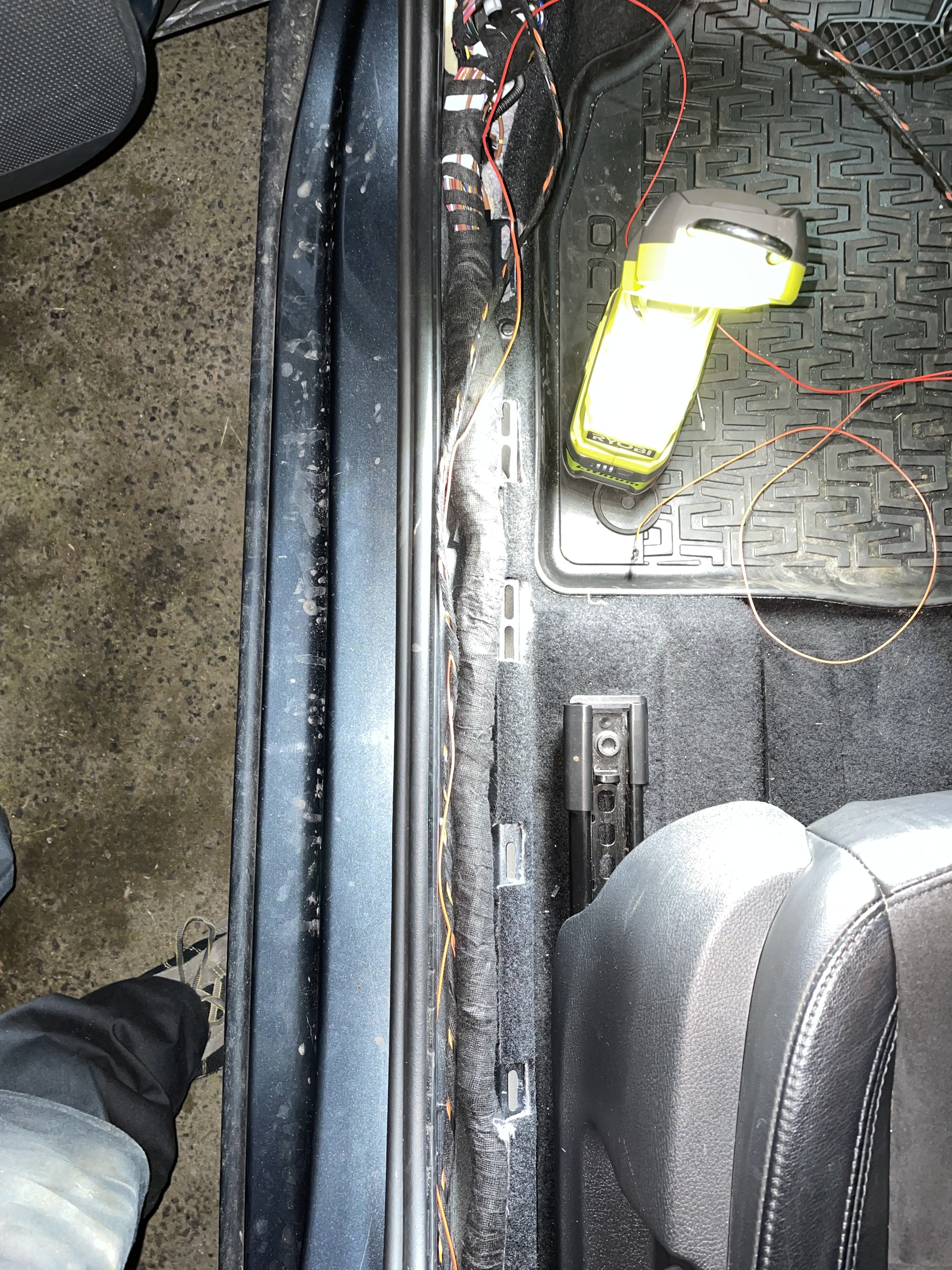

Finished off the footwell lighting. Found it easier to remove bolts for the front seats to nicely route the cable through! Loosely tied up with cable ties, this is just so I can make sure the cable Is routed properly, then I tightened them when I was happy. Whilst the chair was in the position I gave it a good vacuum. Then wanted to check the air filter that was supposedly changed when I bought it about a month ago....
